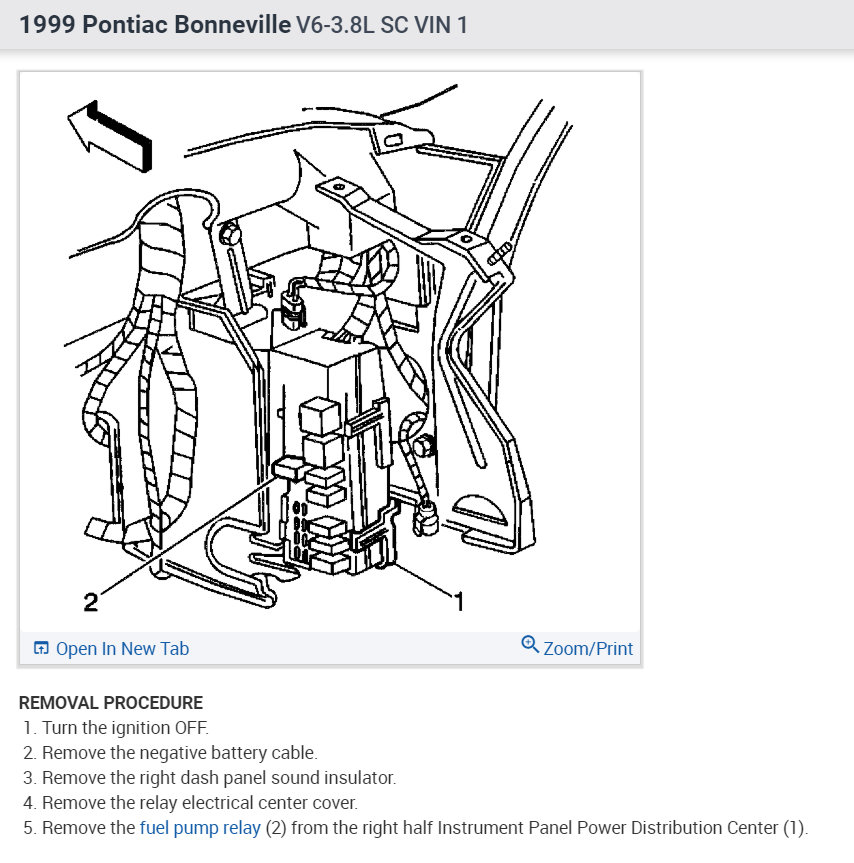

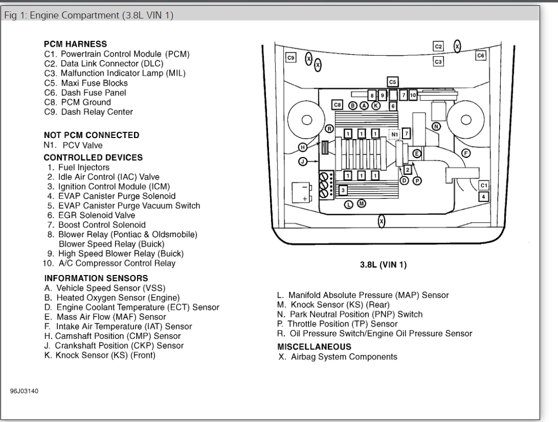

Here is a guide to help test he relay with the relay location in the diagrams below.
Check out the diagrams (Below). Please let us know what happens.

Here is a guide to help you test the fuel pump relay and the location (below)
Cheers

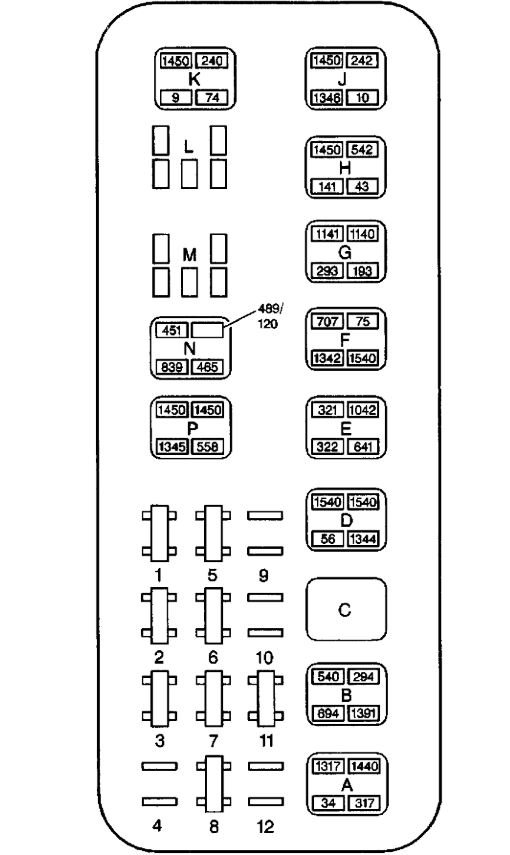

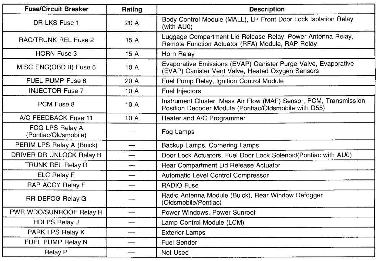

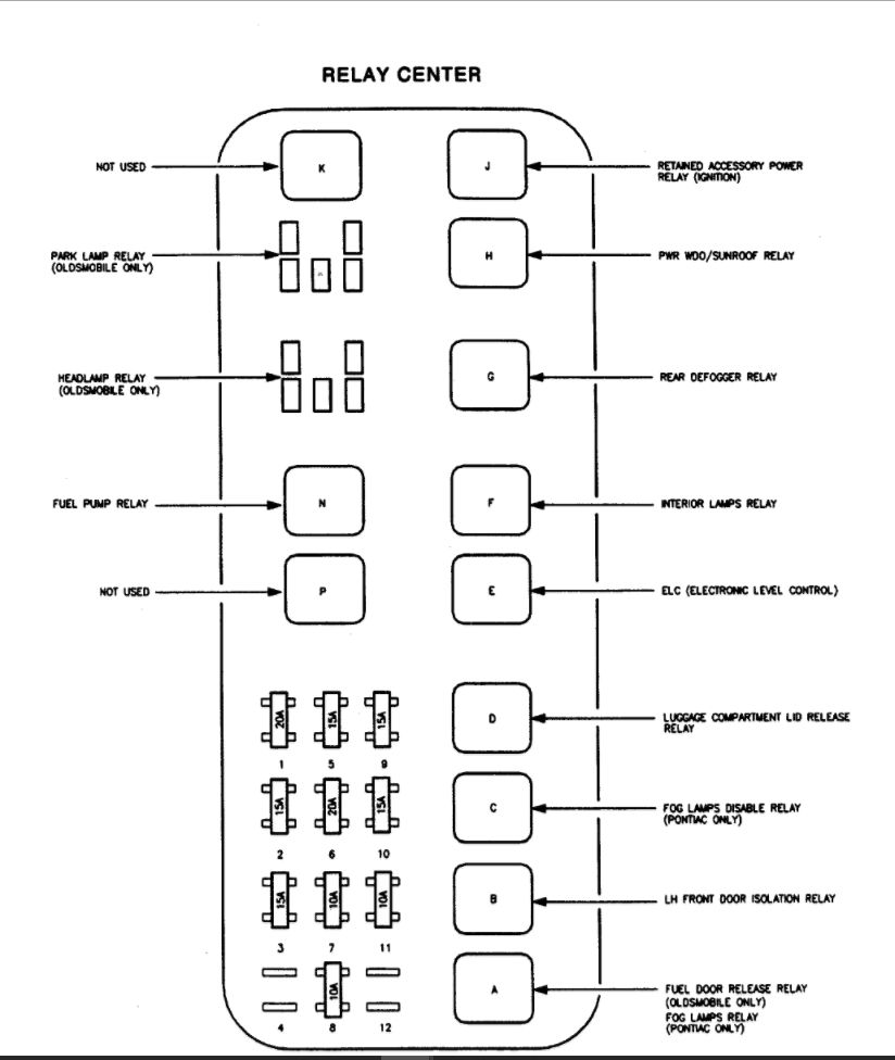

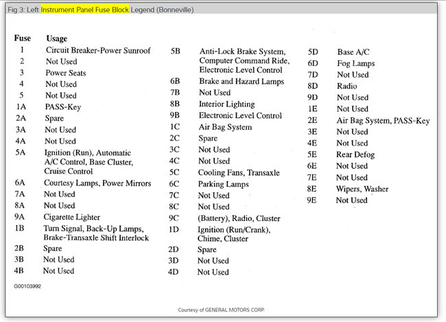

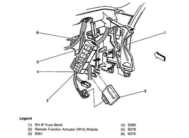

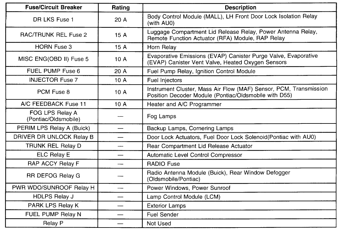

FASTPCMAN
there are 4 relays in my 1999 pontiac bonneville under the hood. which one is my fuel pump relay ?
Jul 13, 2020 at 5:57 PM (Merged)
SUSMAN28888
  • 62 POSTS

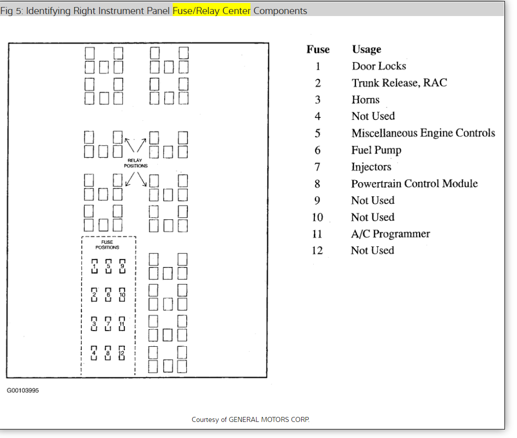

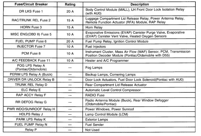

It is relay "N" it is powered by fuse 6... They are located in the R/H instrument panel fuse/relay block
See the guide below on relay testing to help troubleshoot the problem
The fuse/relay block diagrams are attached below,
let us know if you need anything else

BENJAMIN26
I am wondering where the fuel pump relay is located on a 1997 Pontiac Bonneville? Can someone please let me know? Thank you
Jul 13, 2020 at 5:59 PM (Merged)
JDL
  • 16,098 POSTS
My info says right i/p power distribution center. I came across this in your owners manual.
https://www.2carpros.com/forum/automotive_pictures/170934_relay_center_1.jpg
HEATHER7322
  • 4 POSTS
Other Category problem Engine Size unknown Front Wheel Drive Automatic 100000 miles
Where is the fuel pump relay located on a 96 bonneville
RASMATAZ
  • 75,992 POSTS

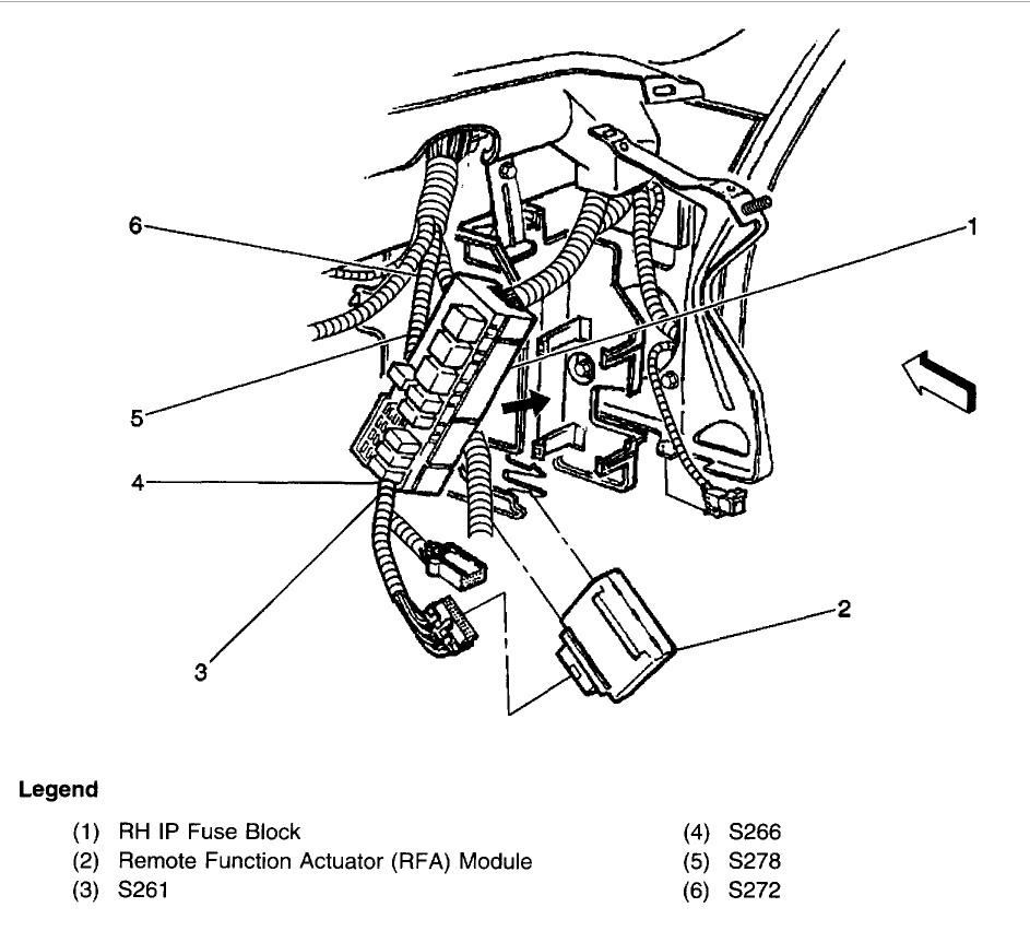

Its behind the right side of dash, on dash fuse panel.
Here is a guide to help you test it
Cheers
