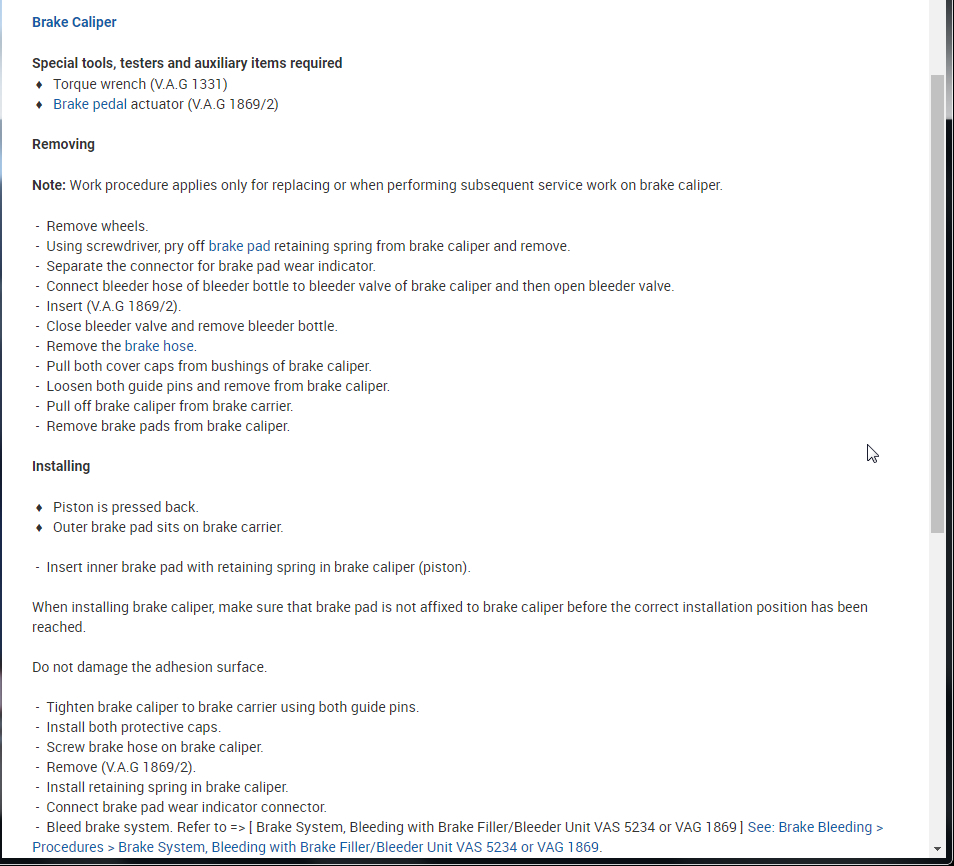

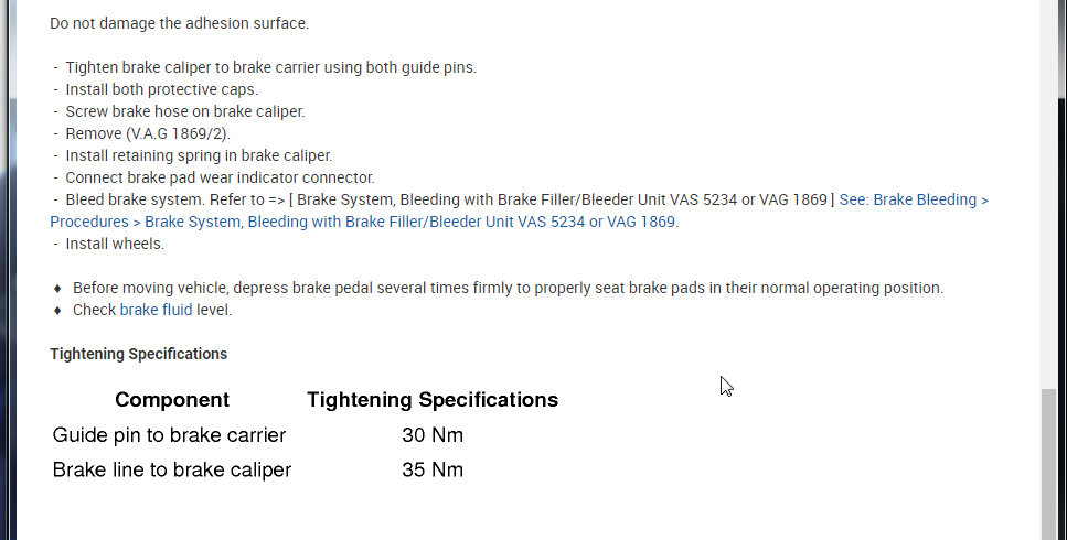

Below is the process from the manual if you need this as well. Let us know what questions you have and we can go from there. Thanks
