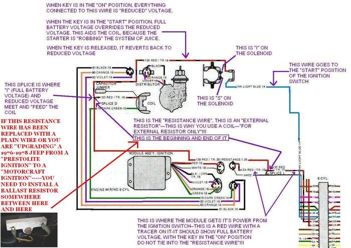

I FIGURED I COULD EITHER
A) STICK IN A COIL W/ AN INTERNAL RESISTOR..............A CHANGE FROM OEM, WHERE THE '79 USED A COIL "FOR EXTERNAL RESISTOR ONLY"
B) INSTALL THE BALLAST RESISTOR ON MY 1977...........BASICALLY "MAKE A RESISTANCE WIRE" THAT THE 1979 SYSTEM HAD ALREADY INCORPORATED INTO IT
SO I WENT WITH "B".............WHEN I NEED SOMETHING FOR MY '77's JEEP'S IGNITION.......I CALL IT A "1979" AT THE AUTO PARTS STORE..............THE BALLAST RESISTOR IS THE ONLY EXCEPTION TO THE RULE (A "MUST HAVE" TO KEEP THE REST OEM)

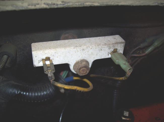

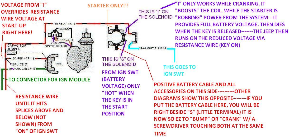

AS FAR AS THE BALLAST "BREAKING"---"BURNING UP"..................NO PROBLEM!...........SEEMS ANY PROBLEMS I'VE HAD WITH ONE, WAS "BOUNCING" THE JEEP AROUND, AND THE "RED HOT" COILED UP RESISTOR WIRE IN THE BACK OF THE CERAMIC GOT SHOOK HARD AND BROKE
THE SYMPTOMS I'VE HAD OF THE RESISTOR BEING BAD IS-----IT'LL CRANK AND FIRE UP, AS LONG AS THE KEY IS IN THE "START POSITION" (VOLTAGE TO THE COIL IS BEING SUPPLIED BY "I TERMINAL" ON THE SOLENOID DURING "START" (FORD/ JEEP)
HOWEVER, WHEN YOU RELEASE THE KEY----IT'S NOW IN THE "ON OR RUN POSITION"----THERE IS A BREAK IN THE WIRE (THE BAD BALLAST RESISTOR) AND IT WILL NOT CONTINUE TO RUN!

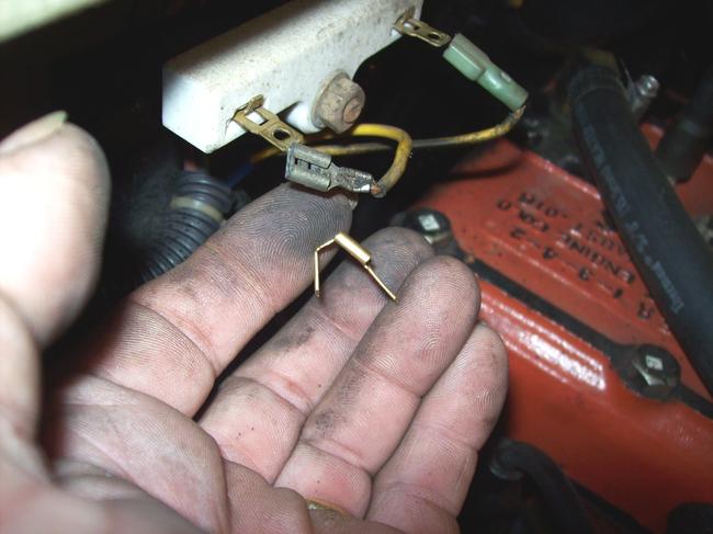

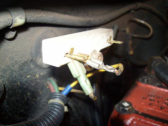

IT WILL RUN (TO LIMP IT IN) SIMPLY BY BYPASSING THE RESISTOR-----THIS IS JUST TEMPORARY, TILL YOU CAN GET ANOTHER ONE------I KEEP A FEW "PIGGY BACKS" IN MY ON BOARD TOOLS AND PARTS.......I EVEN LEAVE ONE ON THE BALLAST RESISTOR, TO MAKE IT EZ!
I'M ATTEMPTING 3 PICS TO DEMONSTRATE!........FORTH IS OF THE '79 SYSTEM.......FIFTH IS SOLENOID OPERATION......SEE HOW "I" WORKS!
