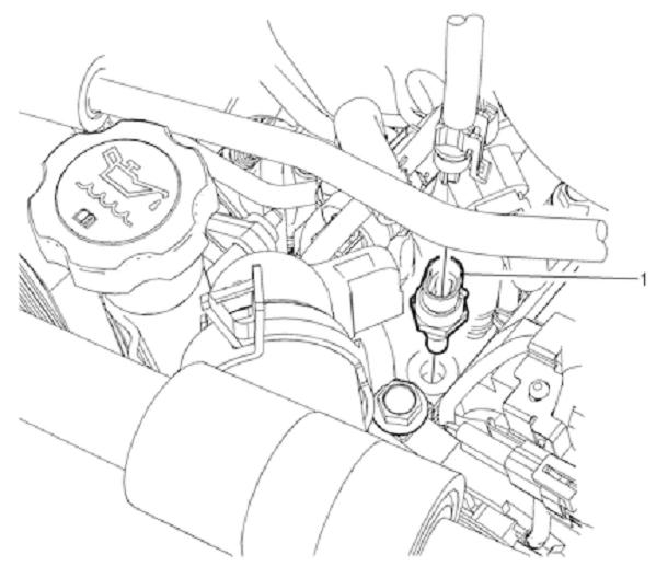

what engine? if it's a 4.8 - a 6.2L see pic

It's a 5.3. Thanks for the picture!
I'll give it a shot.

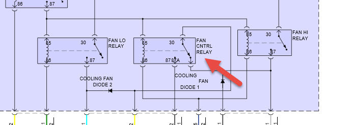

it cold be the pcm is for some reason reading an a/c code or a shorted wire activating the fans. there are 5 different diagrams for the cooling fan which includes a couple of things this one doesn't so check the relay marked in pic if that isn't it send your vin back it is either a 3,0,j,or M

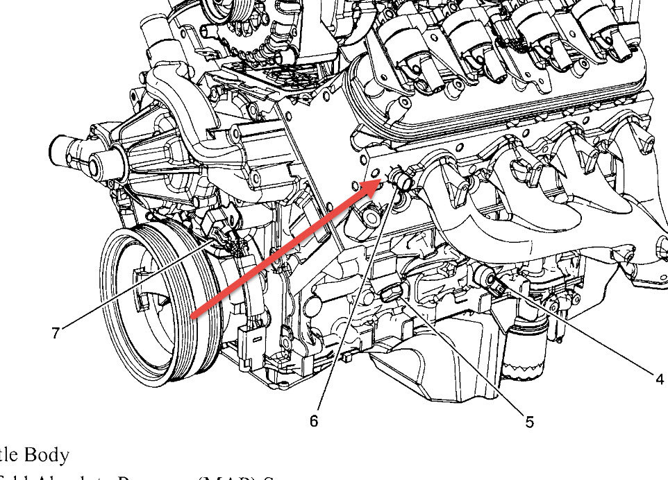

does anyone know where the ect sensor is located on a 2008 gmc sierra 1500 with the 4.3 litre v6
Sep 24, 2020 at 10:45 AM (Merged)
RASMATAZ
  • 75,992 POSTS
Its on left side of engine see location no.8 below

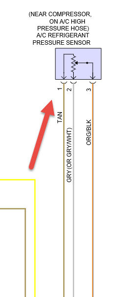

ok what I sent is pretty much the same so it's gonna have to be rescanned and then wiring checked from pcm then from pcm to relays to find the problem. or just for the sheer joy of it try unplugging this wire in pic and see if they stay on. it may be the compressor is telling the pcm that I need cooling all the time even when it doesn't work.
