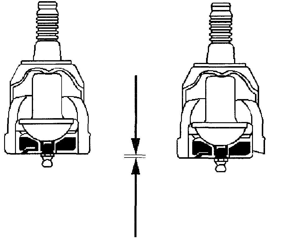

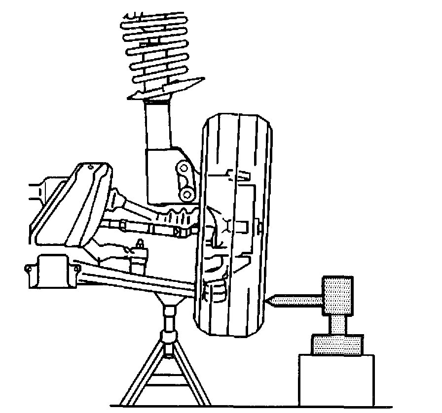

Here are directions for testing a ball joint. The attached pics correlate with the directions.
________________________________________
2002 Pontiac Grand Prix V6-3.8L SC VIN 1
Ball Joint Inspection
Vehicle Steering and Suspension Suspension Testing and Inspection Component Tests and General Diagnostics Ball Joint Inspection
BALL JOINT INSPECTION
^ Tools Required
- J 8001 Dial Indicator
pic 1

5. Check the ball joint for horizontal looseness.
5.1. Position the J8001 against the lowest outboard point on the wheel rim.
5.2. Rock the wheel in and out while reading the dial indicator. This shows horizontal looseness in the lower ball joint.
pic 2
5.3. The dial indicator reading should be no more than 3.18 mm (0.125 inch). If the reading is too high, check the lower ball joint for vertical looseness.
6. Check the lower ball joint for wear and for vertical looseness using the following procedure:
6.1. Inspect by sight the lower ball joint for wear. The position of the housing into which the grease fitting is threaded indicates wear. This round housing projects 1.27 mm (0.050 inch) beyond the surface of the lower ball joint cover on a new ball joint. Under normal wear, the surface of the lower ball joint housing retreats inward very slowly.
6.2. First observe, then scrape a scale, a screwdriver, or a fingernail across the cover. If the round housing is flush with or inside of the cover surface, replace the lower control arm.
6.3. Pry between the lower control arm and the steering knuckle while reading the dial indicator. This shows vertical looseness in the ball joint. The lower ball joint is not preloaded and may show some looseness.
6.4. If the dial indicator reading is more than 3.18 mm (0.125 inch), replace the lower control arm.
