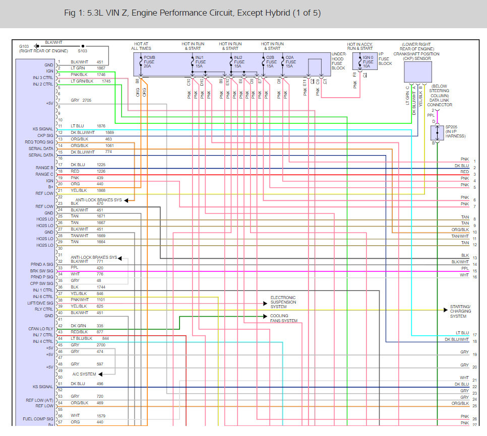

I have change the knock sensors out and harness. the same codes keep popping up.
Oct 19, 2017 at 7:11 AM

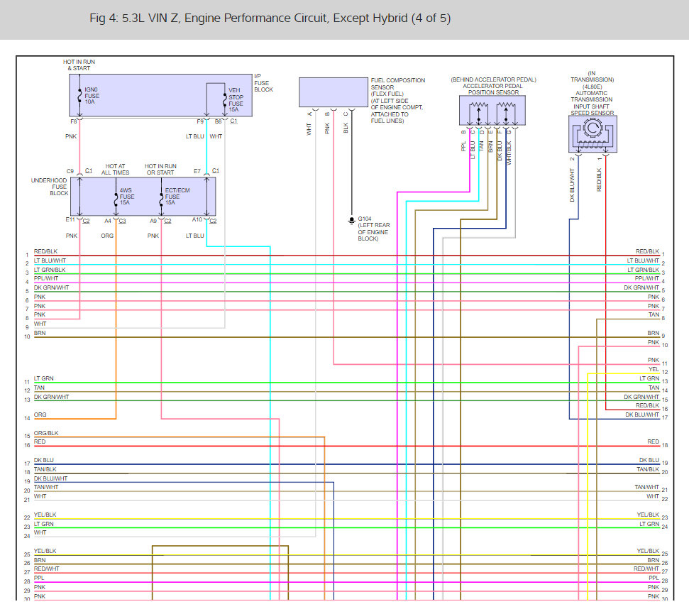

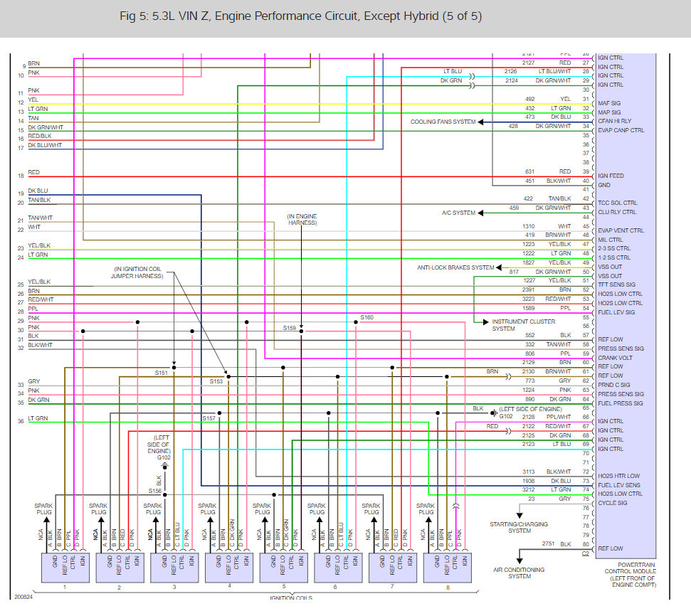

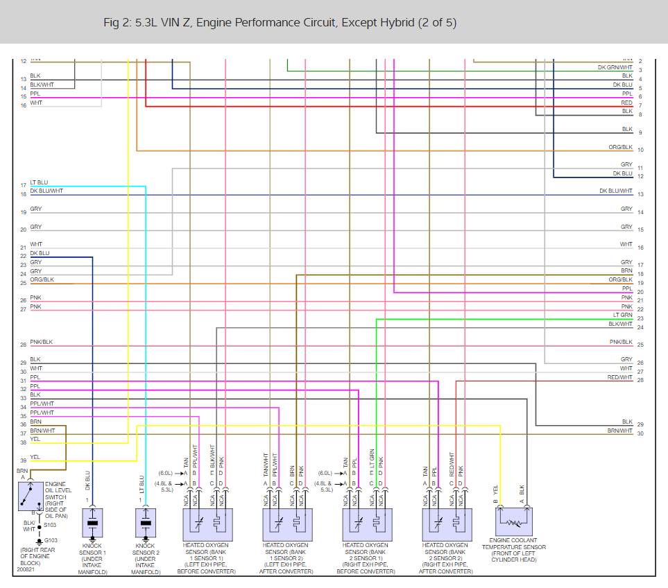

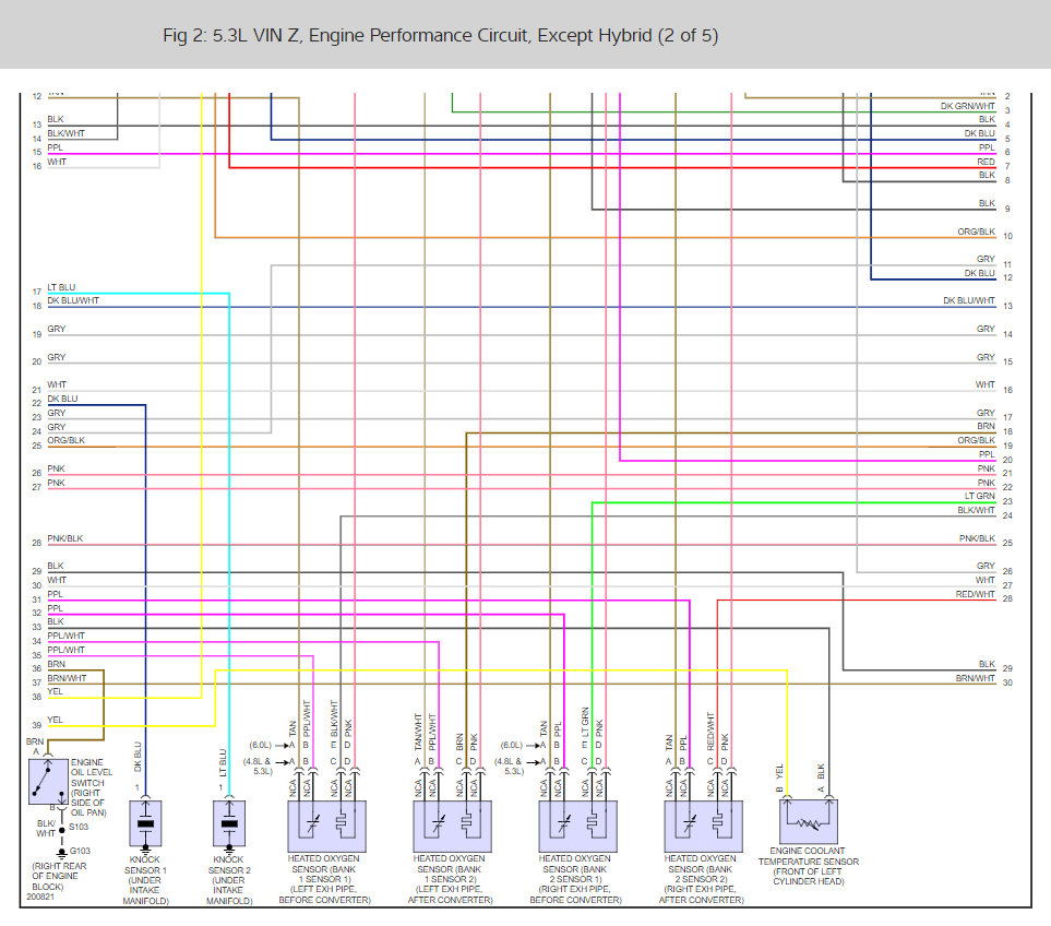

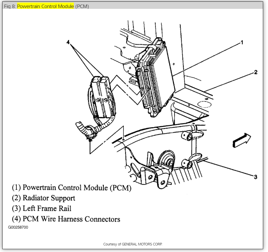

This sounds like it can be one of two problems, either you have a connection/wiring issue or the ECM is bad and needs to be replaced. The PCM will need to be programmed by a shop.

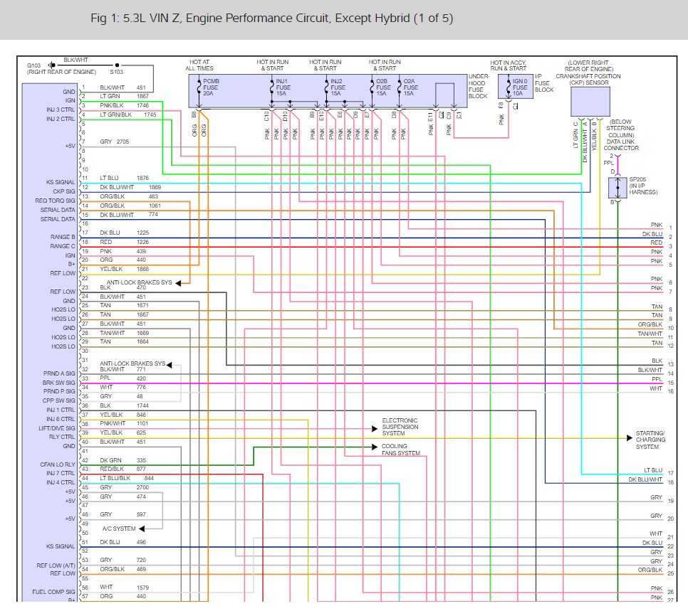

Here is a guide so you can double check the wiring.
There looks like there is 2 sensors did you replace them both?
