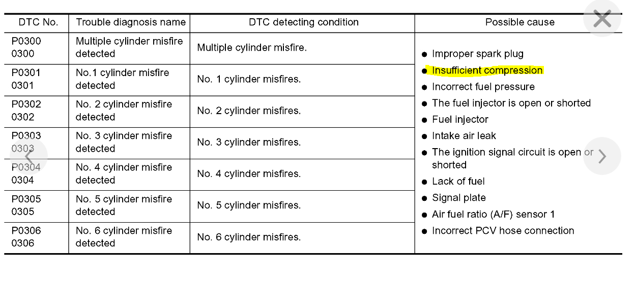

I'm suspecting that the low compression of cylinder #2 is going to be the random misfire issue here. As a rule of thumb the lowest cylinder's compression when doing a compression test shouldn't be lower than 10% of the cylinder with the highest compression. 120 p.s.i. is 75% of 160 p.s.i.. And you were correct in suspecting pistons rings as the cause of the lower compression as the oil test results proved. The only way I suspect to get rid of the misfire would be to fix the worn piston rings on cylinder #2. I have included a diagram for you in the diagrams down below. Please go through it and keep us informed as what you decide to do. We can help with any repairs you plan to do.
Thanks,
Alex
2CarPros
