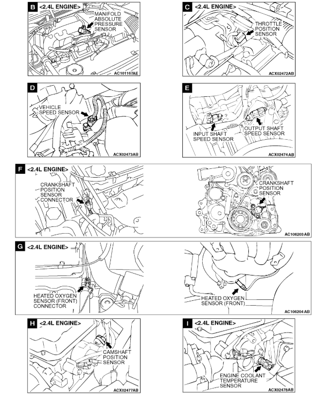

This can be caused by low fuel pressure or a bad MAP sensor. Here is a guide to help you check the fuel pressure and a diagrams below to show you where the MAP in the diagrams below. Also I would service the throttle bore as well.
and
