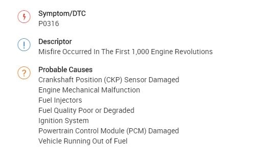

316 is a misfire during the first 1000 engine RPM.
In most cases, it is the number 6 ignition coil failure.
