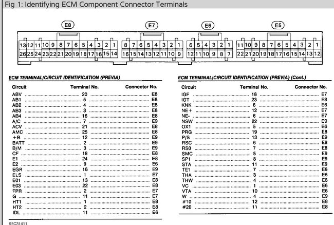

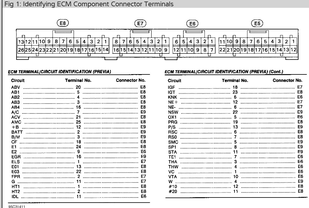

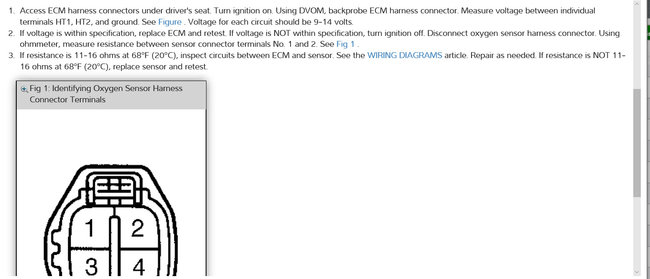

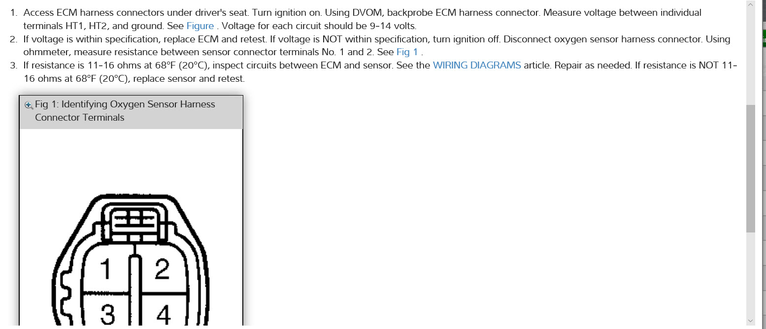

see pics on how to test may be a bad pcm.
