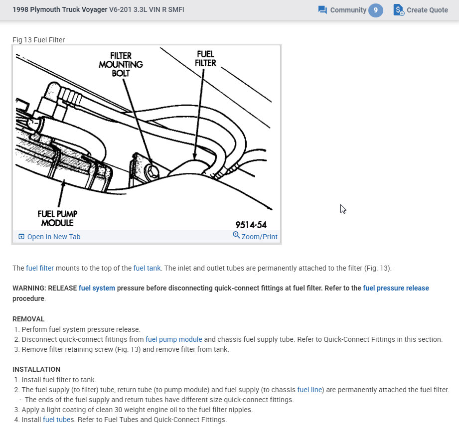

Fuel filter is located on top of fuel tank, near fuel pump module. Fuel lines are permanently attached to fuel filter.
Release fuel pressure from fuel system.
Disconnect fuel lines at fuel pump module and fuel supply line using proper procedure. Remove retaining bolt and fuel filter.
To install, reverse removal procedure. Use proper procedure for installing fuel lines. Turn ignition on and check for fuel leaks.

I attached the procedure for the filter. It looks like it is on the tank. Please let me know if you need more information. Check out the diagrams (Below). Please let us know if you need anything else to get the problem fixed. Thanks

Not really as the in tank unit also has the fuel pressure regulator built in. Your external pump would have to draw through the in tank unit and have an external regulator.
The pump assembly is around $120.00 for the OEM Bosch pump. Labor depends on the shop. It is not a hard one to change but if you are in the rust belt it could be worse.

The fuel filter mounts to the top of the fuel tank, pictured below.. fuel filter (1) mounted next to the fuel pump module (2), on top of the fuel tank (3)
