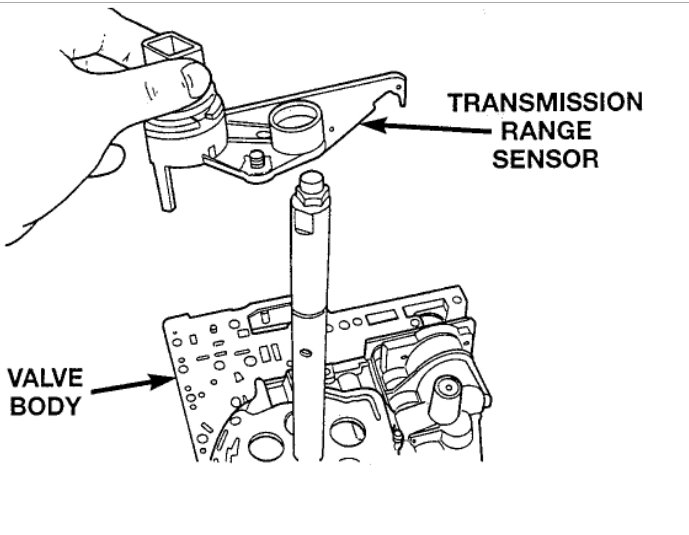

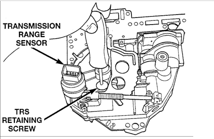

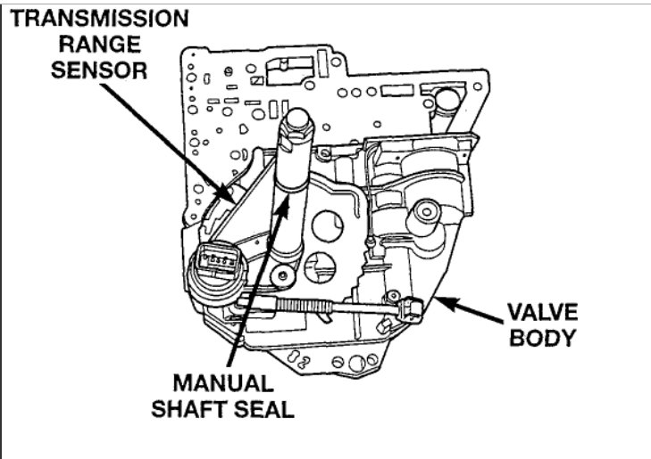

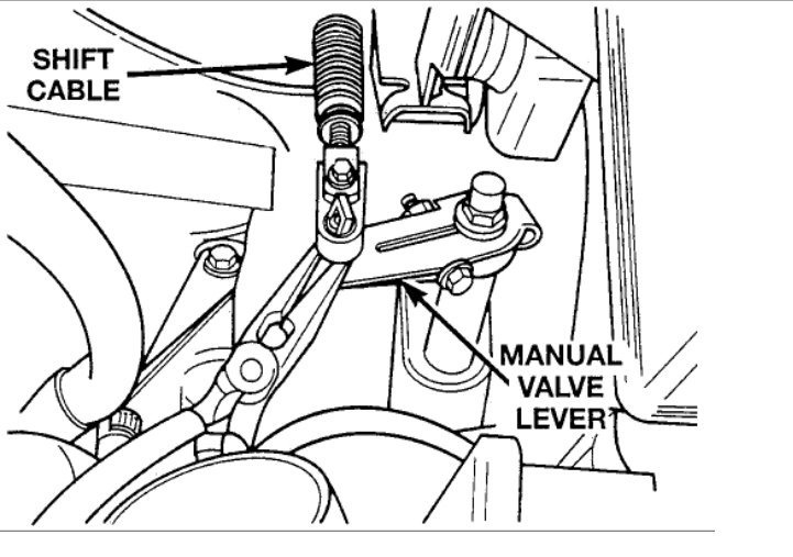

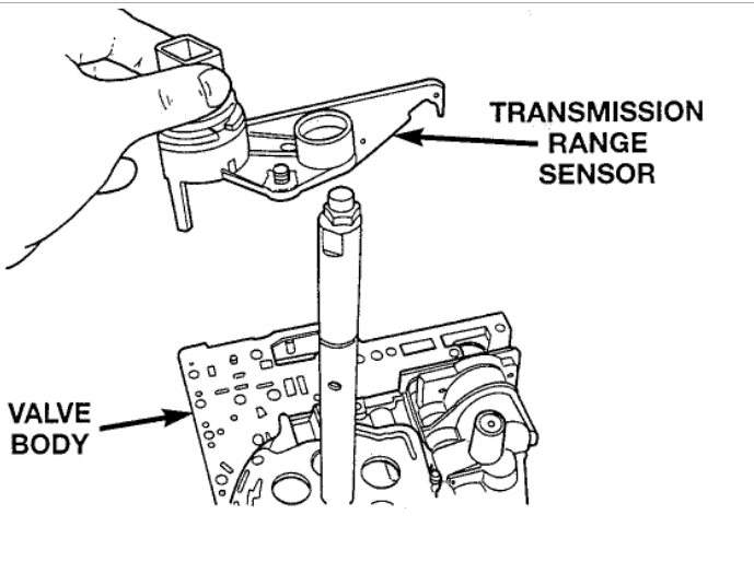

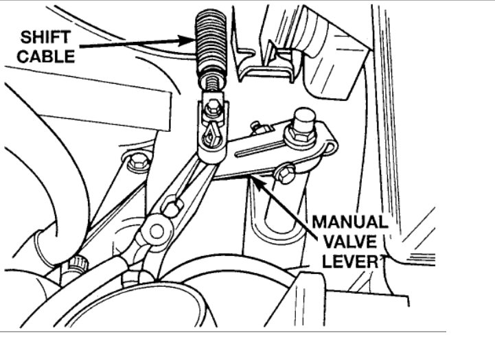

This transmission range sensor is the neutral safety switch all wrapped up into one. Here is a guide on how to service the transmission and replace the sensor (Below)
Please let us know what happens so it will help others.
