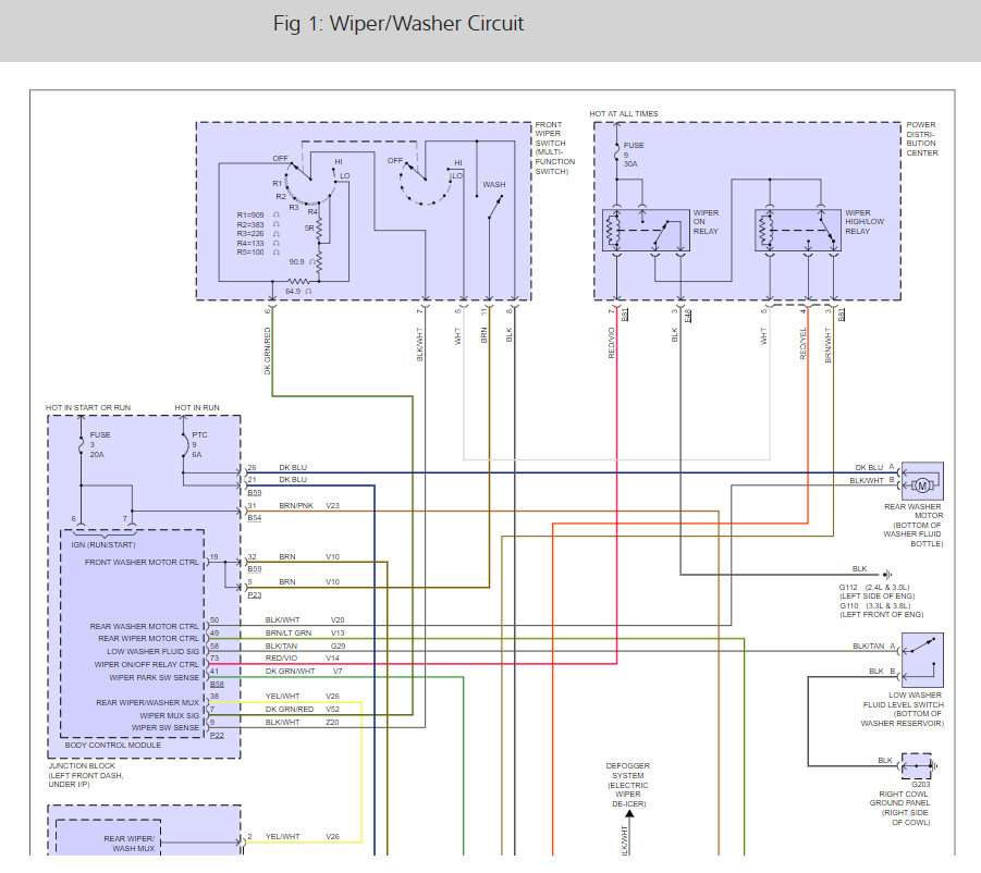

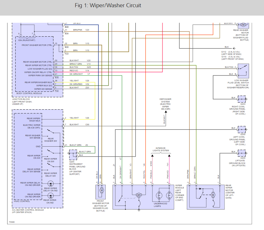

If fuse 19, your "wiper on" and "hi/lo" relays are good, it has to be the switch. The wipers should work on high/low even it the delay function in the multi-function switch is bad. You are losing power somewhere it could be the BCM let's find out for sure by following this guide and the wiper wiring diagrams below.
Check out the diagrams (Below). Please let us know what you find. We are interested to see what it is.

It seems strange that the wipers quit "after" you changed the BCM. Was the BCM new or used? Do you have a wiring diagram for the wiper/washer system? If not, if you have, or have access to, a fax number I can ship you one. I can attach it to this post but they do not through very clearly. If the relays and fuses are good, and the switch is new, The only thing left is the BCM. Let me know.
