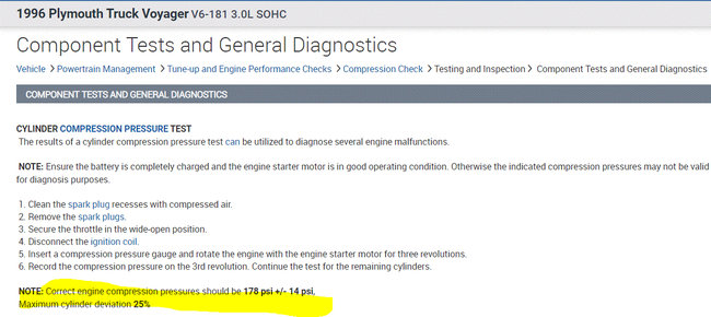

If timing is off, the intake and exhaust valves will not be in the optimum closed position on a compression stroke. Therefore, you can perform a compression test to determine if it is low. Here is a link that shows in general how it's done:
If you look at pic 1 below, it provides the directions specific to this vehicle and what compression specifications should be expected.

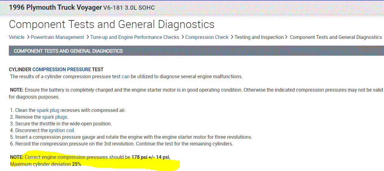

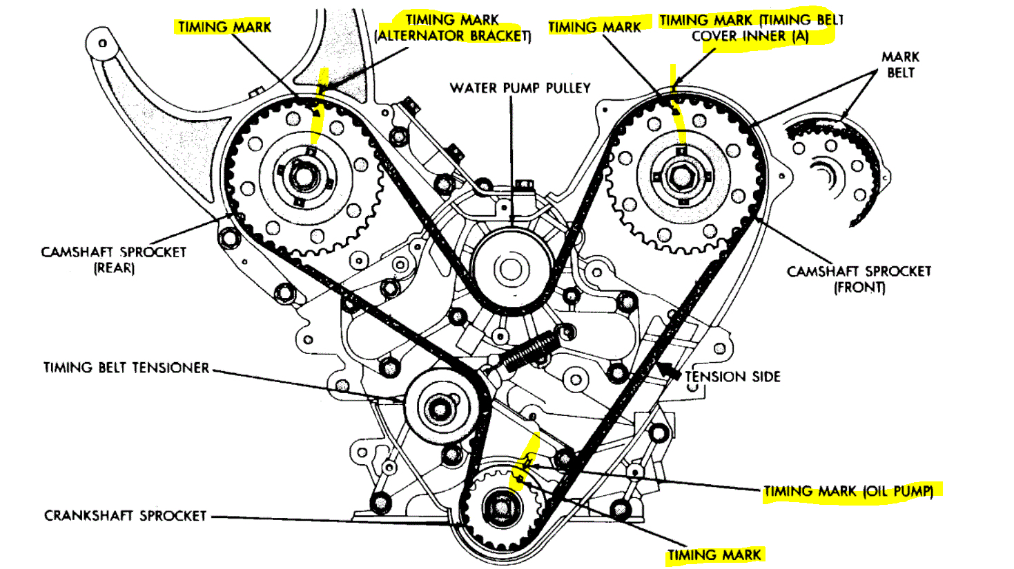

Also, you can remove the timing belt cover and confirm the timing marks are properly aligned. If you look at pic 2 below, I highlighted where the timing marks are on the sprockets and their indicators on the engine.
