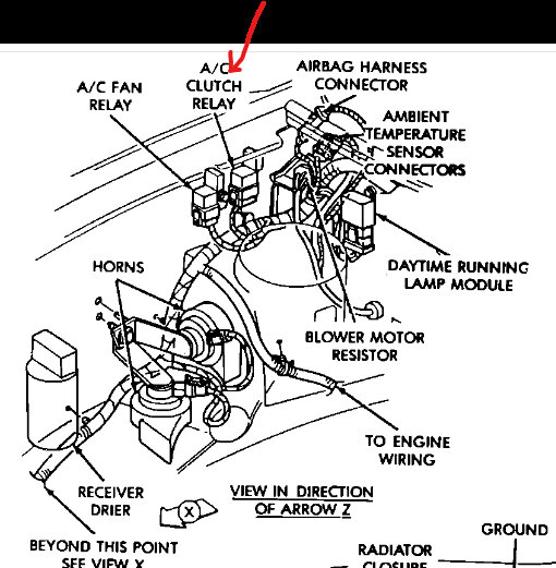

I have seen the AC clutch relay stick on which drains the battery out, her are two guides to help us fix the problem and I have included the location of the AC clutch relay so you can remove it over night to see if that fixes the problem.
and
https://www.2carpros.com/articles/car-battery-dead-overnight
