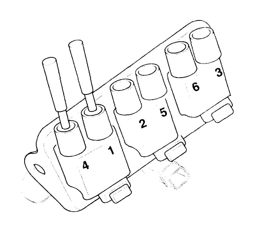

I can't find the correct diagram that shows which plug wire goes to which coil.
May 3, 2025 at 6:47 AM
STEVE W.
  • 15,113 POSTS
One of the few "easy" systems to figure out. Look at the coils mounted on the bracket. They are in order for cylinders 1 2 and 3. So the first coil gets cylinder 1, second is cylinder 2 and third goes to cylinder 3. Then you put the other 3 on as 4,5 and 6 So 4&1 then 2&5 and 3&6.
They are a waste spark system so as long as they are on the correct coil it doesn't really matter if say 1 and 4 are put on as 1-4 or 4-1 as long as they are on the left coil.
