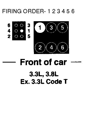

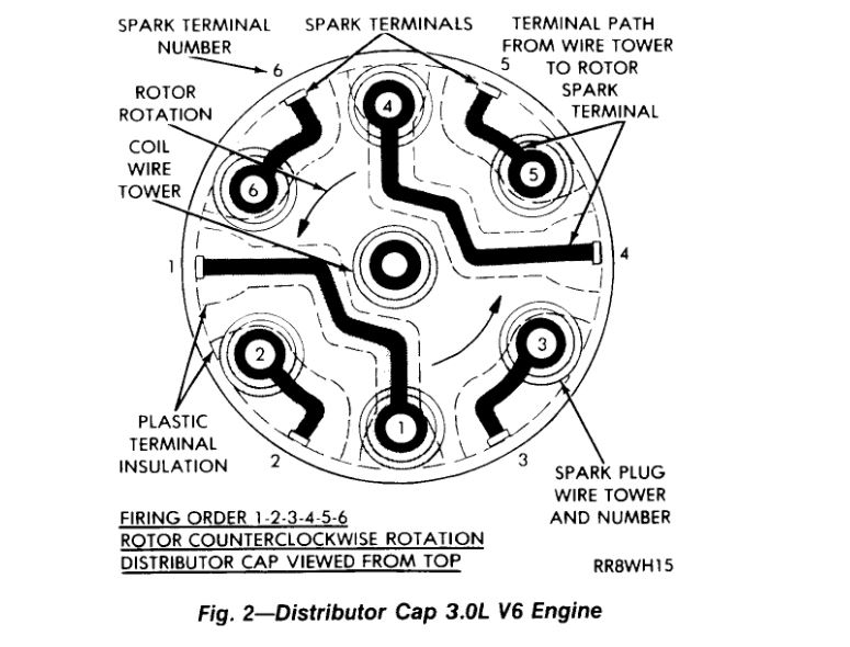

I need the plug cable order diagram to connect back the plug cables for my car.
Apr 13, 2018 at 3:29 AM
Good morning. You did not identify the engine so I enclosed both the 3.0 and the 3.3. the 3.8 is the same as the 3.3. Check out the diagrams (Below). Please let us know if you need anything else to get the problem fixed.
