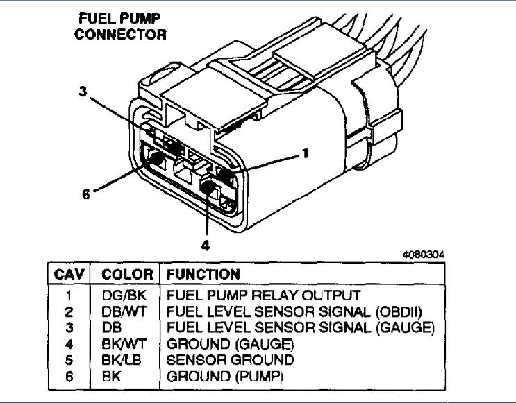

Fuel pump wiring harness plug.
Apr 30, 2020 at 4:52 AM
CERTIFIED EXPERT
52,796 POSTS
Good morning,
I attached the plug from the body to the pump assembly. It contains wire colors, location and functions.
What is the issue?
