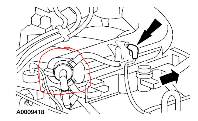

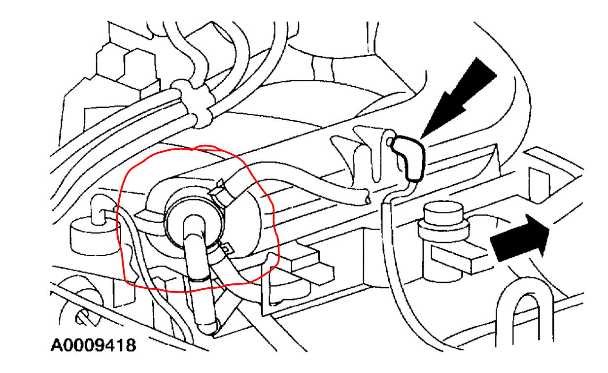

Not a problem. It has been awhile since I have seen one of these. It has a heated PCV system. Not that I better understand, there is coolant going to it. If you see the attached picture, let me know if that is what you are seeing.

Actually I thought it was coming right from my plenum it actually it is coming from at top hose that in that round circle that you circled. When I remove that top hose that's where the water come out and now it's all rusted. what should I do? is that worse or what? Do I need a whole new motor now or what can I do? it's all rusted, so I got to be something fast. please help as soon as possible. thank you so much.

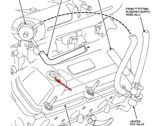

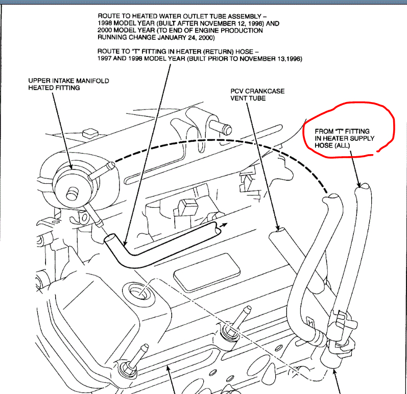

Don't worry. The part you are referring to can be replaced. As far as the heater core, chances are it was bypassed because there was a problem with the core leaking into the vehicle. I attached a picture of the routing of water lines. Do me favor. If you can upload a picture of where it is leaking, it would help me. Also, is the rusted component leaking through a rusted area or from a connection?

Do you need help with heater / PCV routing? Also, were you leaking any coolant prior to having it serviced and was the heater working?
Let me know. I wish I could see what you are dealing with. I suspect when the heater core was bypassed, they rerouted the heated PCV hoses as well and that's why they look wrong. I can tell you that the supply line that went to the heater core first went through the PCV heater then to the firewall (heater core), The return from the heater core will run back to the engine.
