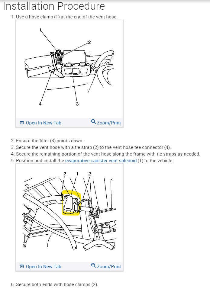

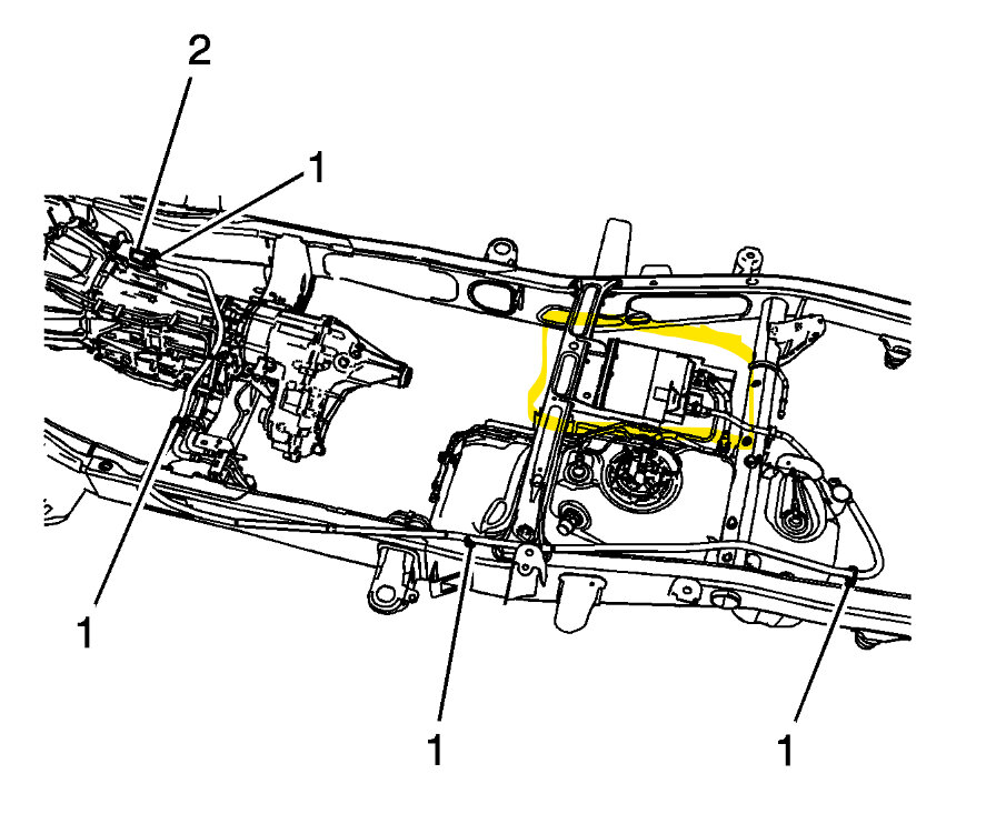

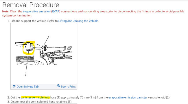

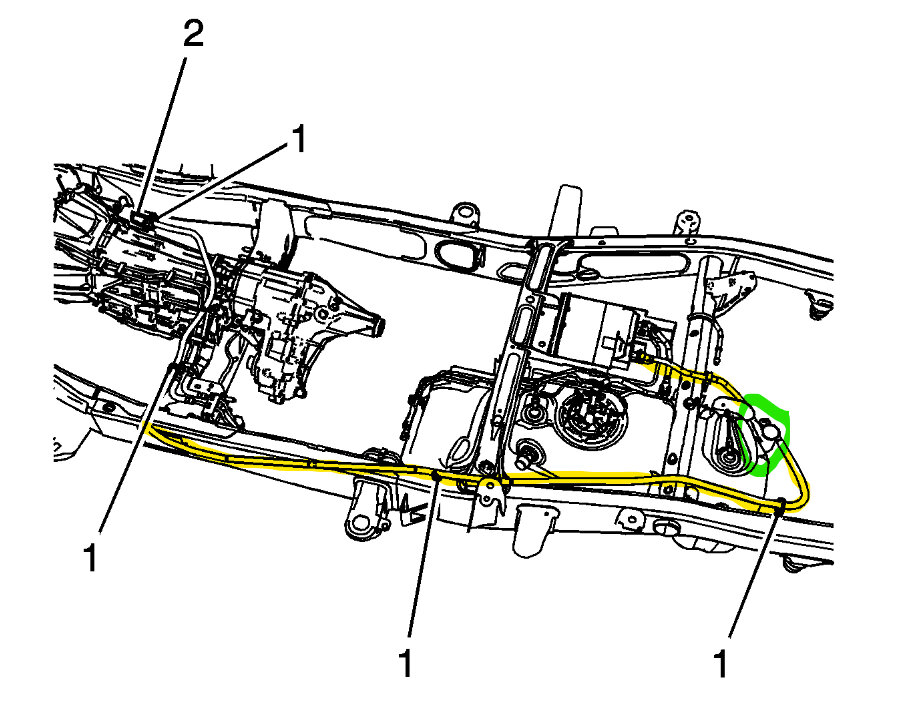

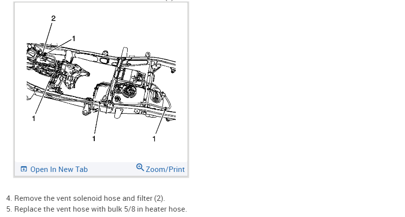

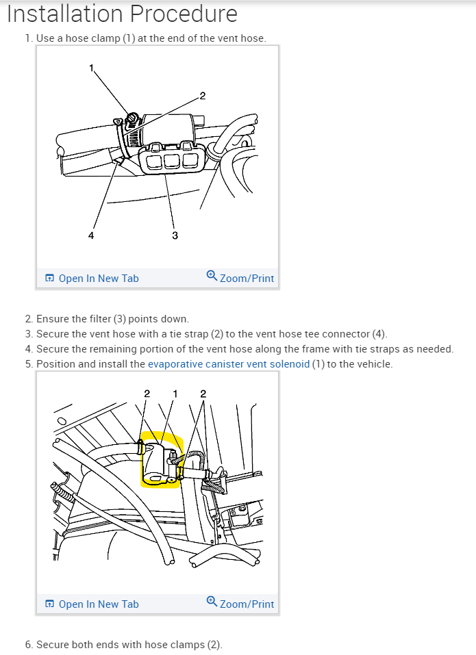

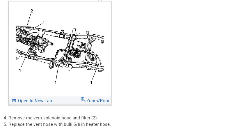

The first diagram is the entire rear frame of the vehicle, the Charcoal canister is circled in yellow. The 2nd diagram shows the location of the Vent valve (in green). Diagrams 3,4,5 are for replacing the Vent Solenoid. I'm not sure why they want you to cut the vent hose, I would get the Vent valve first then take a look at what's needed to replace it. Make sure to check the electrical connector for any dirt or corrosion, also check the wiring to the connector to ensure that it's not rubbing against the frame and shorting out or cutting into the wire harness.
A capable scan tool is required to bidirectionally close the Vent valve to check the system for leaks and proper sealing.
