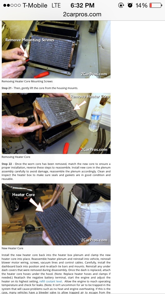

Attempted to replace heater coil in my Honda Civic 1995 but got to a point where I'm not sure what to do next if you can please help me and tell me steps or ways to do it from the beginning so I can use it as a check list in my head if greatly appreciate it

Could I also use the tab where it says repair and service and click on how to replace your heater core ?

Where did you see that? If you can find a video, that will be better than line drawings and words in a manual, but you'll likely only find a generic video not specific to a certain car model, or at least not for your model. What it WILL do is help you decide if you want to keep going.
Be aware that working with refrigerant is very dangerous. It can cause blindness and frost bite. Professionals wear safety glasses, gloves, AND a face shield.

Hopefully I can use this and get this done still will send a photo of my mess
