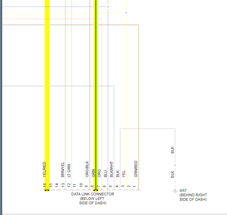

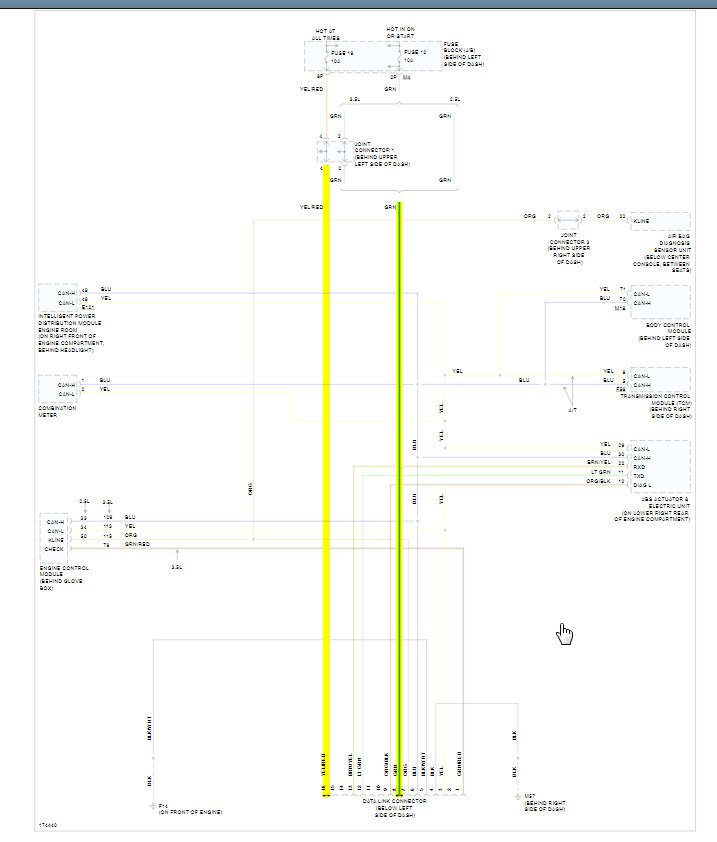

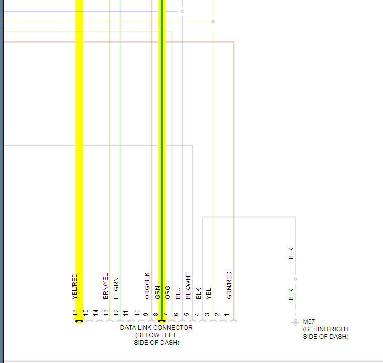

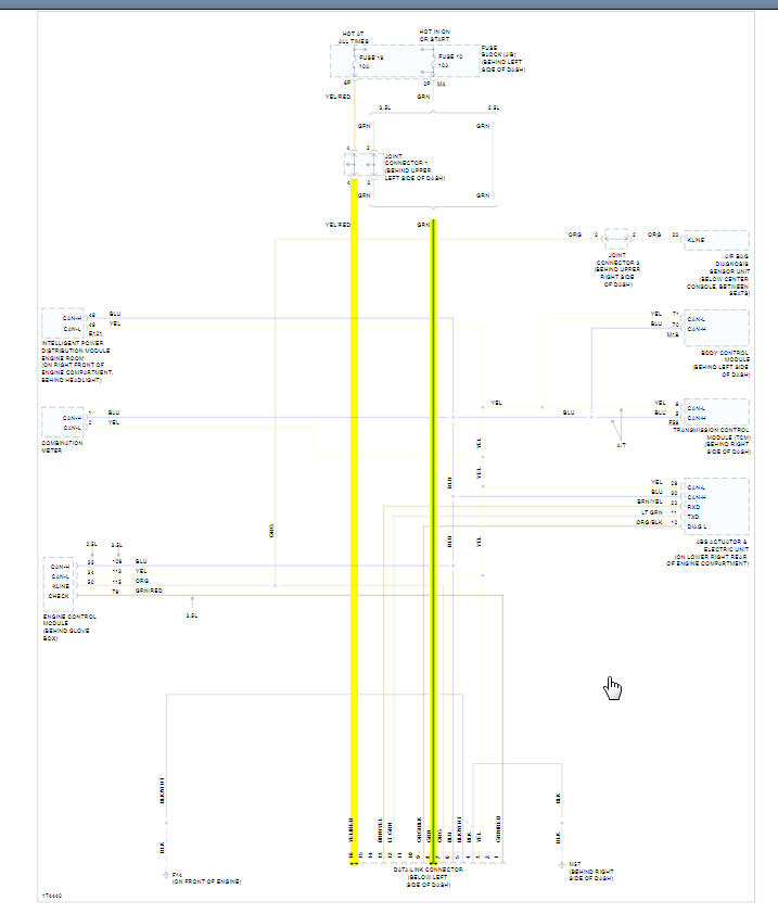

Sounds like we have a couple things going on. They could be related but we need to start with trying to find out why we have no power to the DLC. We need to try and get some codes to find out what the issue is with not starting so let's check for power on the two wires highlighted to find out if you have power going to the DLC.
I attached the wiring diagrams below. Let us know but you should have 12 volts on both of these wires.
Here are a couple guides that will help with no starts but again, let's try and get some codes first and go from there. Thanks
