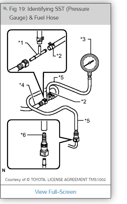

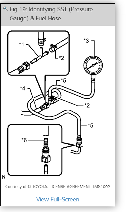

Use suitable adapter to connect 100 PSI transducer to injector fuel rail or fuel filter outlet.

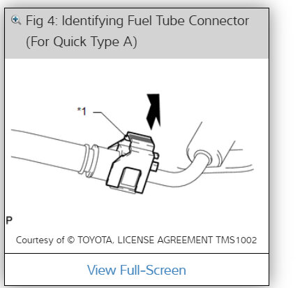

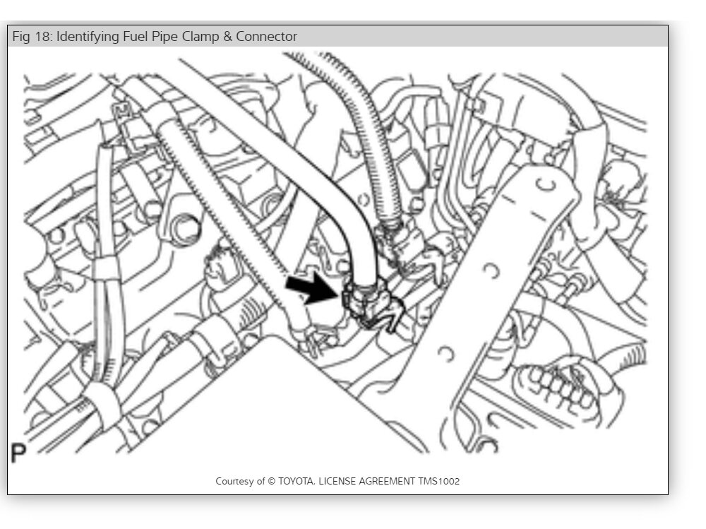

Toyota/Lexus vehicles do not use Shrader valves on fuel rail. System uses plastic fuel lines with quick disconnect type fittings. Fuel pressure gauge can be installed by using "Tee" connectors.
Crank Engine to check transducer fittings and hoses for leaks before continuing.
