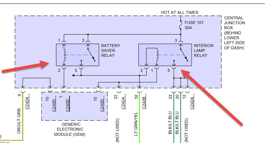

check door switchs for working if you have enough knowledge to remove them see if wire is broken on one of them. check relays in picture. if those are not the problem then have a mechanic scan for codes to check GEM module. I am assuming they are staying on all the time because your description is vague.
