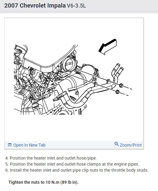

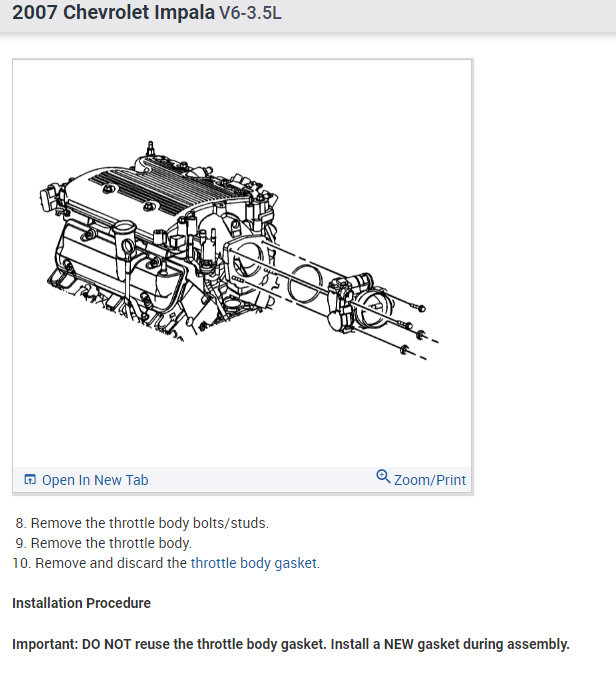

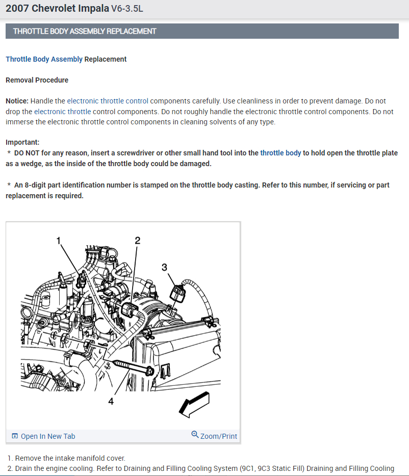

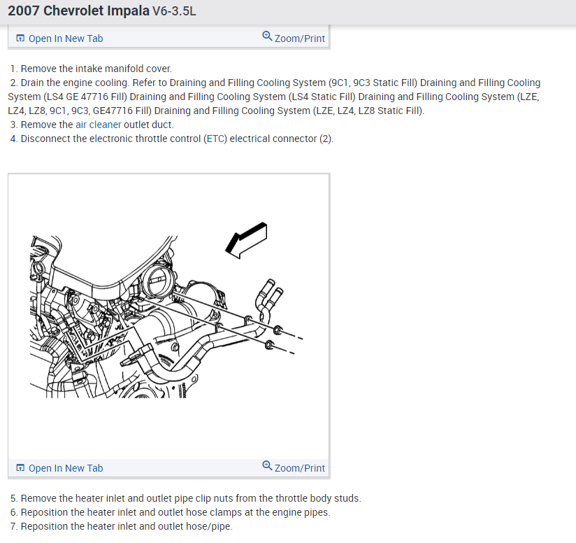

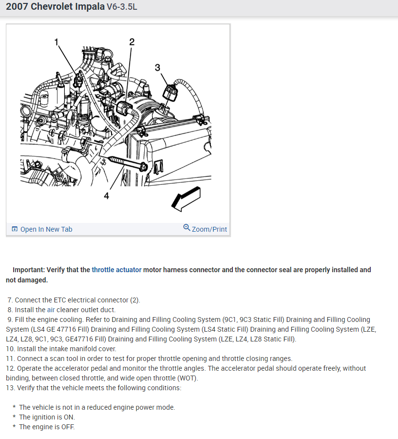

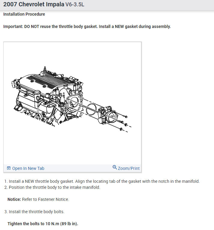

The vehicle can go to the low power mode when it there is an issue with the engine management system.
The most common reason for a lower power mode to be triggered is a dirty throttle actuator.
Inspect the actuator and clean if necessary. Typically cleaning it out will fix the issue.
https://www.2carpros.com/articles/reduced-power-limp-mode
You mentioned that AutoZone cannot pull any codes. However is your check engine light on?
Here is a guide of how to clean the actuator:
Thank you.
