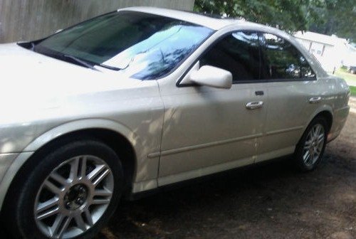

in safe mode after washing engine
2003 LINCOLN LS
125,000 MILES
SHANNON_LEE_BRIMER
We purchased this car used (V8 engine) three days ago and yesterday we cleaned the
engine(now we know that was not a good idea) but now the ETC light is on and the car is in "safe mode" and car will not accelerate. It will idle but will not move. Before this, the car was running good.
what should i do? any help will be appreciated. thanks in advance.
