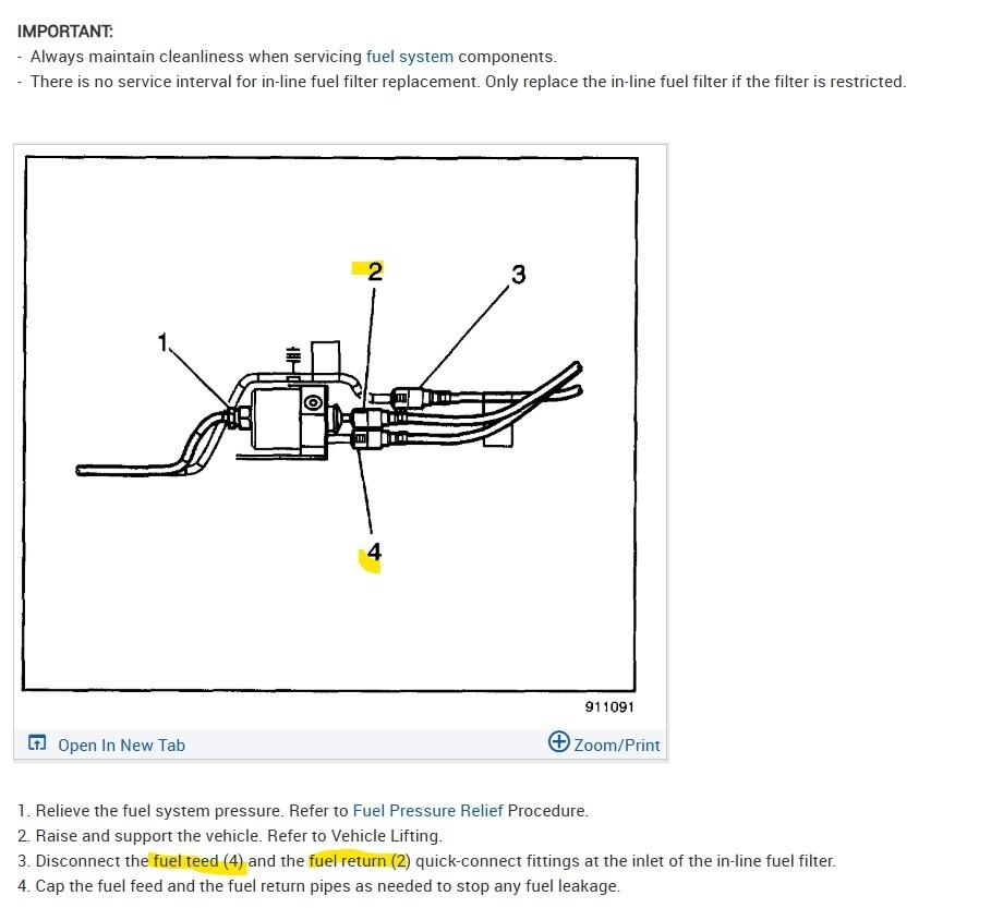

Just need to know what goes to wear on my three line in-line fuel filter which one is the feed, and which one is the return.

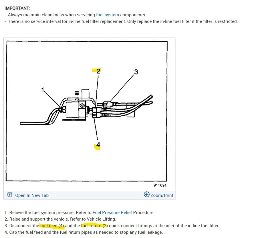

Hello, there is a diagram showing which lines are the feed and return, Ill post that, as long as you know which lines each of those are. I'll post this diagram for you.

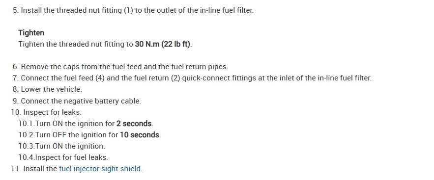

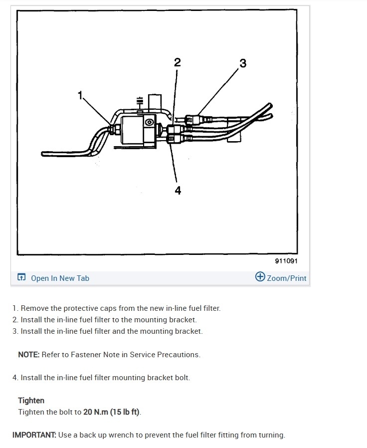

Hopefully this will help.
