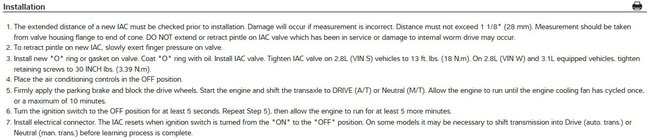

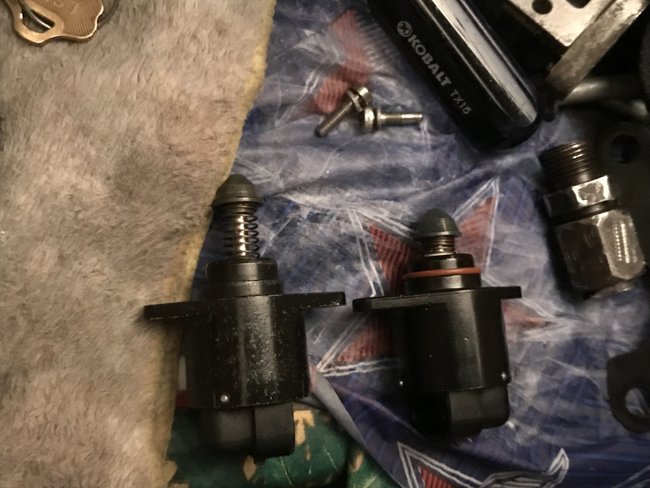

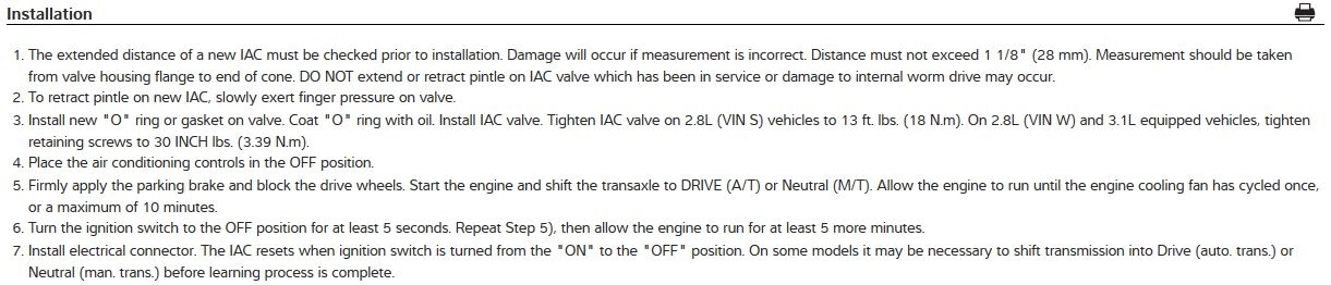

I know there is a relearn process for when replacing an IAC control valve, but I came across an older Buick Dealer Service Bulletin from 1988 regarding the 2.8L V6 Engine Base Idle RPM Adjustment for the Idle Air Control Valve relearn process.
Buick stated that all 2.8L MPFI V-6 Engine calibrations for 1988 and 1987 service include a feature which stores in ECM memory the Idle Air Control Valve (IAC) Position at which the engine idles. Each vehicle will have a unique value, depending on the throttle body base air rate setting, deposit build up, etc. The IAC position information is continuously updated, during vehicle start operation, and stored in the ECM "keep alive memory when the engine is turned off. If the ECM is without battery power for any reason, then the IAC position information for a stable engine idle is lost and is replaced with a default value.
Buick than said to correct IAC position information due to a disconnected battery power and improve engine idle, you must perform the relearn procedure for the Idle Air Control Valve to work properly with smooth idle.
I have never knew you could do this before. so my point is do you have to do this procedure every time when you disconnect the battery or get a new battery to improve engine idle? Also, can this service process by Buick be done with 2.8L V-6 engines for the 1989 Model year as well? Such as if Buick says you do not need to perform this process for the 1988's and 1987's can it be done with the 1989's as well since it has the same displacement engine or did they change it? All the throttle body's worked the same way for all interchangeable 1988-1991 models that had this type of throttle body used.
If I can save myself some time by not disconnecting the battery when putting the new IAC this would save a lot of time. But I want to make sure I do not damage my engine. They said a base idle rpm adjustment is not required and should not be performed on 1988 Vehicles. like I said above can this be matched with 1989 vehicles as well?
