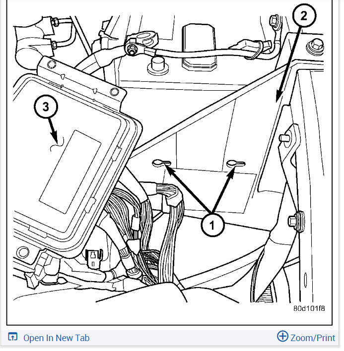

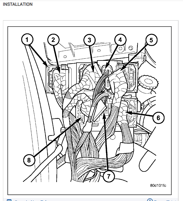

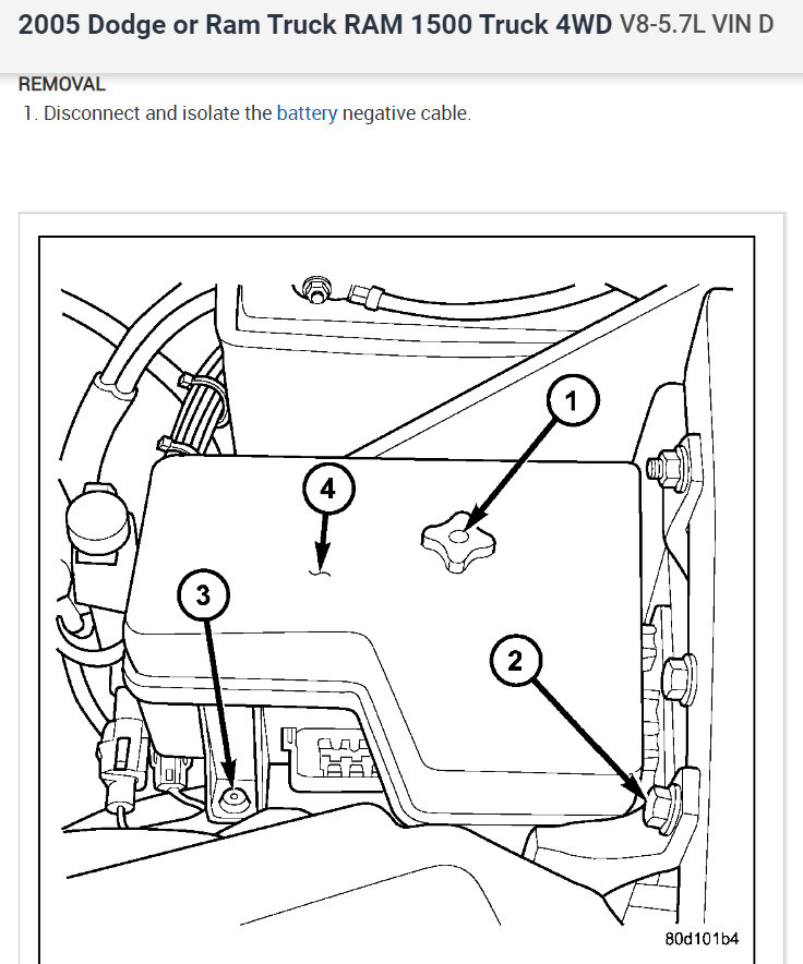

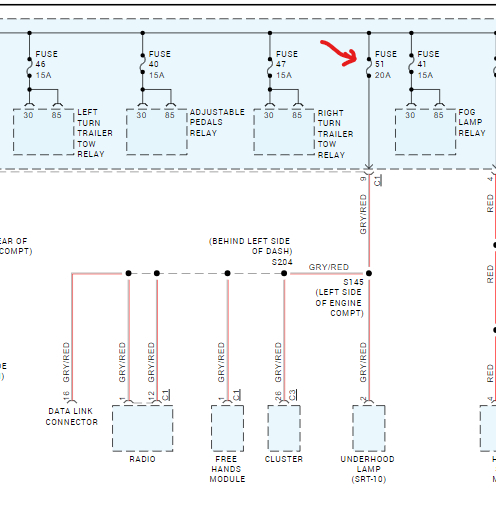

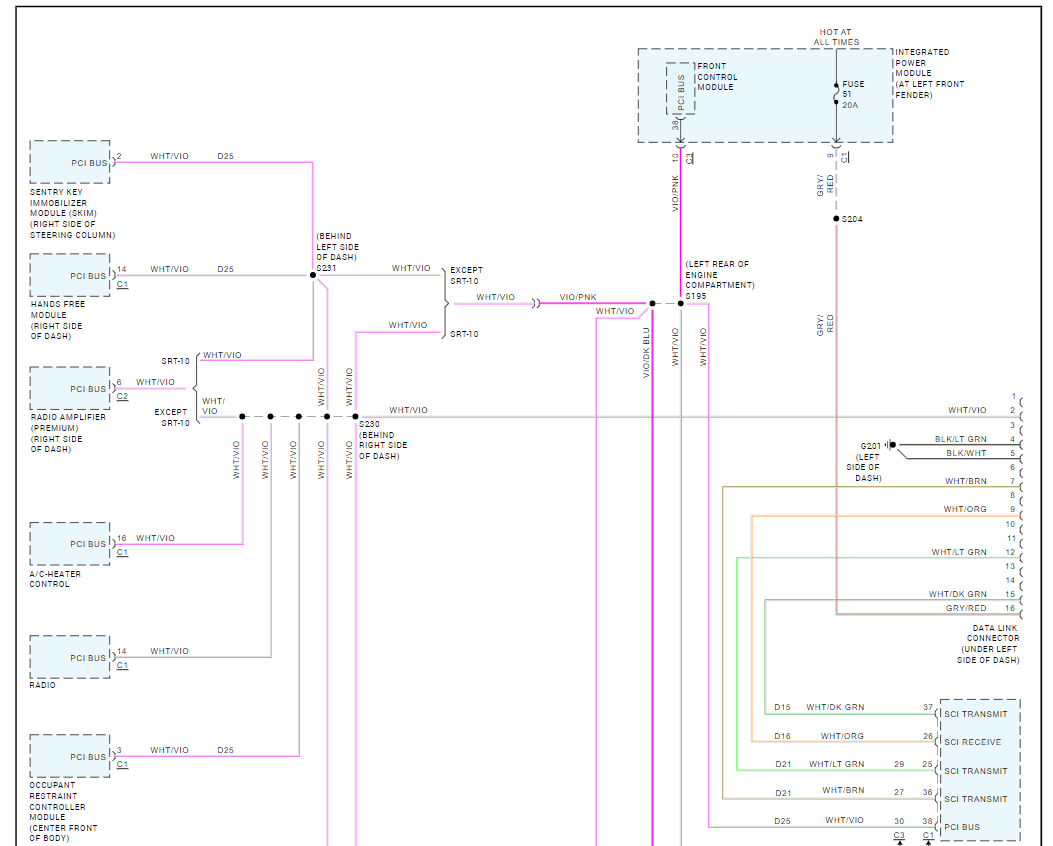

Fuse #51 goes to the data link connector, radio, hands free module, cluster and the under hood light. These trucks had problems with the IPM (TIPM) just to let you know. We have seen many go bad. Can you tell me if fuse 51 has power?
This guide can help:

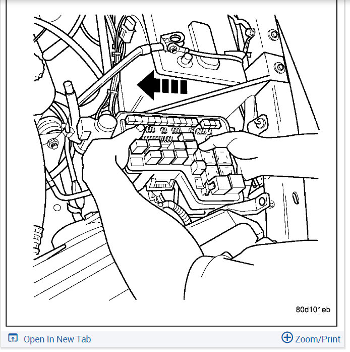

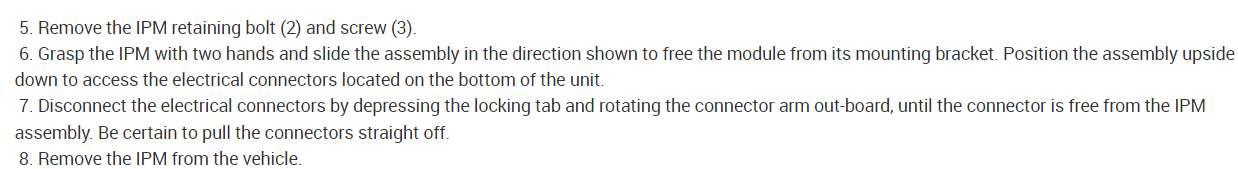

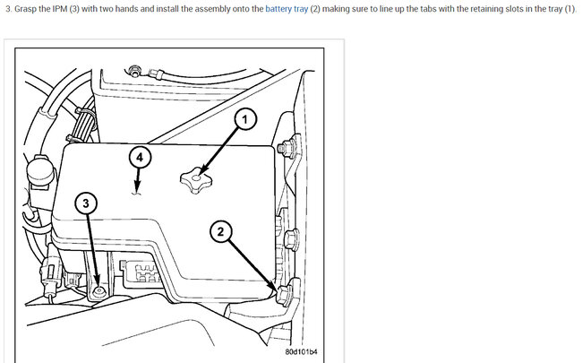

Here is the wiring diagrams for fuse #51 and how to swap out the IPM in case you need it. Also I found the pin out for the 1 connector. The IPM is easy to replace because it self learns. Check out the images (below). Please upload pictures or videos in your response to the problem so we can see what's going on.

yes, i have power to fuse 51 on connector 1 i have power in the wires at #1 and # 8.

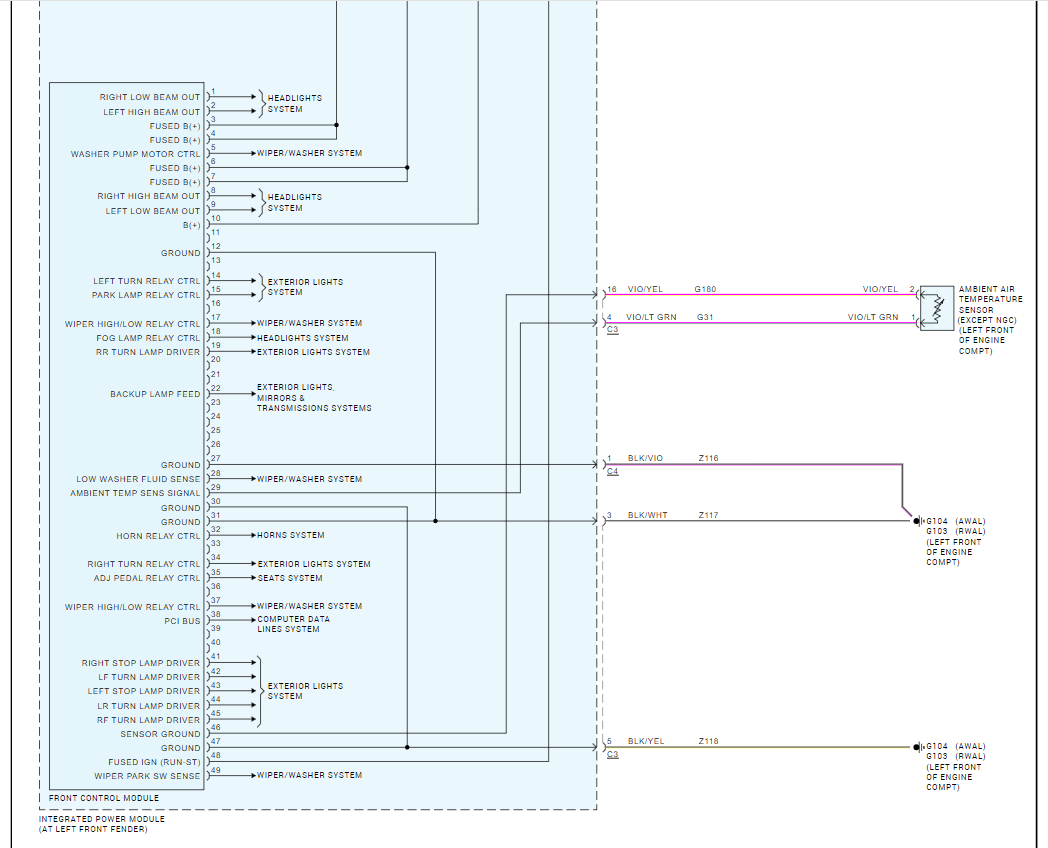

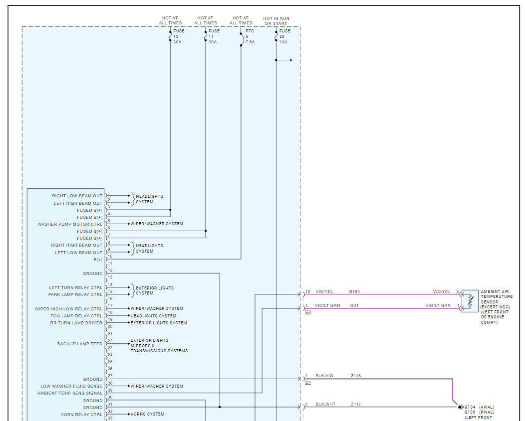

Sure, here is the wiring diagrams for the front control module (IPM) let me know how it goes.

So far everything on fcm is working.

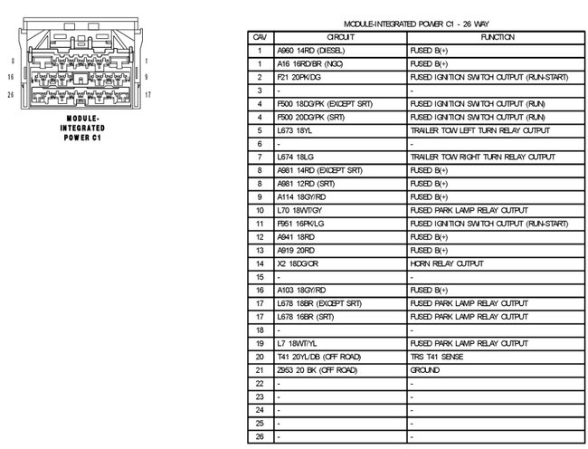

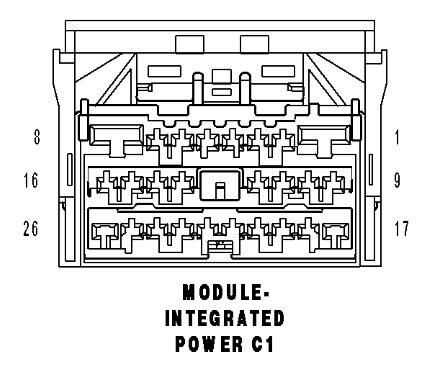

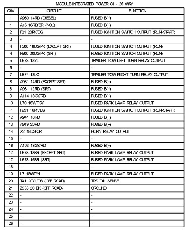

obd ii and interior , remote doorlocks and radio dont work . but when I put the key in ignition, everything works except the radio and the OBD I was wondering if you could tell me which connector on the vehicle that the wire for the OBD and for the remote door locks and security are on so I can test those wires because maybe in that connector is where the problem is
I appreciate your help so if you can give me the pin outs for C1 connector because that’s where I believe the wire for the OBD go to I was going to test that connector out to see if I have power coming out of that circuit.
Feb 22, 2024 at 1:32 PM

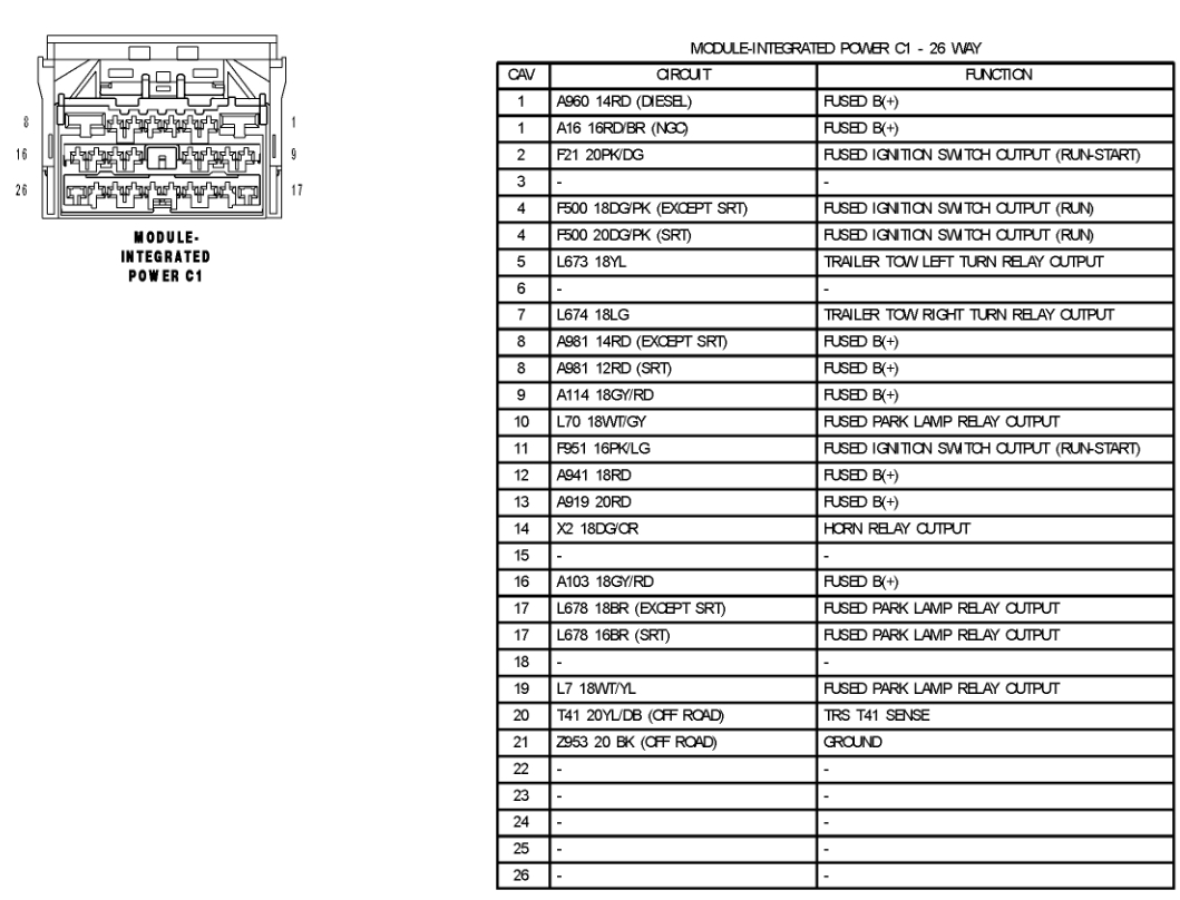

Sure, here you go. Check out the images (below). Please let us know what happens.

and I’m being a pain in the rear end, but I’m just trying to find out on what connector that OBD is on and since I believe fuse 51 is the one that controls the OBD, the remote keys the dome light in the radio or wrong number 51 does that give you the power even when the ignition is off so I’m just trying to find out where the power goes into the fuse box so I can trace that connector and end those wires.
I thought it was on connector one but I do see a pink and brown wire picking gray wire, but I can’t look at that paper you sent me can’t decipher if it’s on that connector. Would you be able to tell me where that wire runs to so I can check out that connector because even with the keys off my headlights turn signals, they all work, body lights work, and when the key is on, then I have the power to the power locks the remote unlock. I have the interior lights I just don’t have the radio or the OBD too so I just need to know which wire go which wire goes to the fuse box that has constant power when the car is turned off and maybe also would wire the radio go goes to.

I have the pinout diagram for my truck when I read the index and it says C one would that be for the connector that goes under the fuse box?
Feb 23, 2024 at 1:34 PM

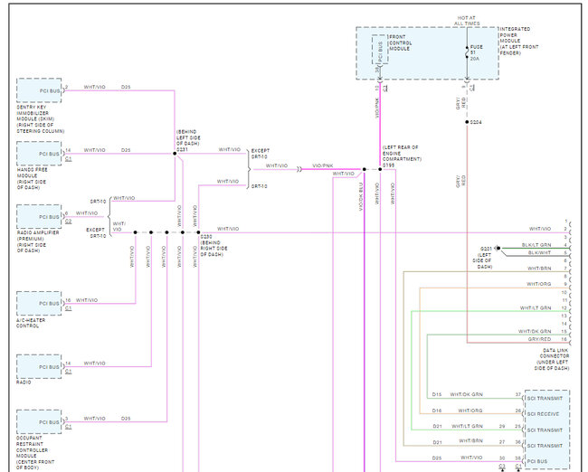

Do you have power at fuse 51? That is the fuse that runs the data port. Here are the wiring diagrams for the connector so you can see how it works. Also, check the ground as well on the left side of the dash. Let's see if we can get the scanner to work, it sounds like the IPM is bad to me.
Feb 24, 2024 at 9:10 AM
HRDHATDIVR
  • 12 POSTS
yes, I have power at a fuse 51 that is why I want to know if that fuse for 51 is wired into the C1 connector is that way I could check that I can check that connector.
Feb 24, 2024 at 10:36 AM
Sure, on the C1 connector it is #9 gry/red wire.
