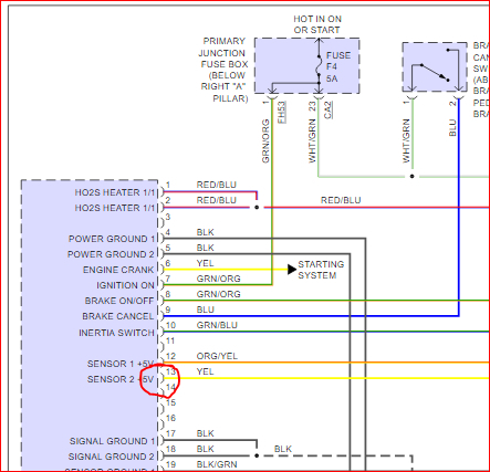

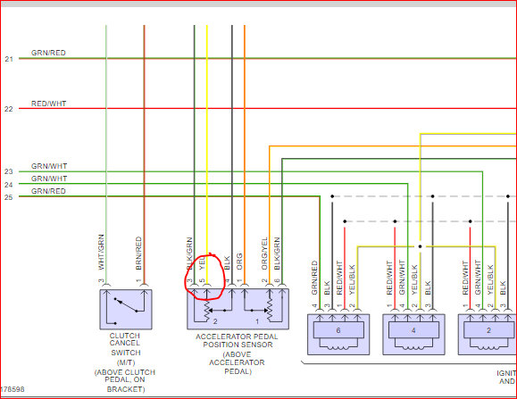

1. A pin was broken from the wire harness that plugs into the ECU.The wire that is attach to the broken pin is a little yellow wire. Can this prevent the vehicle from revving or accelerate? Also,do you know how to remove and install a new pin?

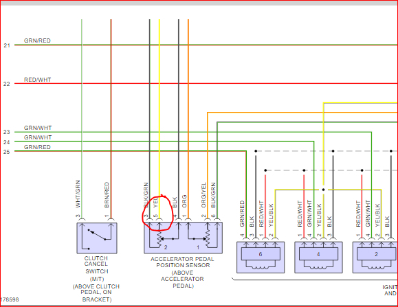

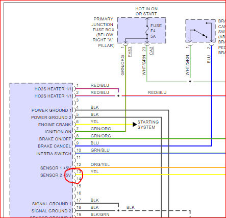

Yes, I've attached pictures of the wiring diagram and the yellow wire connects from the PCM to the accelerator position sensor.That would cause the accelerator to not rev/accelerate.You will have to get a specialty pin removal tool to take the connector out of the harness. After removal you will need a specialty connector and crimping tool to make the connection. Then put back into the harness. Here is a wiring tutorial for you:

Hello, just want you to know that the car is now accelerating or revving.Thank you for all your help.
