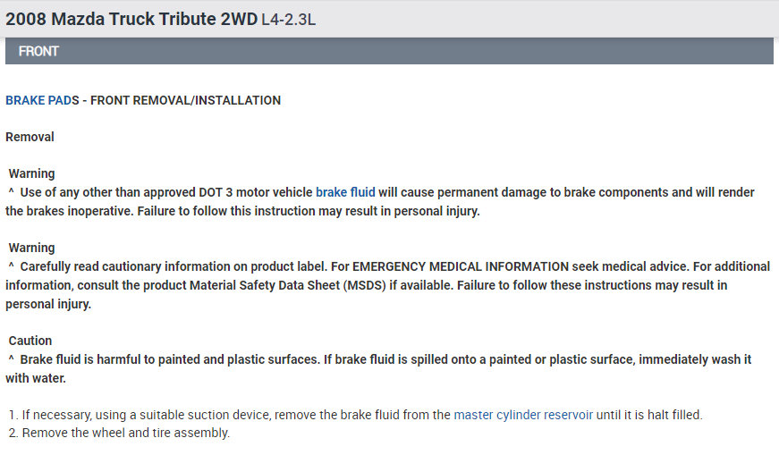

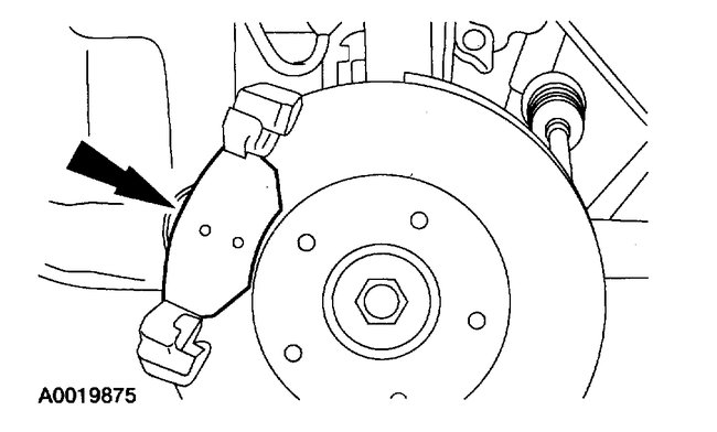

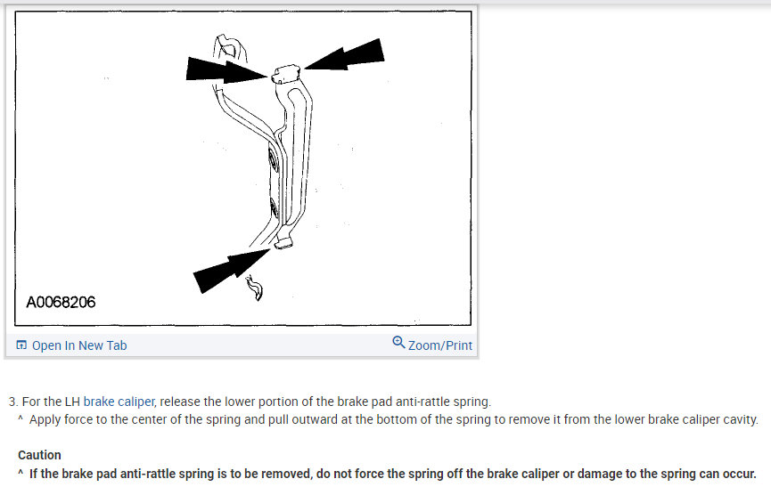

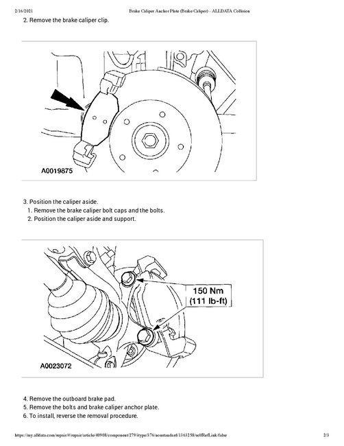

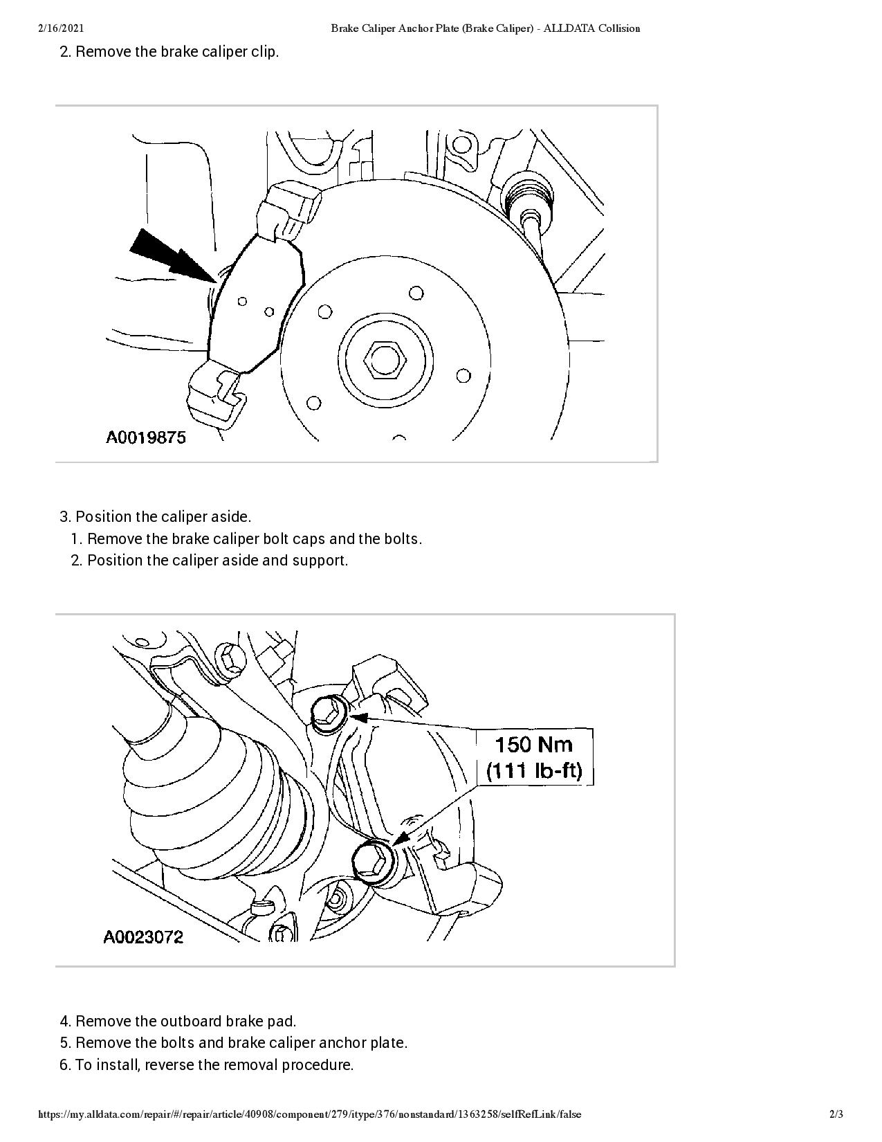

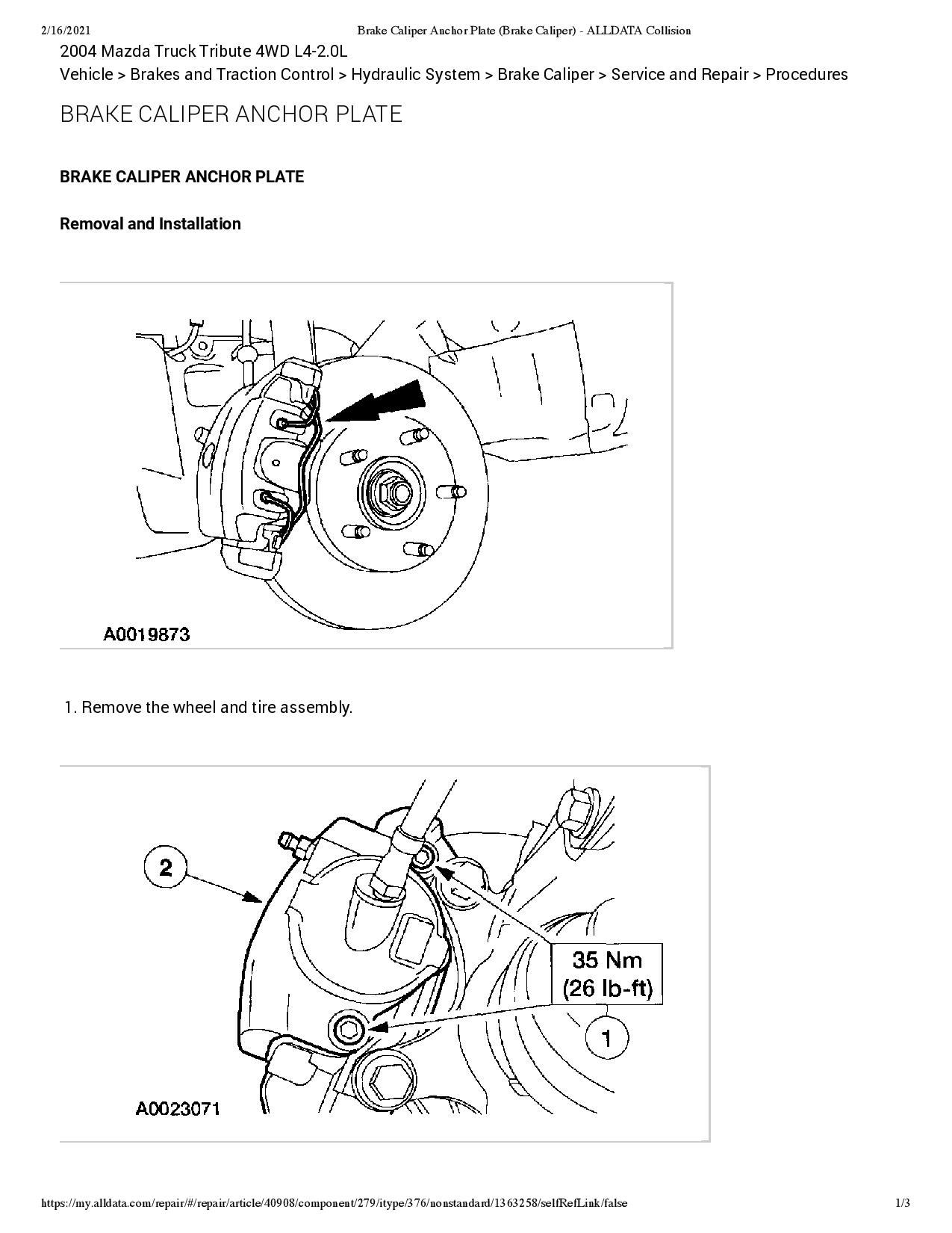

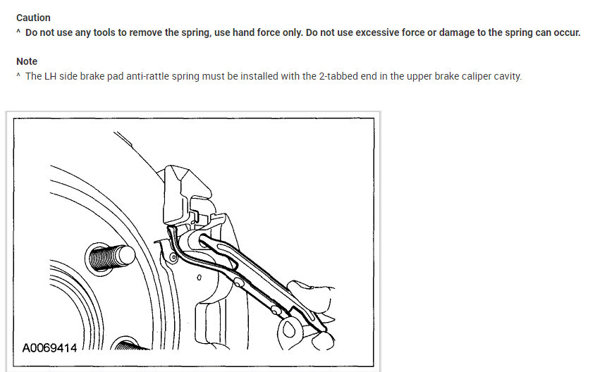

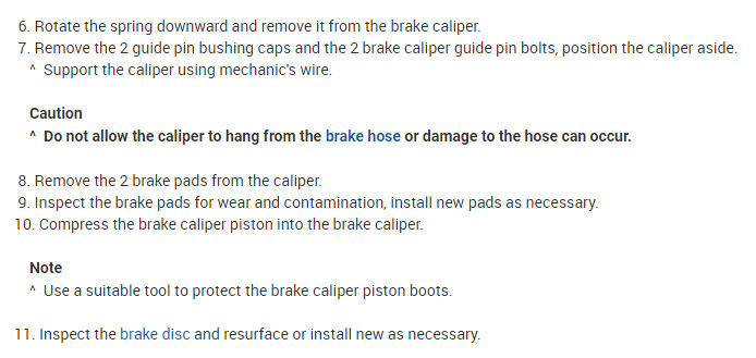

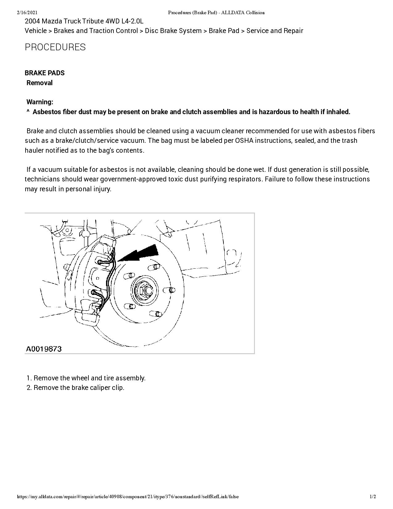

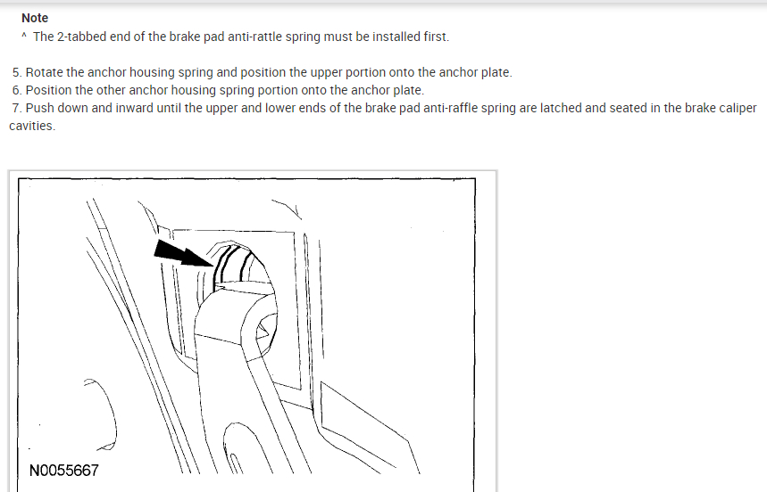

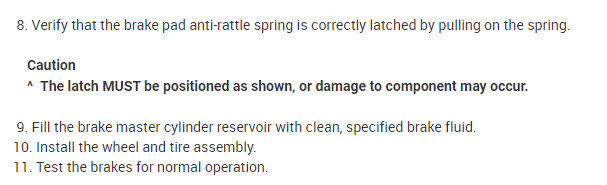

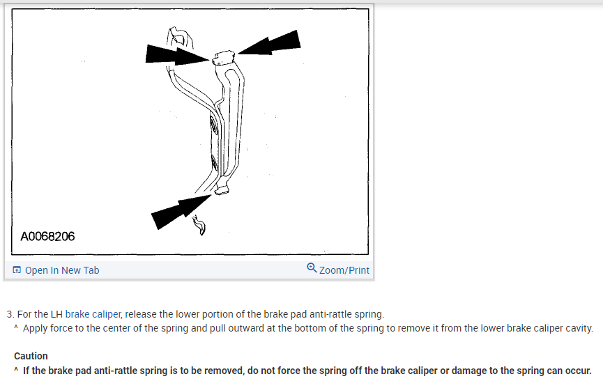

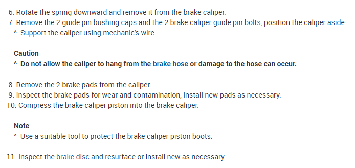

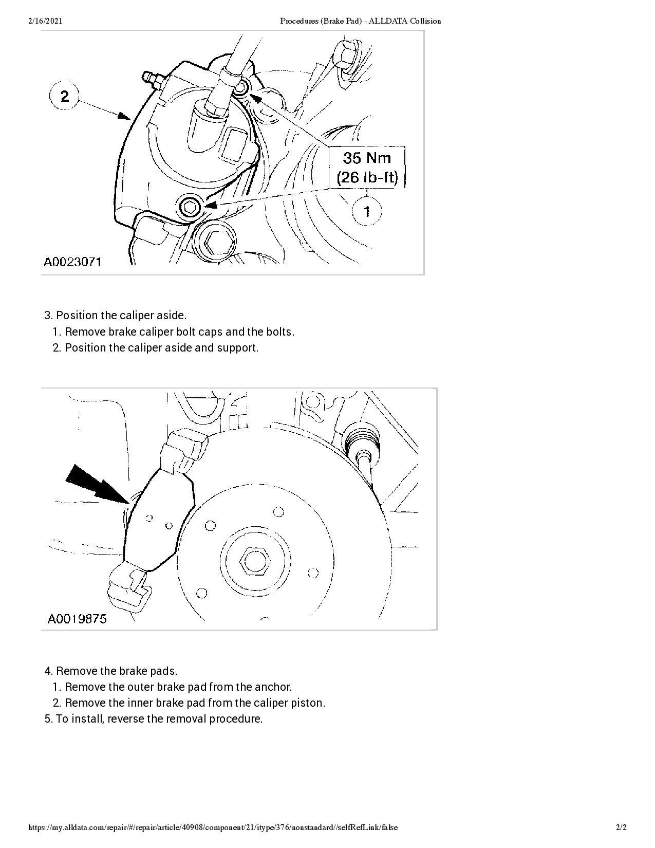

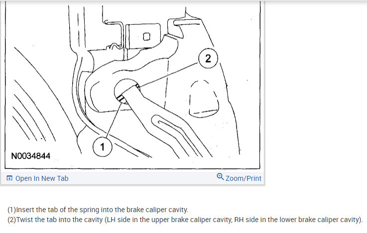

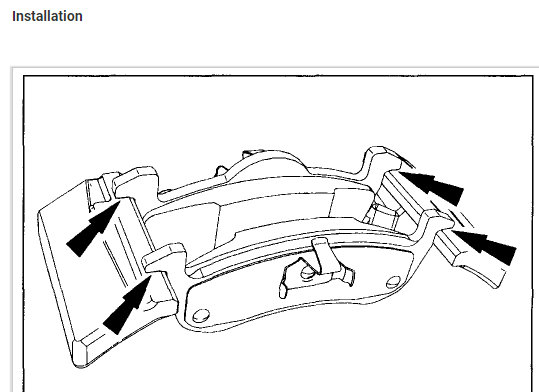

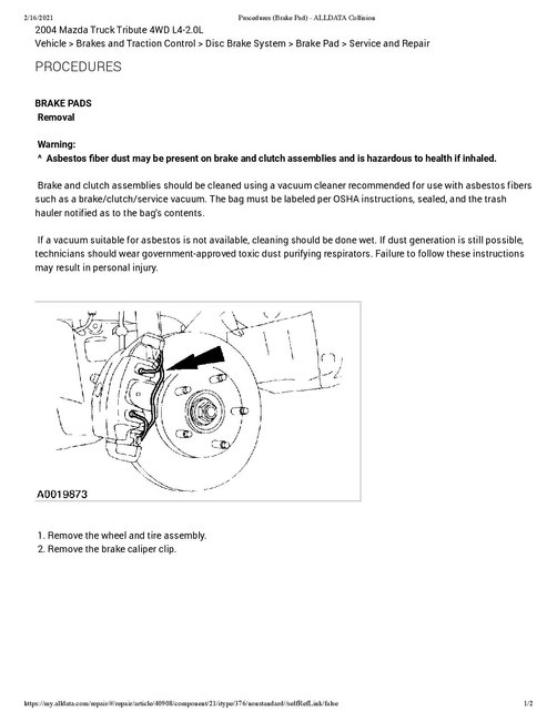

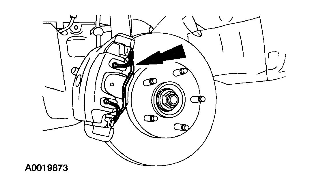

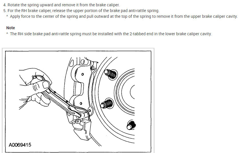

Here are the directions specific to your vehicle. The attached pics correlate with the directions.
________________________________
2005 Mazda Truck Tribute 2WD L4-2.3L
Front
Vehicle Brakes and Traction Control Disc Brake System Brake Pad Service and Repair Procedures Front
FRONT
BRAKE PADS - FRONT
Removal and Installation

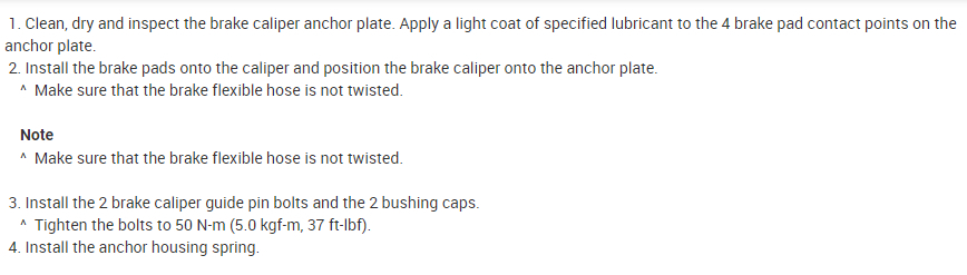

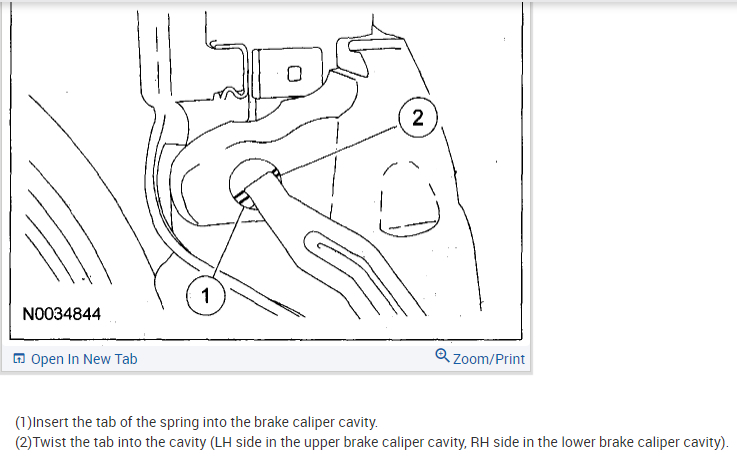

Pic 1
1. Remove the brake caliper clip.
2. Remove the brake caliper dust boot caps.
3. Remove the brake caliper guide bolts.
Caution: Do not allow the brake caliper to hang by the flexible hose.
Note: It is not necessary to remove the brake caliper jounce hose.
4. Remove the brake caliper from the anchor plate and support the brake caliper to the vehicle.

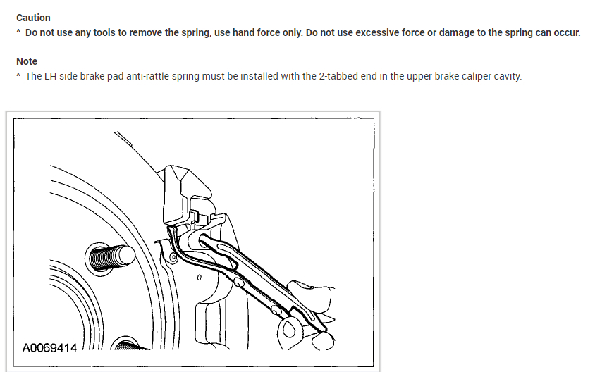

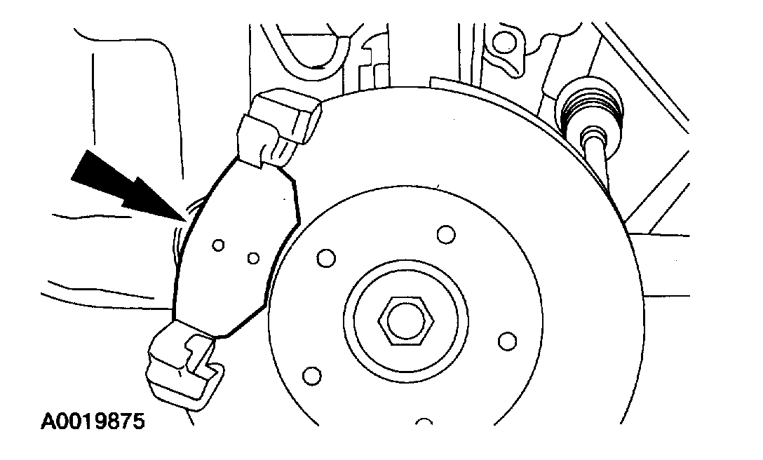

pic 2
5. Remove the brake pads.
^ Remove the outer brake pad from the anchor plate.
^ Remove the inner brake pad from the brake caliper piston.
6. To install, reverse the removal procedure. Lubricate the brake caliper guide bolts with silicone grease.

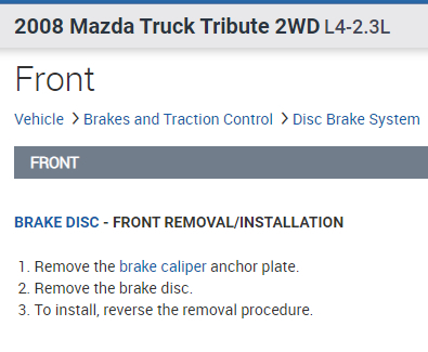

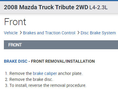

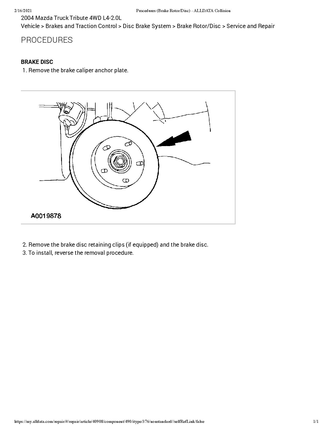

Rotor
Front
Vehicle Brakes and Traction Control Disc Brake System Brake Rotor/Disc Service and Repair Procedures Front
FRONT
BRAKE DISC - FRONT
1. Remove the brake caliper anchor plate.
2. If reinstalling the brake disc, reference mark the brake disc to the wheel hub studs.
3. Remove the brake disc.
4. Clean the brake disc and wheel hub mating surfaces of foreign material and debris.
5. To install, reverse the removal procedure.
