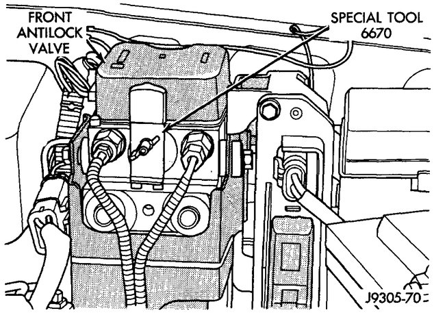

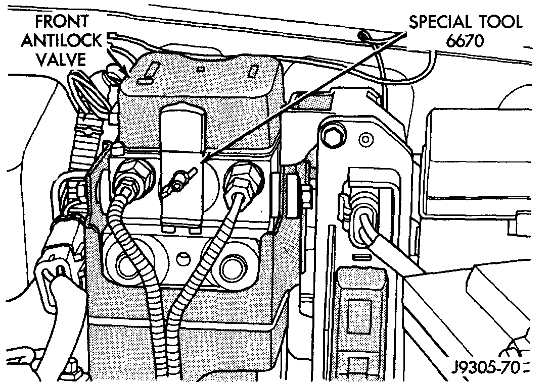

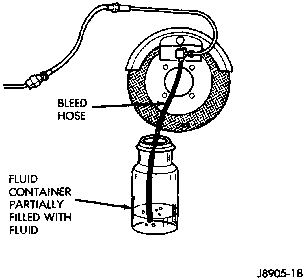

Here are the manufacturer's directions for bleeding the new MC and the brakes. See if anything has been done differently. The attached pictures correlate with the directions.
_________________________
1987 Dodge or Ram Truck Dakota 4WD V6-239 3.9L
Manual Bleeding
Vehicle Brakes and Traction Control Hydraulic System Brake Master Cylinder Service and Repair Procedures Master Cylinder Bleeding Manual Bleeding
MANUAL BLEEDING
Fig 2 Typical Fluid Container And Bleed Hose
pic 1
Fig 3 Front Antilock Valve Bleed Tool Installation
pic 2

- Bleed only one valve, or wheel brake unit at a time and use a bleed hose on each wheel cylinder and caliper bleed screw.
- Attach one end of bleed hose to bleed screw and insert opposite end in glass container partially filled with brake fluid. Glass container makes it easier to see air bubbles as they exit the bleed hose.
- Be sure end of bleed hose is immersed in fluid. Immersing hose end in fluid prevents air from being drawn back into cylinder and brake line.

11. On models with ABS, if a replacement front antilock valve and motor assembly has been installed, bleed new valve as follows:
a. Bleed valve stem must be held inward (in open position) to fully bleed upper section of new valve assembly. Use Bleed Valve Depressor Tool 6670 to press valve stem inward to open position.
b Remove cap from bleed valve stem. Then slide notched side of bleed tool onto boss that surrounds bleed valve stem.
c. Tighten thumbscrew on bleed tool just enough to push valve stem inward about 0.51 - 0.76 mm (0.020 - 0.030 in.).
d. Bleed new valve assembly at each brake line fitting one at a time. Surround line fittings with shop towels to catch fluid.
e. Remove bleed tool and install cap on valve stem.
12. On models with ABS, if original front anti- lock valve assembly is still in place, bleed valve does not have to be held open with tool. Bleed valve assembly at each brake line fitting one at a time.
