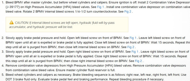

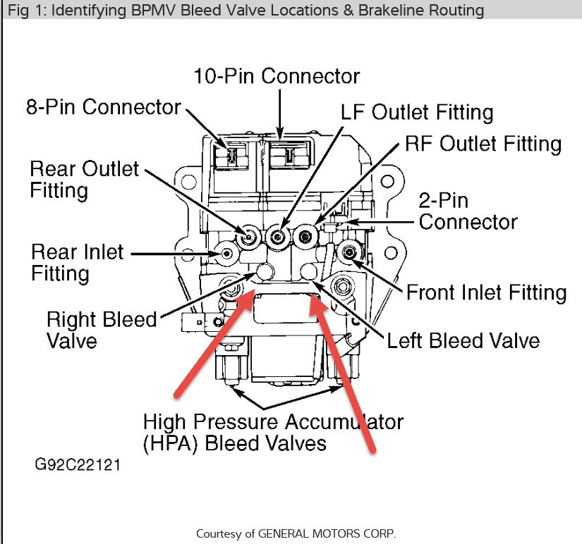

Good morning.
Do you have ABS? If you do there is a bleeding procedure you must follow.

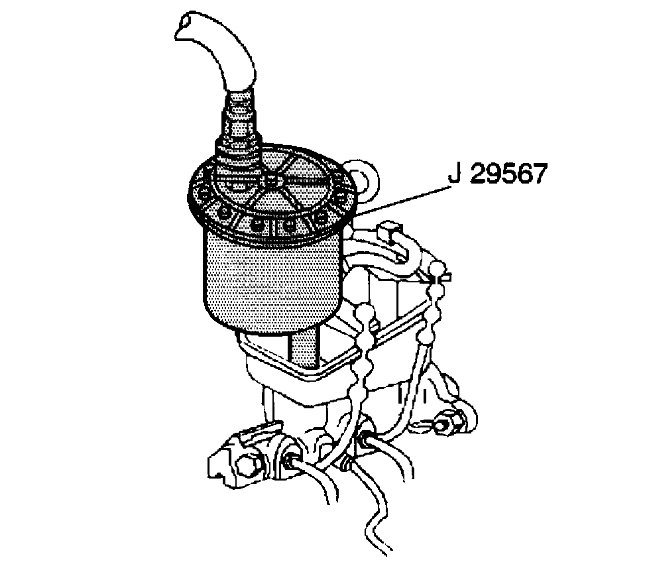

J-29567 Brake Bleeder Adapter (Plastic Reservoir)

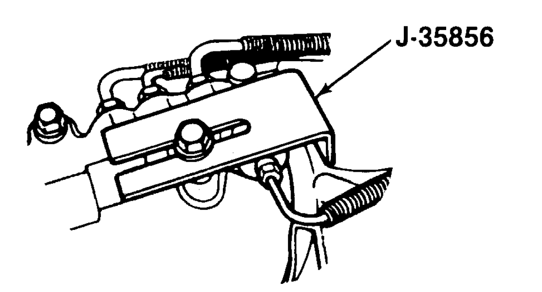

J-35856 Combination Valve Depressor
Note: It is very important that the correct master cylinder bleeder adapter be used to avoid possible damage to the master cylinder reservoir.
imageZoom/Print
1. Fill the pressure tank at least 1/3 full of brake fluid. The bleeder must be re-bled each time fluid is added.
a. Charge the bleeder to 140 - 170 kPa (20 to 25 psi).
2. Use J-35856 to depress and hold the valve stem on the combination valve during the bleeding operation.
imageZoom/Print
a. Install the bleeder adapter so the leg with the release valve is towards the cowl.

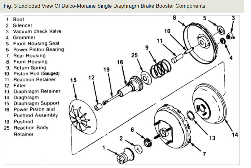

I just replaced the master cylinder and bled the brakes, but now I have brake pedal with the engine off but when you start the truck the brake pedal goes to the floor.
I'm thinking there is a problem with power booster. Just wondering if I am on the right track. Any help would be good.
thank you in advance
Jun 1, 2021 at 10:53 AM (Merged)
MERLIN2021
  • 17,250 POSTS
I have seen where the brake booster valve fails causing the brake pedal to go to the floor when the engine is running. So you are on the right track.
This guide can help as well
https://www.2carpros.com/articles/brake-pedal-goes-to-the-floor
Here are some guides to help you.
Cheers
LOBO55707
Yep that was the problem I got a new new and the brakes have never been better.
