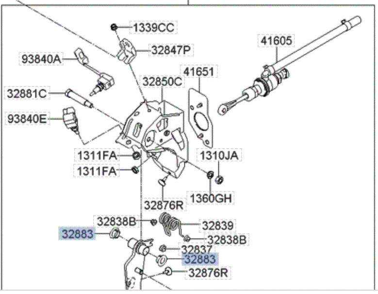

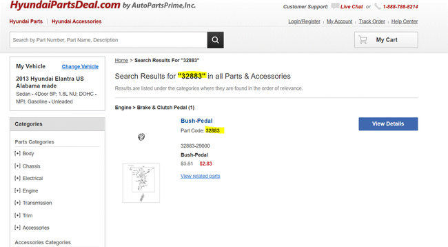

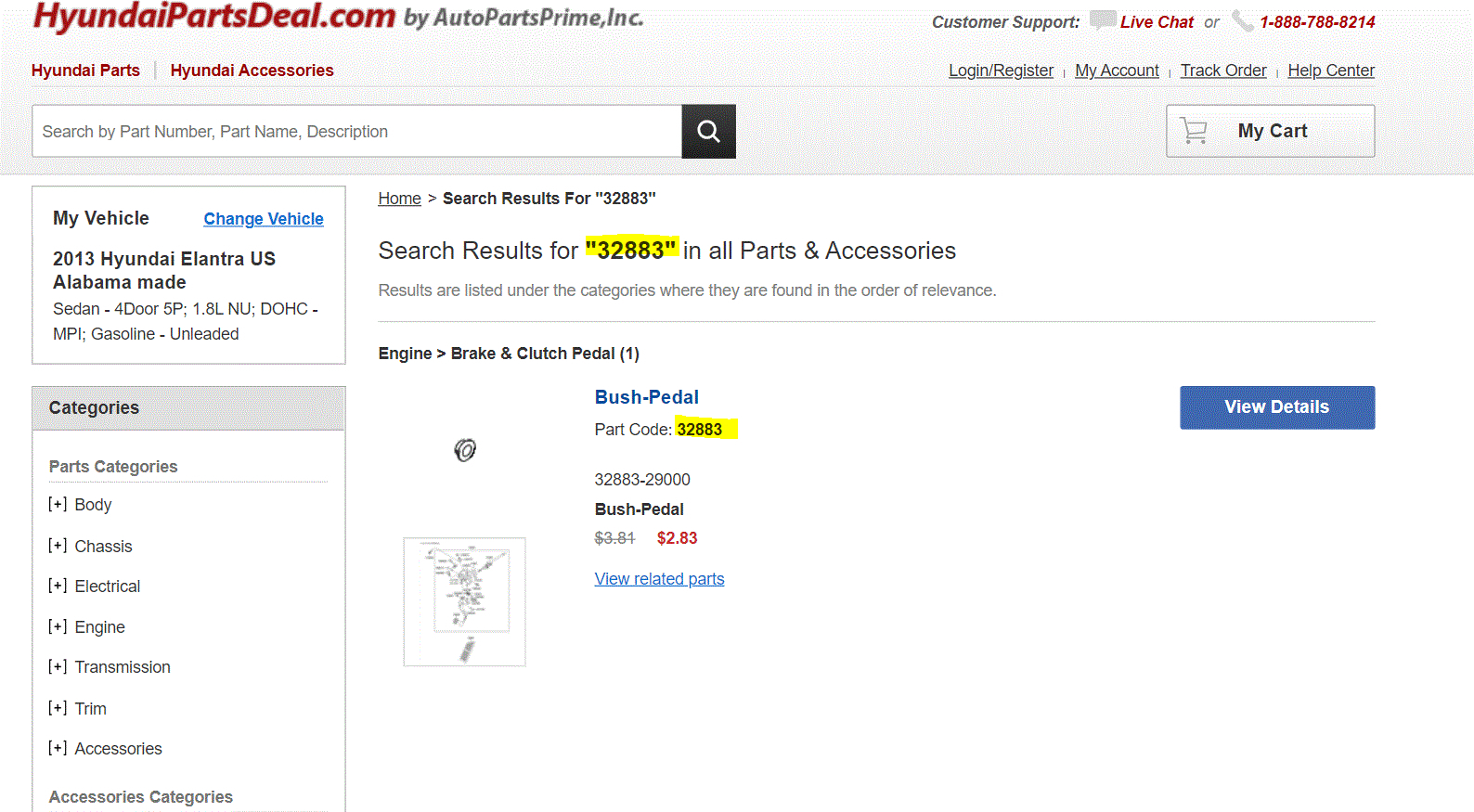

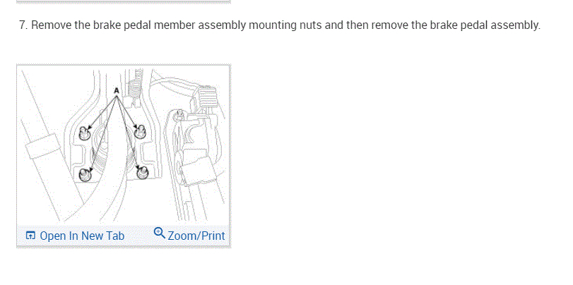

The bushing OEM part number is 32883. Go to Google and type in Hyundai Elantra OEM part number 32883. It will bring up the parts you need.
I attached a pic below showing them in the pic and from an at random. I would recommend getting one from a dealer since they are not expensive.
However, if you want, have the parts store cross-reference their part number with the OEM part number I mentioned. If they cross, what they have will work.

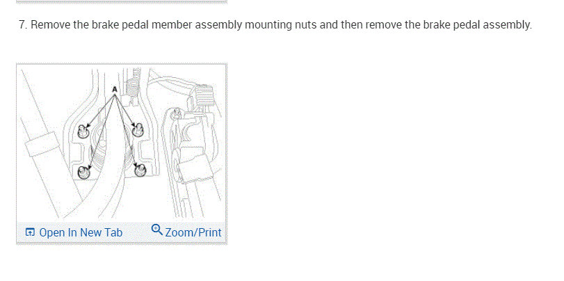

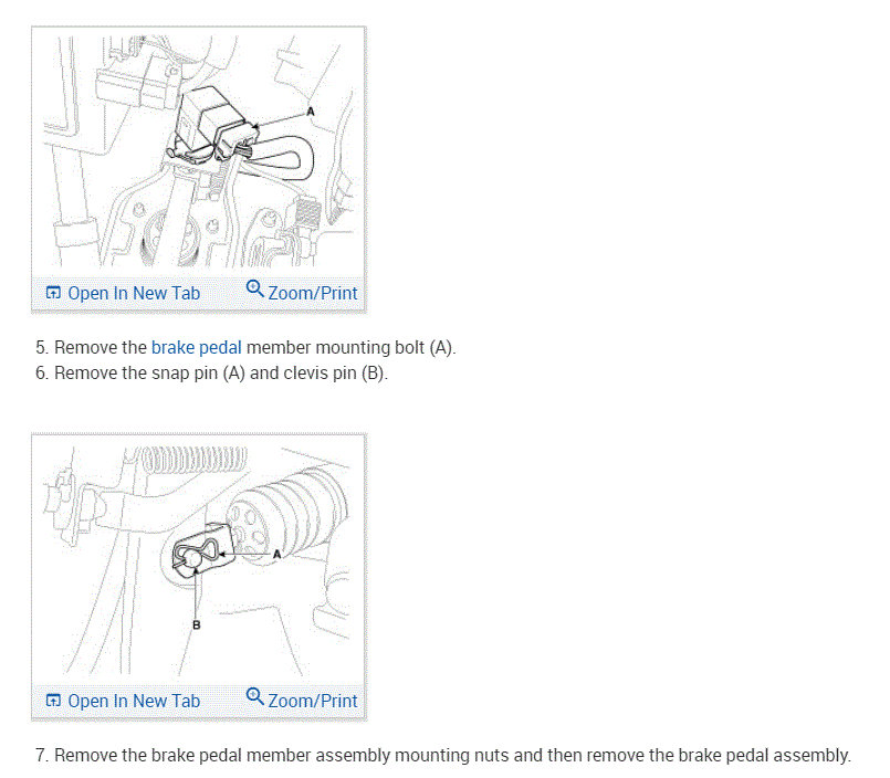

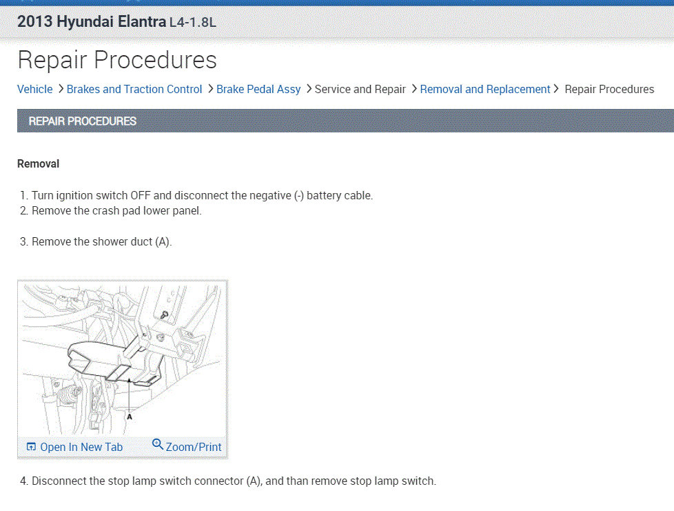

Let me know if this helps or if there is anything I can do to help you. Also, if you need to remove the pedal assembly, I attached the directions also.
Take care.
See pics below.
