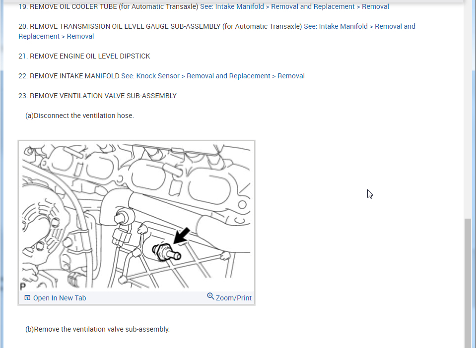

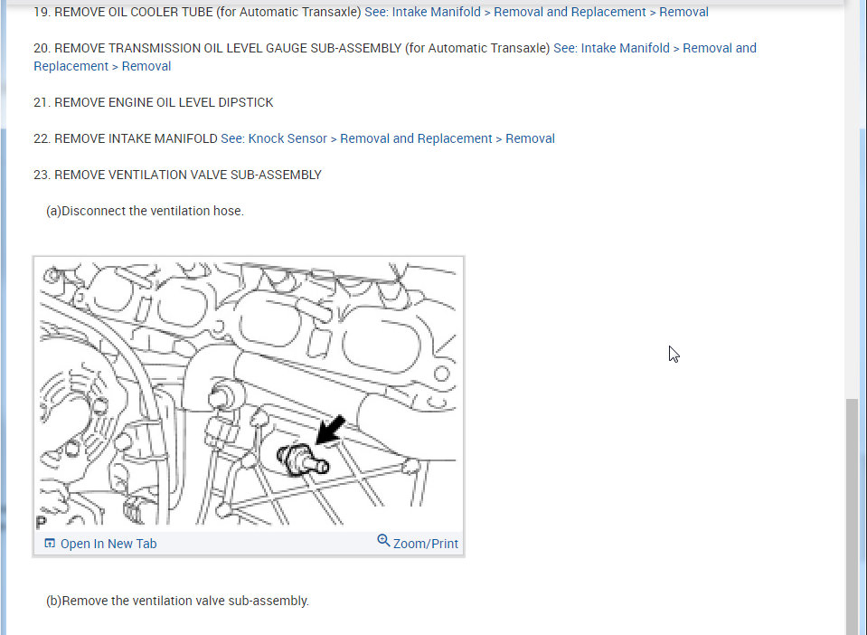

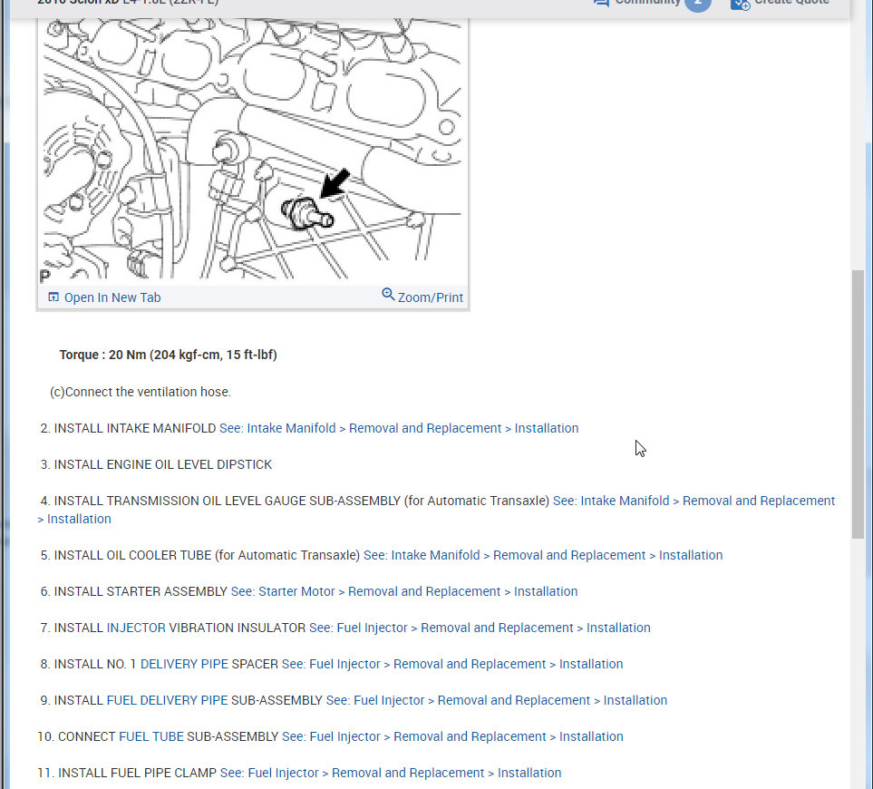

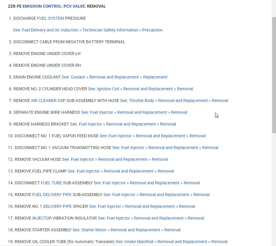

Thank you so much for your fast reply, I was hoping that i was wrong about the location, i have the same print out , but the year was 2008 Scion XD.. Don't understand why it is all the way down there, since most of the car i see was on top and easy located and replaced. Thank you for taking the time with me it will be all day project. I think i will have to get it started soon. Please take care and again, thank you for taking the time, Sir.
