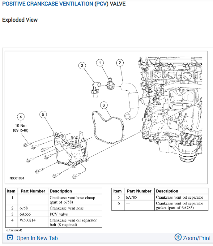

Hi, where is my PCV valve located? Ford Escape/Mercury Mariner Hybrid.
Thanks in advance.
Jun 17, 2025 at 4:12 AM
CERTIFIED EXPERT
53,854 POSTS
The PCV valve is below the coolant pipe on the right side on the engine, check out the images (below). Let us know if you need anything else.
