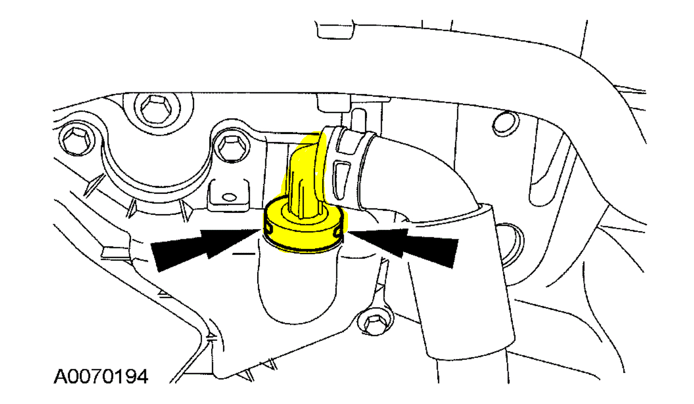

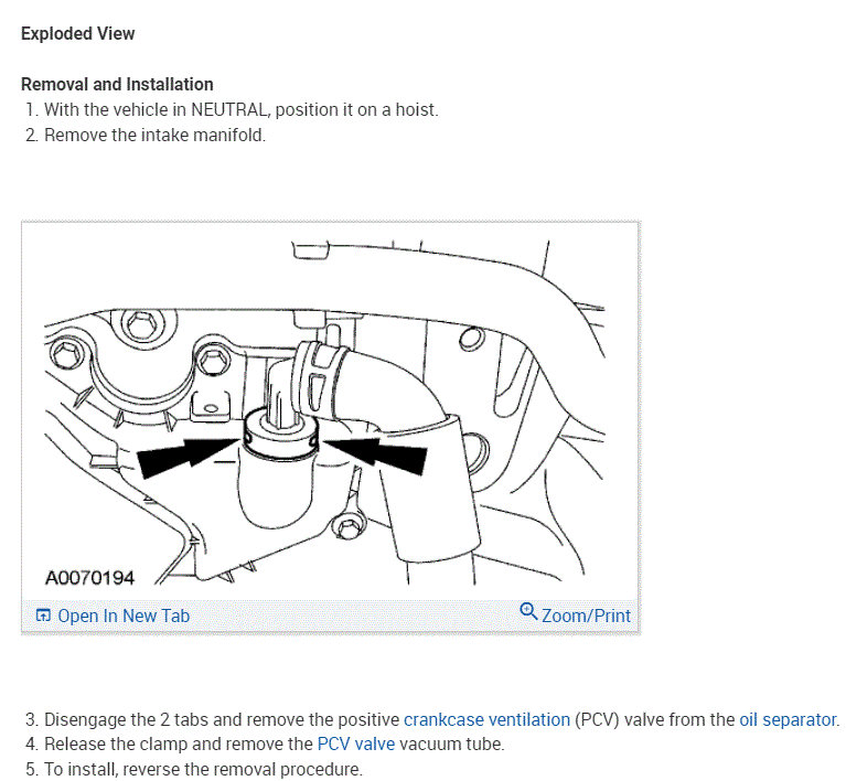

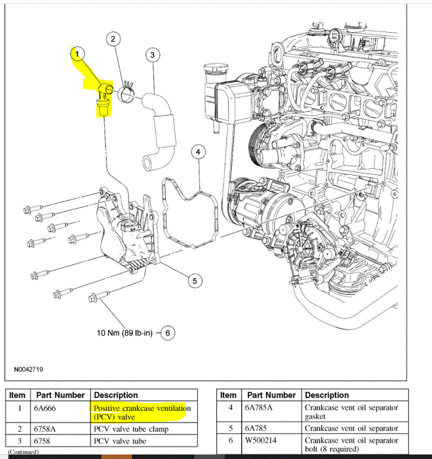

The PCV valve is on the side of the engine under the intake manifold rather than the traditional valve cover. To replace the PCV requires the removal of the intake manifold.
If you look at pic 1 and 2 below, they provide the location.
Pic 3 provided the directions for replacement.
