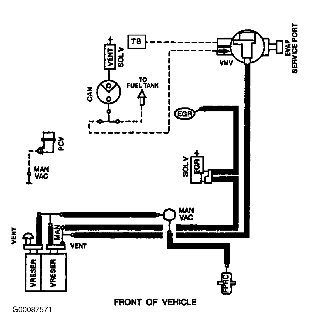

There is a vacuum diagram you should be able to figure it out with that.

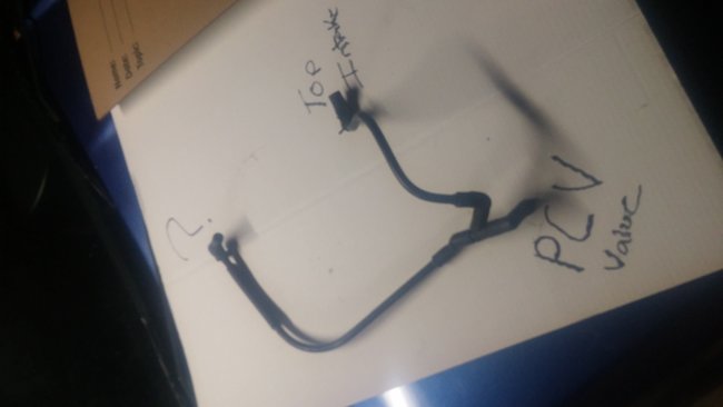

That diagram doesn't show the hoses coming off the pcv valve it looks like this (see image)

Do you have a hose missing to your EGR feedback sensor
