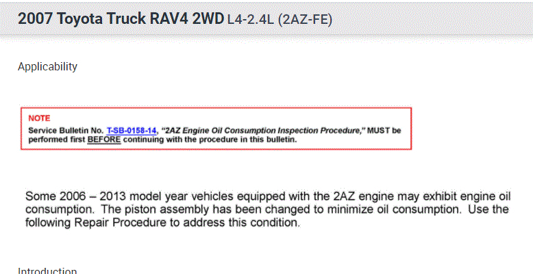

I feel he is wrong as well. I can't remember for sure, but either there was a recall or a notification related to this., They changed the piston design to repair the problem.
I was able to find the technical service bulletin regarding the problem, but you really should contact a Toyota dealer regarding this.

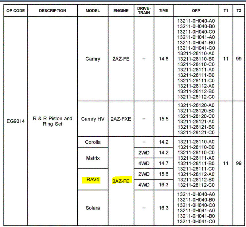

If you look at pic 2, it is a portion of the TSB. I wanted you to see there has been problems with this engine.
Here is an interesting thing. You had the PCV replaced and the issue went away for a bit. Also, you see no leaks or blue smoke from the exhaust. What happens is because of the design flaw, excessive pressure is built up in the engine crankcase. This results in oil vapors and oil to be forced through the PCV and reburned in the engine. The catalytic converter takes care of enough of the problem to prevent the blue smoke.
I hope this helps. Please feel free to let me know if you have any questions. Also, if you can let me know what the dealer says, I would appreciate it.
