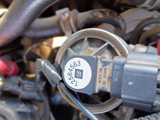

is this it because I can't find this part number online and it's the closest thing I see under my hood that looks like it

What kind of phone do you have? Also, this is the EVAP purge solenoid (purge valve) so this is what the code is for. I see a vacuum line that looks like it is taped? This will be no good, I would get a small piece of windshield wiper washer tubing at the auto parts store for the repair.

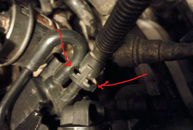

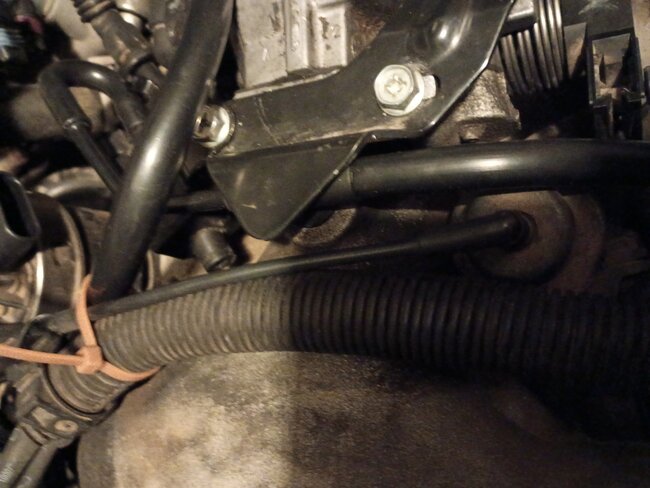

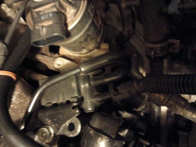

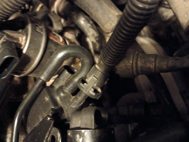

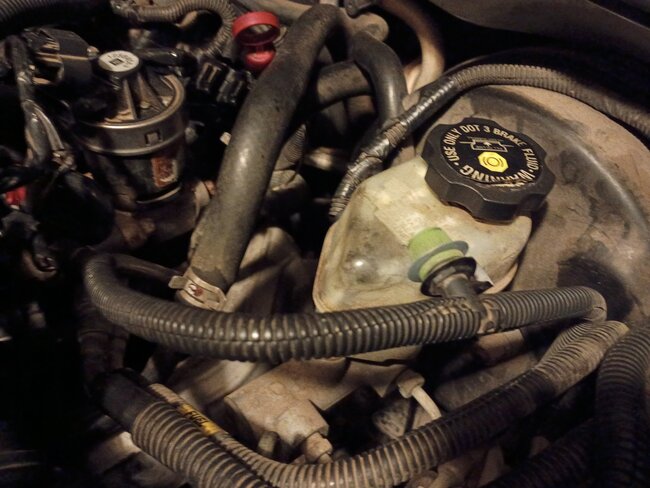

see this roundish plastic connector in pic #1 that connects to the pic #2 which is the part you said is likely the cause for code p0446 and then to pic #3with the green cap that has a black tag saying evap service port well Idk how to get this connector off and there's a open ended hole on the other end pic #4 is anything supposed to be there
Feb 1, 2026 at 5:03 PM
Yep, the lines look better. So the EVAP system needs to be 100 sealed, it cant have any leaks so please keep that in mind. Also, looks at the O ring seals inside the corrugated line on the solenoid. This video can show you how to check for leaks on the system.

how do disconnect the hard plastic connector to it tho
Feb 2, 2026 at 12:11 PM
WIMMS77
  • 12 POSTS
I don't need to track down a leak I need to change this part and can't figure out how to. get the evap connector off of it to do so
Feb 2, 2026 at 12:12 PM
O sorry, yes you squeeze the connector at the "loop" part this will release the connector without breaking it. Check out the images (below). Please let us know what happens.

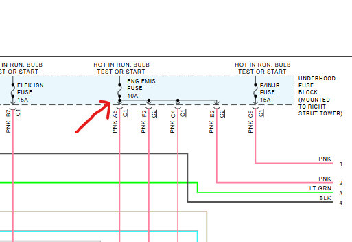

So you still have this code?
Code: P0446 - EVAP Vent System Performance / Vent Control Fault
Lets check the ENG EMIS fuse in the fuse panel under the hood. This guide can help
Feb 5, 2026 at 9:35 AM
WIMMS77
  • 12 POSTS
yes code came back after resetting it and driving it a lil bit but can a fuse go bad or fail and be bad even if it's not burnt inside
Feb 6, 2026 at 12:15 AM
Not really if the fuse is not burnt it is good. Can you check the gas cap seal, this is another point of failure for the sealed system. Keep in mind any leak in the gas EVAP system will cause this code as well.
