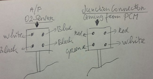

I replaced my two old o2 sensors recently with two new OEM (up and down stream) sensors. I however noticed a discrepancy in addition to having an 1157 obd2 code now. My new upstream o2 sensor has one white wire (i guess ground), one blue wire (i guess signal) and two black wires (heater). I measured 1.9 ohms across the heater. The colors on the junction connector coming from the PCM (and ultimately connecting with the o2 sensor connect-block), are different (2 red wires, 1 green and 1 white), which is cool, but the 2 red the wires coming from the car’s PCM are lining up with the white and black wire on the o2 a/f sensor and the green and white PCM wires line up with the black wires on the a/f o2 sensor connector block (please see sketch). I am confused, how can the 2 PCM red wires connect with the white and blue on the o2 sensor and the green and white with the black wires on the o2? Based on the way the colors are lining up, i need to conclude that one of the PCM red wires is a signal wire and the other red a ground wire, while the green and white wires would be for the heater? To me this does not make any sense? Can anyone explain this to me. Thanks.

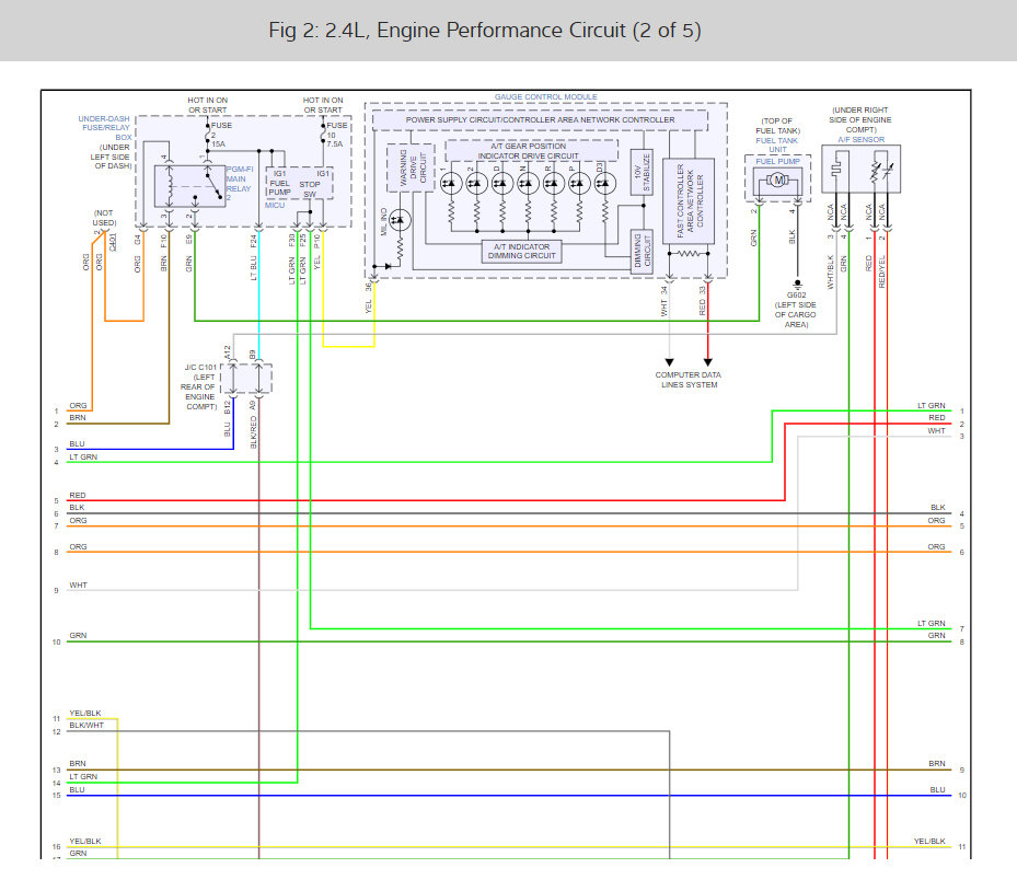

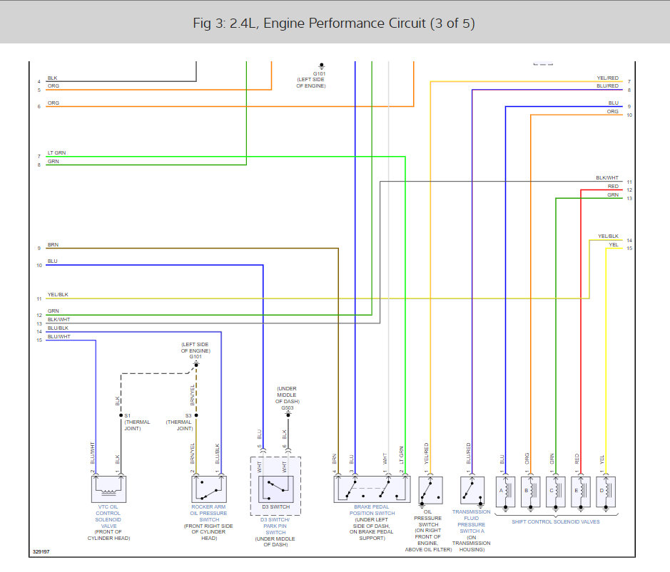

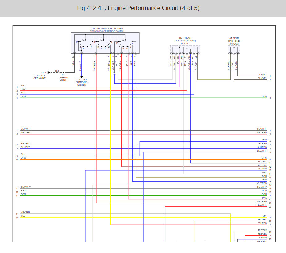

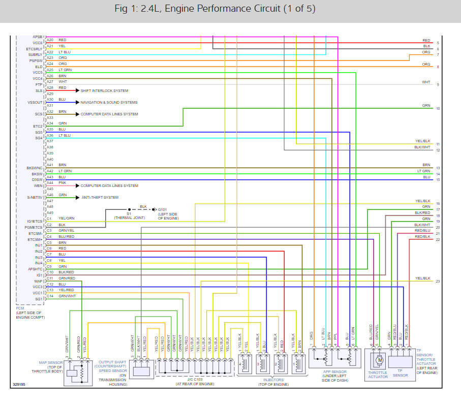

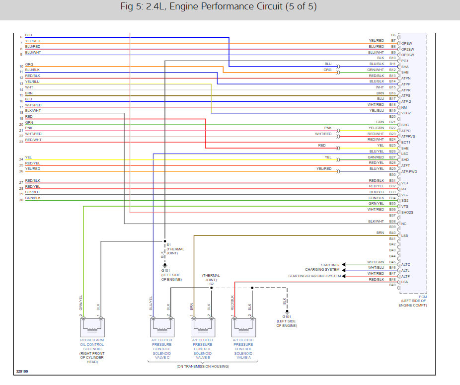

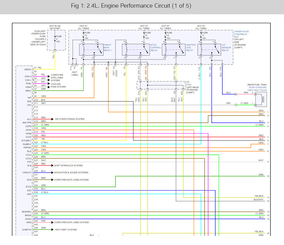

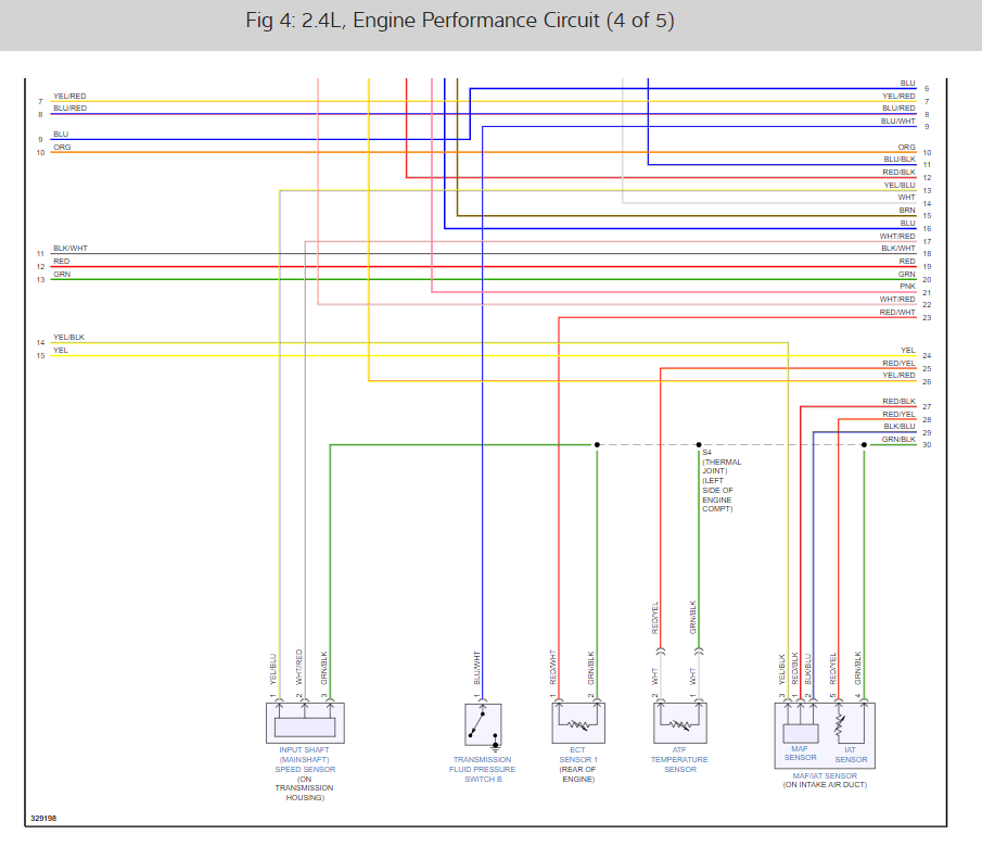

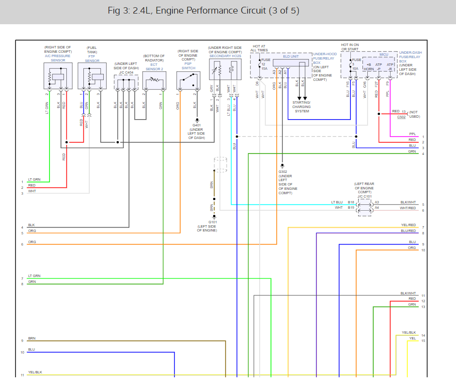

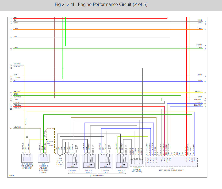

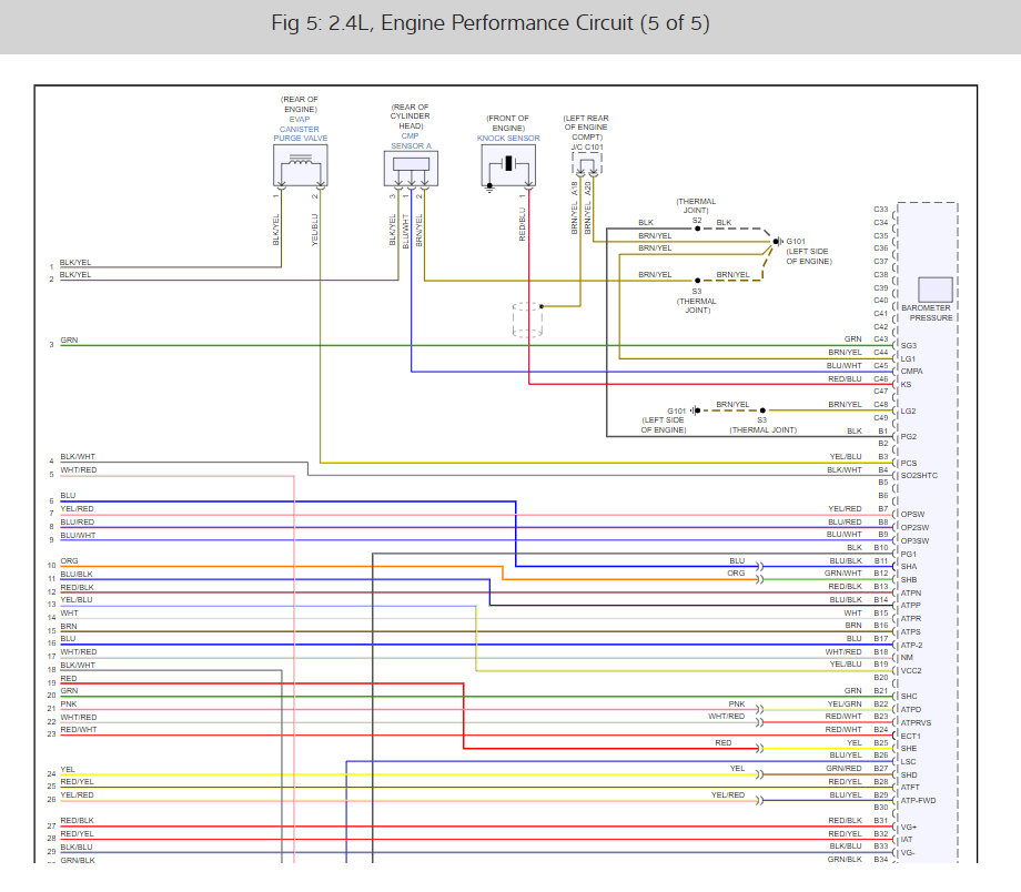

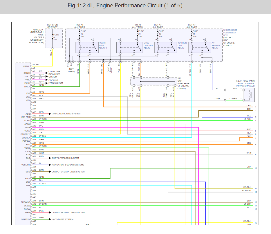

Hello and welcome to 2CarPros. The A/F sensor wires are always different from the actual engine wire harness side to simplify diagnosing. If you have a heater circuit fault, check fuse #11 15A if fuse is good then verify you have battery voltage at the white wire with black stripe. You need an assistant for this because it will only come on for a couple of seconds with key on engine off. Here is a guide to help check the wiring with the engine wiring diagrams below.
What I am concerned with is the ohms you measured. That is pretty low? A cold sensor should measure more like 12 to 16 ohms. Now my question for you and please do not take it the wrong way, did you install an oxygen sensor or an air fuel ratio sensor for the upstream (before the catalytic converter)? I ask because there is a big difference in price. If you installed an air fuel sensor then that sensor alone should have been around $200.00+ if it is an A/F sensor then I would say you got a defective one because of the low reading. I attached a wiring diagram for you. Check out the diagrams (Below). Please let us know what happens.

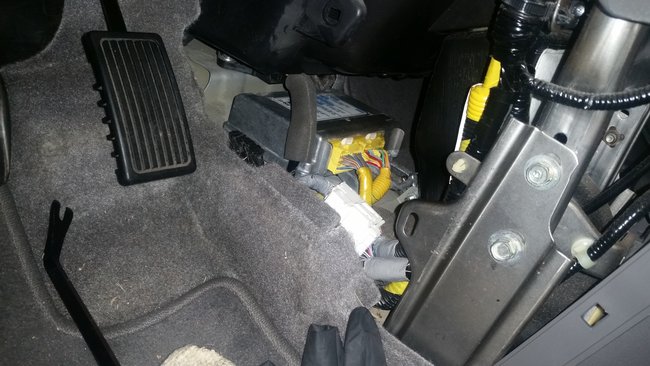

Okay great, thank you very much for your insight and thanks for the wiring diagram as well; the schematic helped me a great deal. Where can I get meaningful diagrams like the one you sent me if I may ask? I signed up with a site (free diagrams site), but the diagrams are limited in scope. Finally, a related question, I found another electrical box inside my car sitting on the floor behind my steering column, it almost looks like a mini PCM, what is this box about (see picture? Thanks
