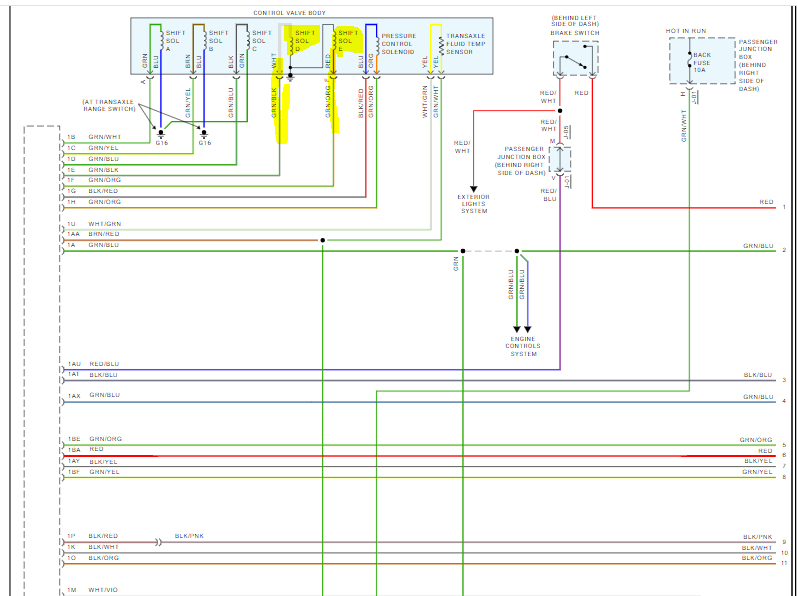

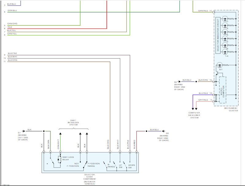

I need a to know the wire color or pin location for shift solenoid d and e. I can give you the VIN if needed.
Mar 17, 2024 at 11:52 AM

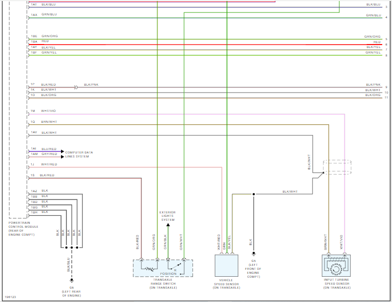

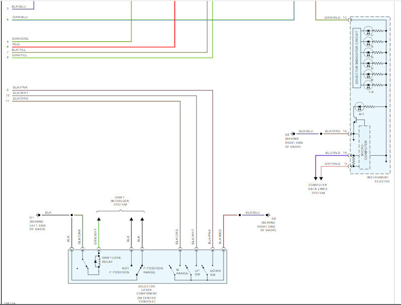

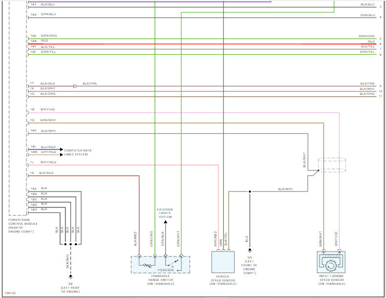

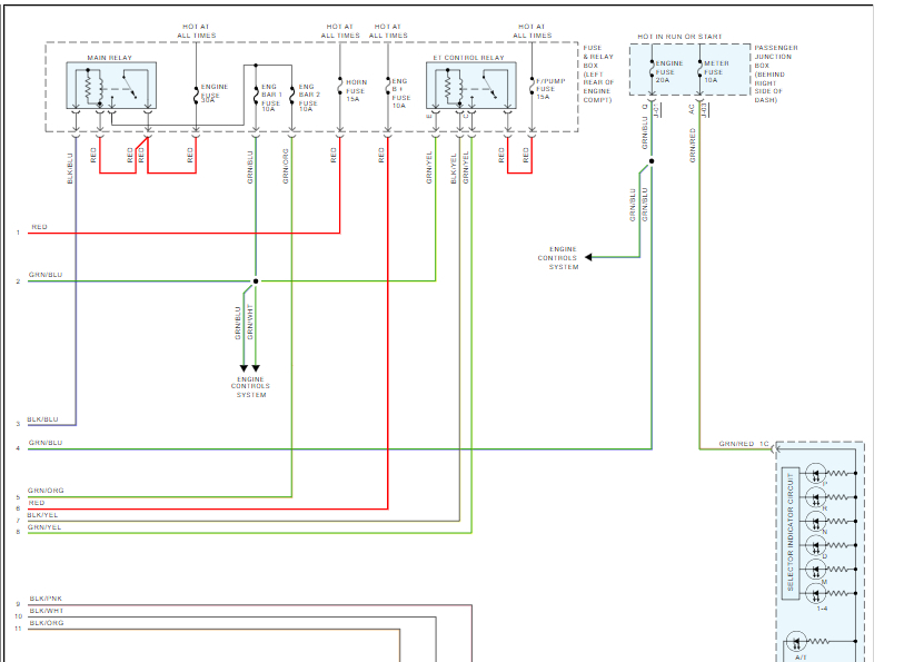

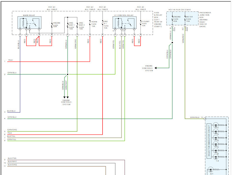

I attached the entire wiring schematic related to the transmission. I highlighted shift solenoids D and E (first pic below).
I tried to get you a pinout of the connector, but the manufacturer didn't provide that information.
The wire colors are looking for are as follows.
Solenoid D - green with a black tracer
Solenoid E - green with an orange tracer
Let me know if this helps.
joe
See pics below. Note: The schematic was two pages long. I cut each page in two so you could read them. I did overlap them so you can follow from one to the next.
