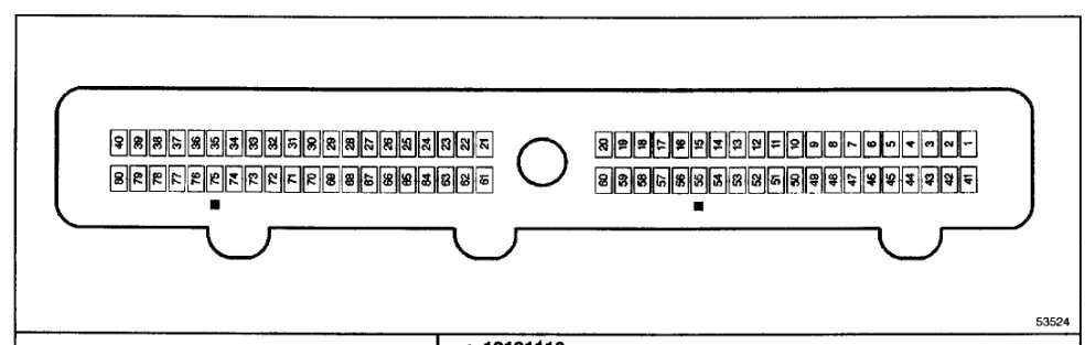

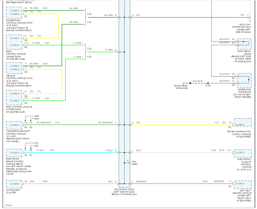

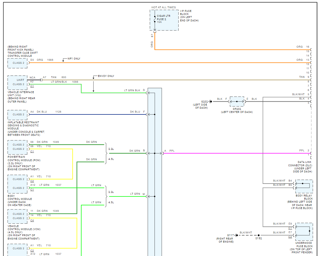

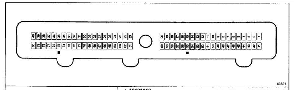

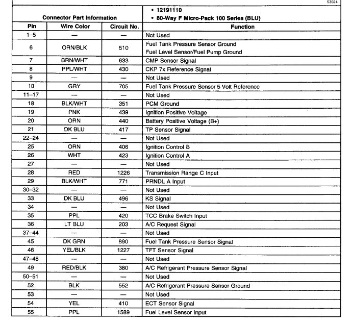

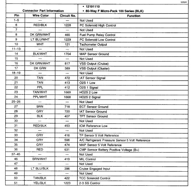

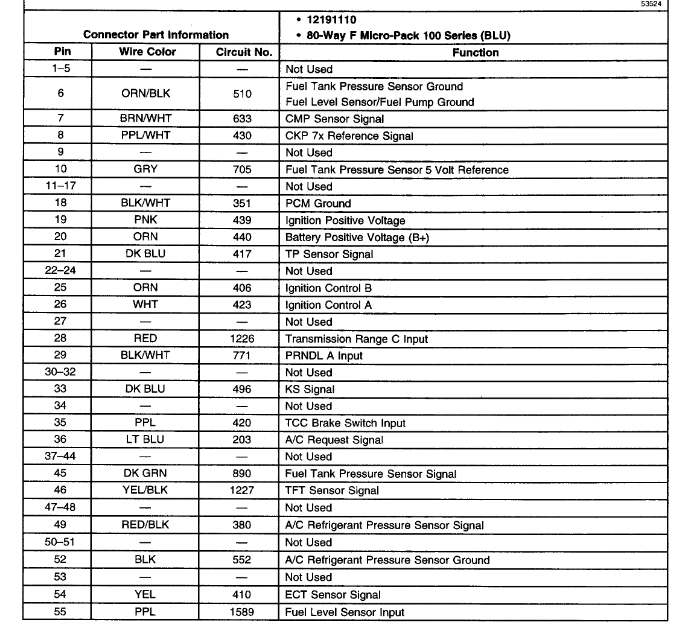

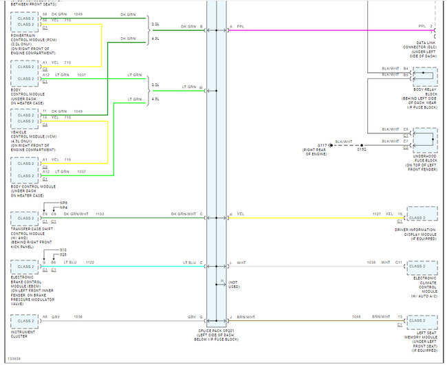

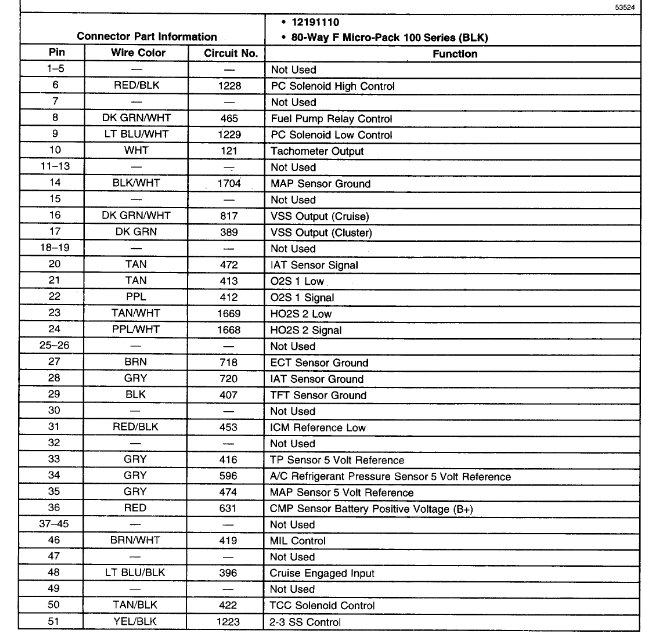

I need the pin out for the 16228016 PCM and maybe the obd2 port so I can get rid of vats and check engine lights from not having a catalectic converter. All I have been able to find is the PCM pin outs for the is PCM with the red and blue connectors? I have the blue and black connectors, and I am not putting an LS in my S10 thank you in advance...
Sep 23, 2024 at 4:51 AM
Okay, here is the blue and black ecm electrical connectors pinouts as requested, I also included the data link connector wiring as well. Check out the images (below). Let us know if you need anything else.
