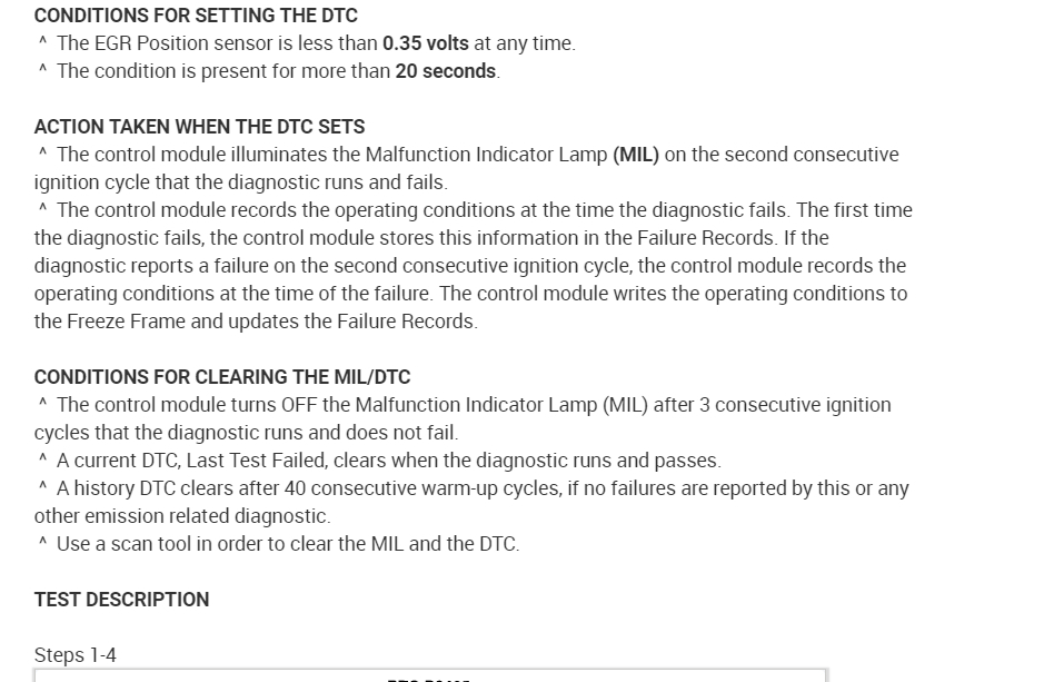

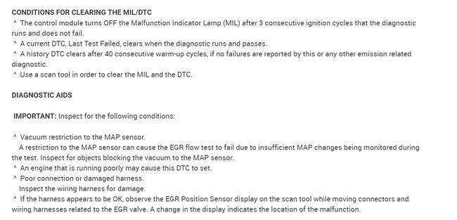

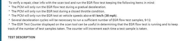

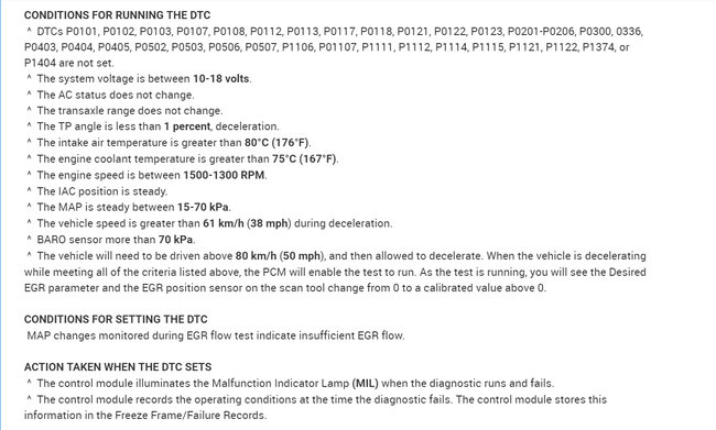

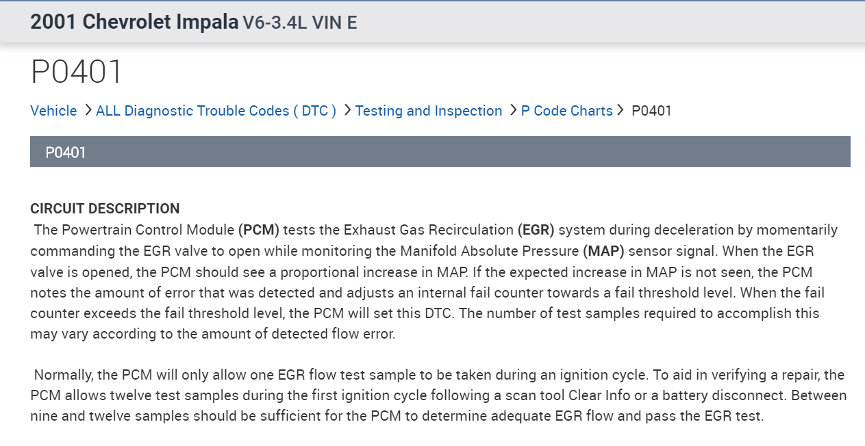

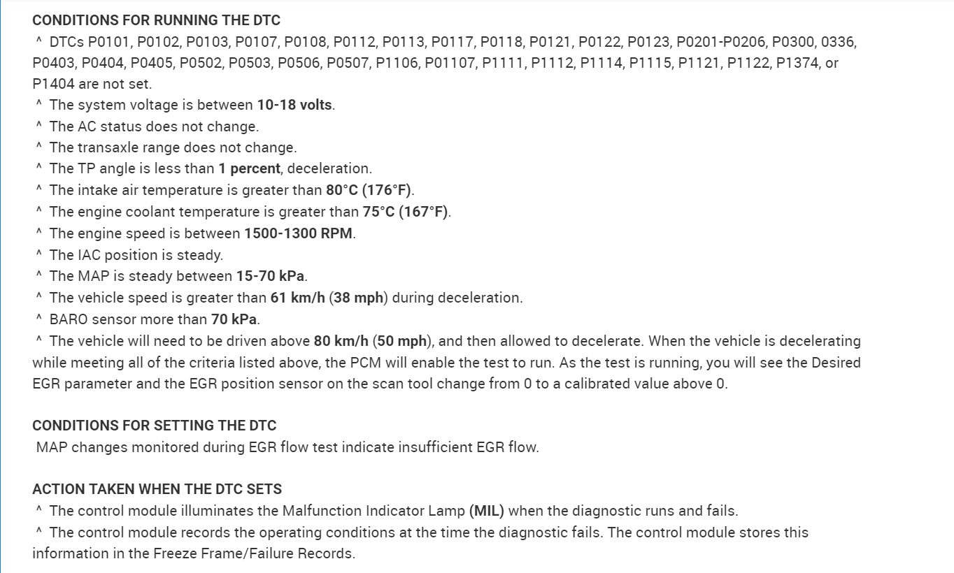

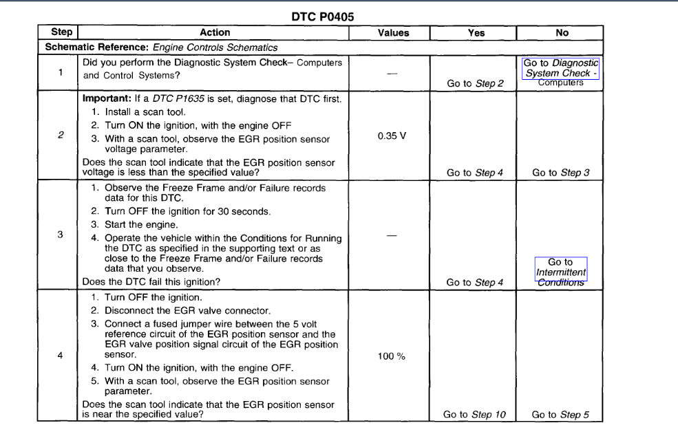

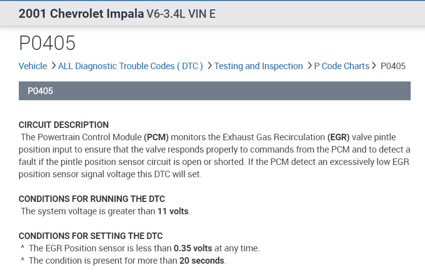

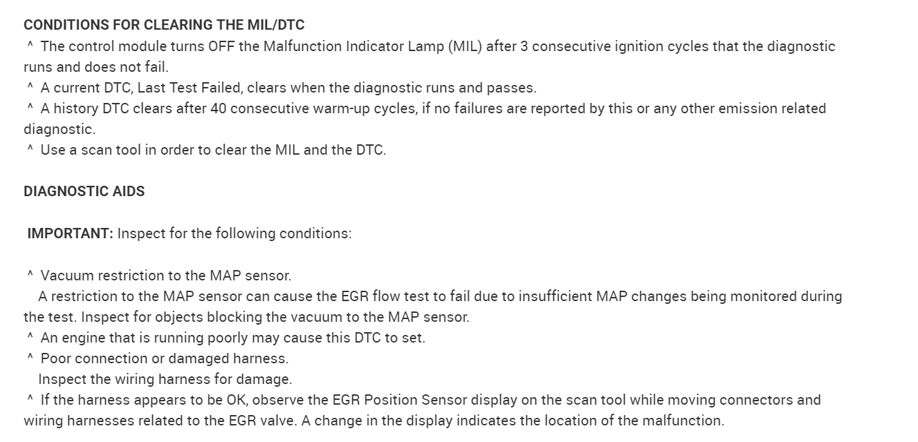

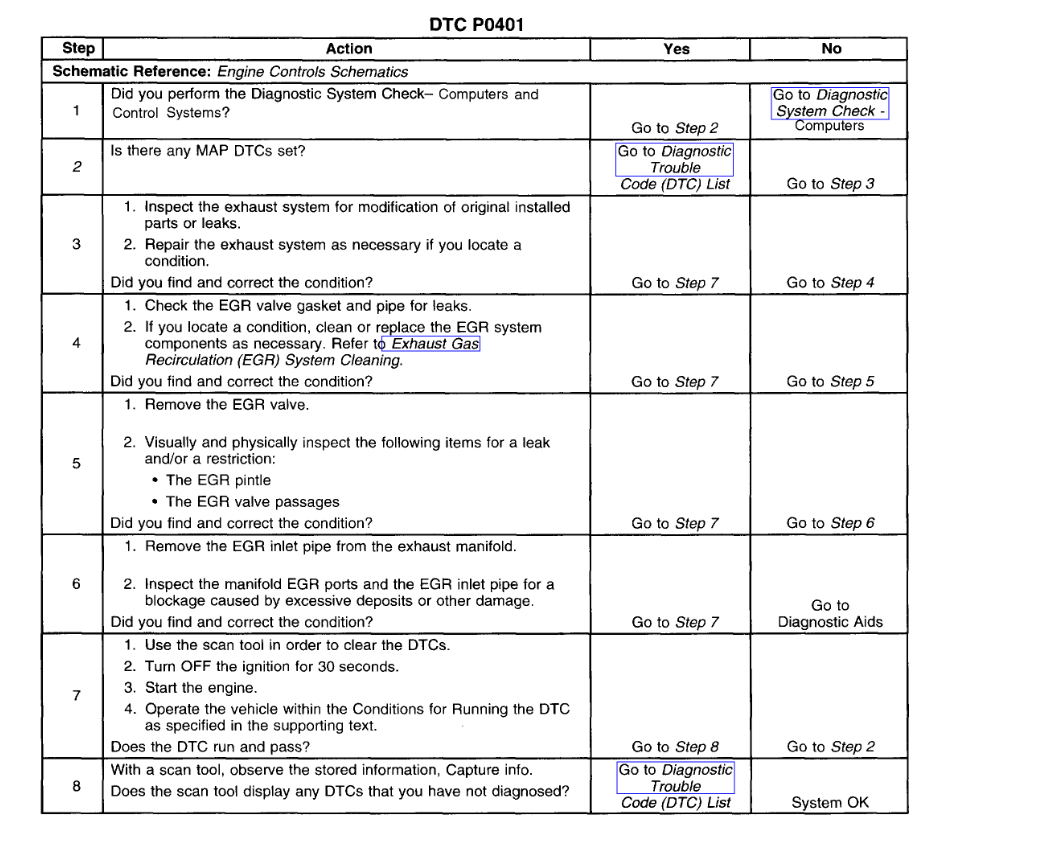

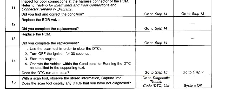

In the diagrams down below I have included the factory diagnostic troubleshooting guide for your vehicle for DTC P0401. Please go through this guide and get back to us with what you are able to find out.
Thanks,
Alex

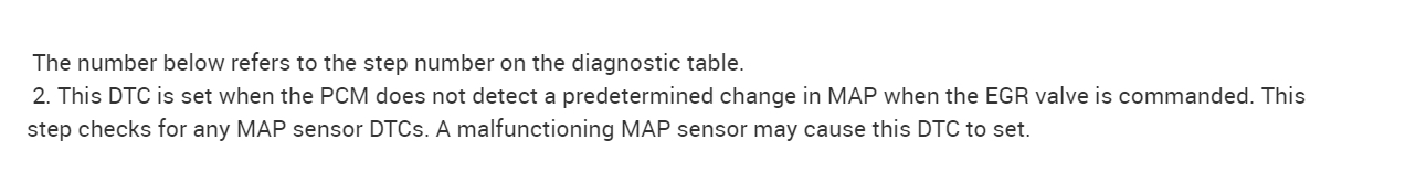

Thank you. I went through the diagrams guide you provided. I don't currently have any MAP specific DTC's. I could test the MAP sensor when I get the chance although it's likely that it's working correctly. All ports are clear of blockages and from what I can tell, free of leaks.
I took some more voltage readings while driving yesterday on the EGR position signal wire (C). When the computer should be commanding EGR my .79v should increase. Instead, I noticed that it's dropping down to a .6 to .7 range (it's not a steady .79 as I previously thought). A couple times it managed to drop to .5v. Does this sound like a ground fault? And where would I start? Battery terminals are tight. Could it be corrosion/loose connection on the wires feeding the PCM?

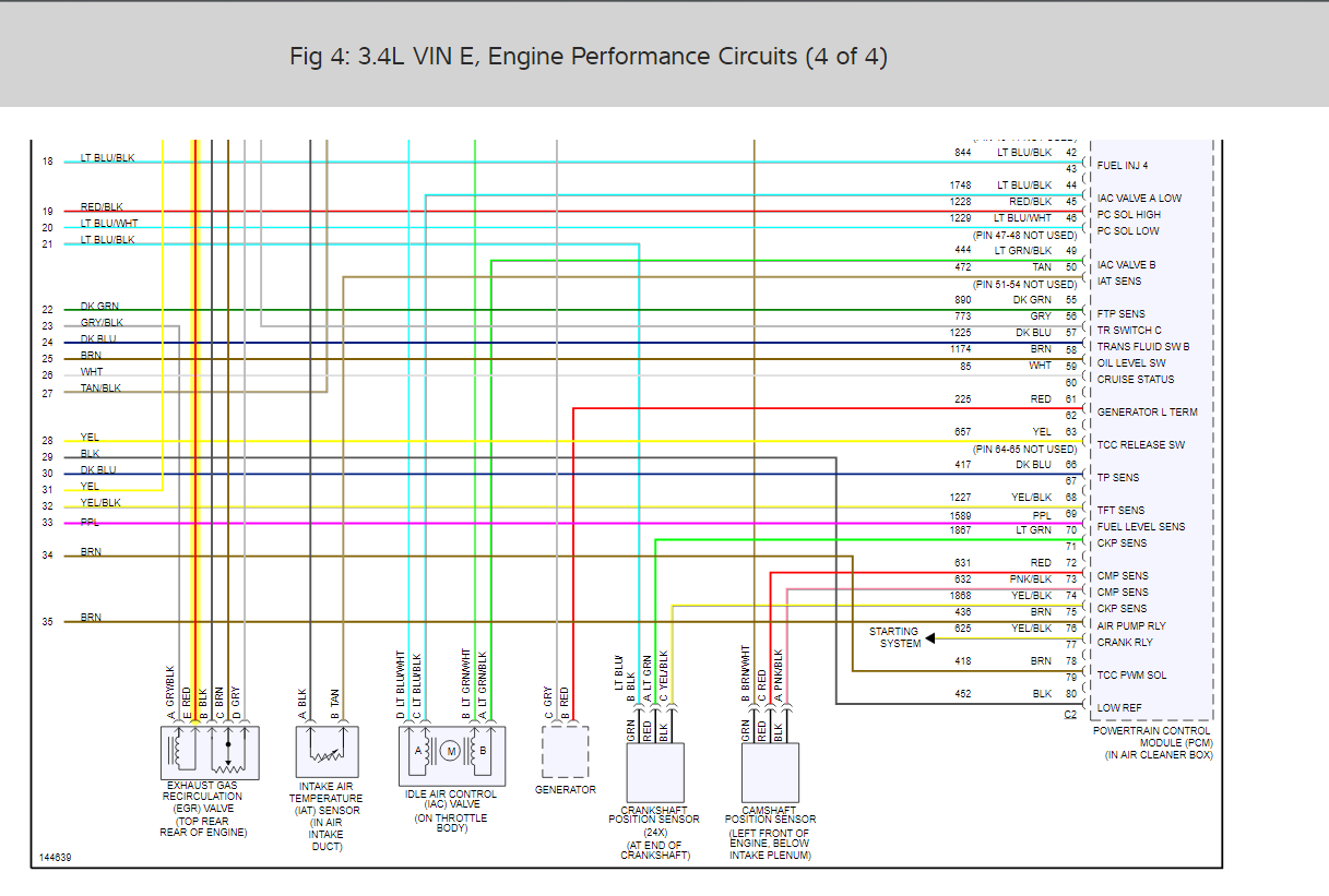

SCGRANTURISMO
  • 4,897 POSTS
Hello again,

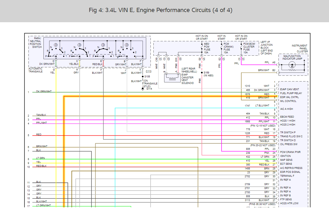

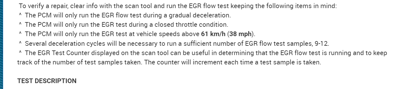

Pin E on your vehicle's EGR Valve connector is for the EGR Valve Control from the PCM and it is going to a coil inside the EGR Valve.(See the attached wiring diagram in the diagrams down below). If the voltage is dropping down to 0.2V, that is the PCM controlling the voltage output. Also, the previous guide for DTC P0401 is from Chevrolet for this DTC so follow the guide, and you will fix the problem. In it's description it states that it is not only the EGR valve, but the relationship of the MAP sensor to the EGR Valve on deceleration that is the problem. Please go through the guide and get back to us with what you are able to find out.
Thanks,
Alex

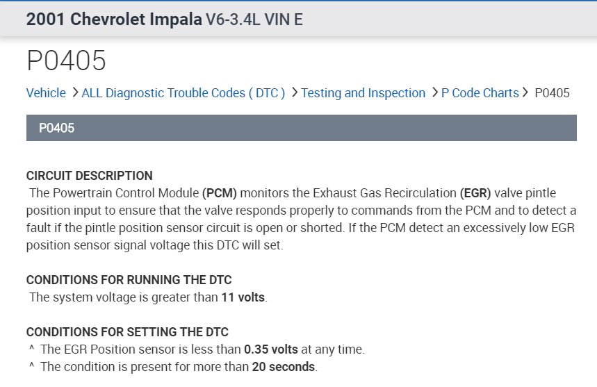

Also, I have some new DTC's as well as some old ones. p0401, p0403 (EGR control circuit), p0405 (EGR sensor "A" circuit low), p0440 (evap control system), and p1404.
It's likely that I pulled the EGR wire harness with key on since the last time I've cleared the codes which could have triggered the 403 and 405 codes. The hose from the PCV valve to the evap solenoid was in bad shape so that probably had something to do with the p0440.
As for the p1404 I'm not sure why that one came up. It seems relevant but with the other 4 codes I'm concerned it may be a false positive. I plan on clearing the codes tomorrow, doing more tests, and driving it around for a bit to see what comes back.

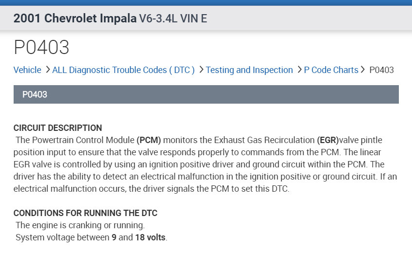

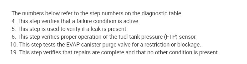

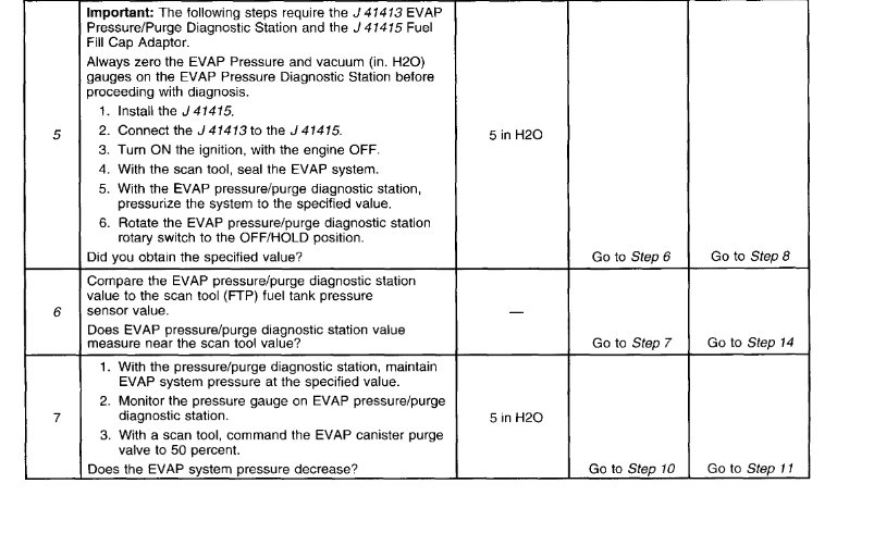

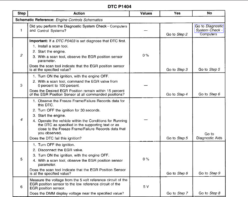

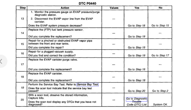

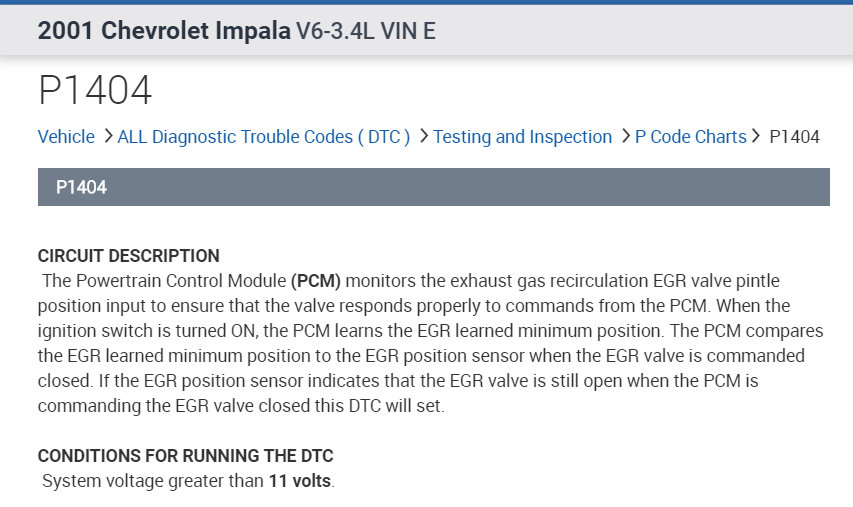

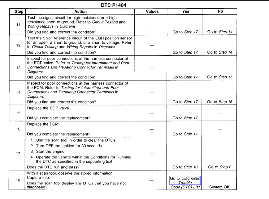

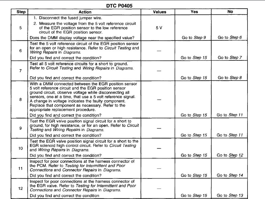

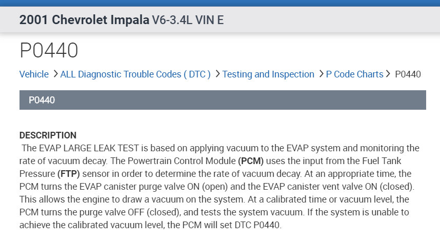

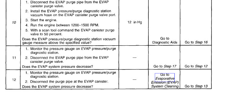

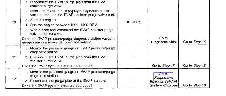

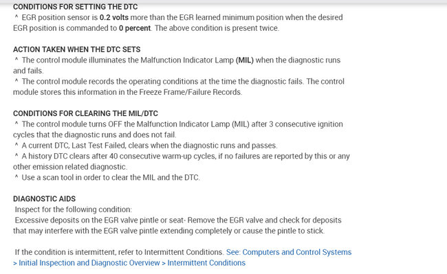

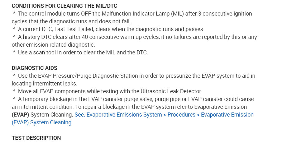

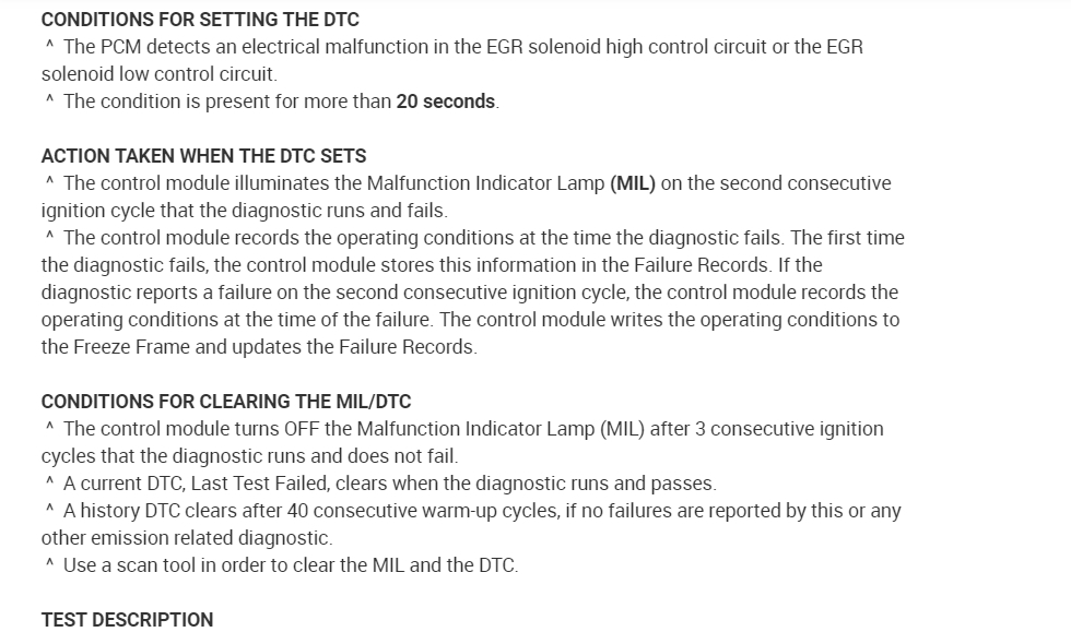

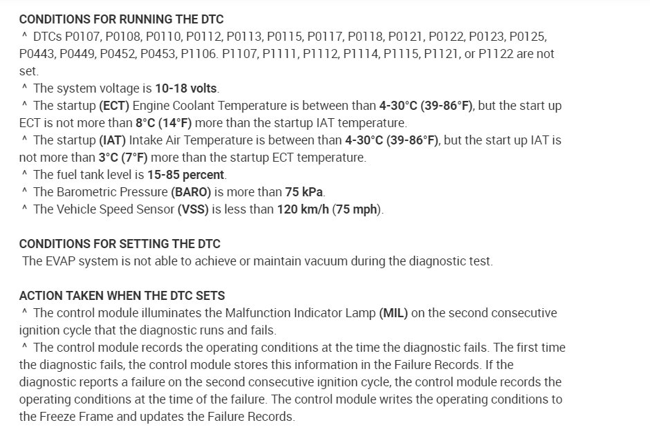

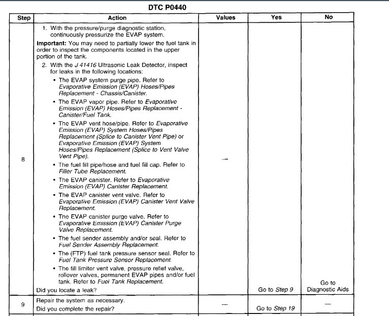

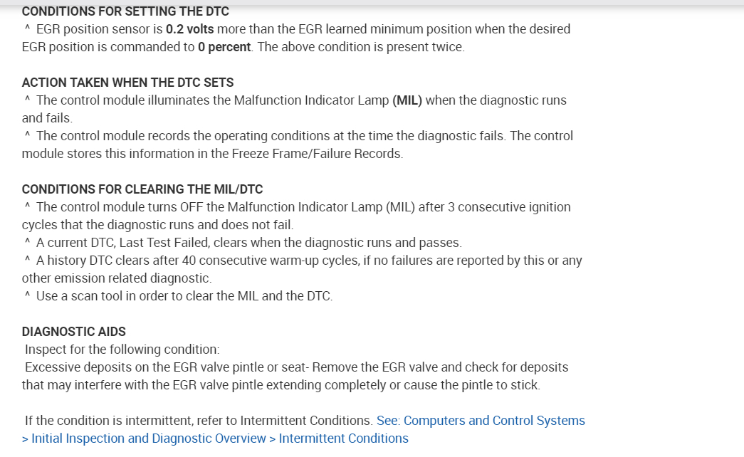

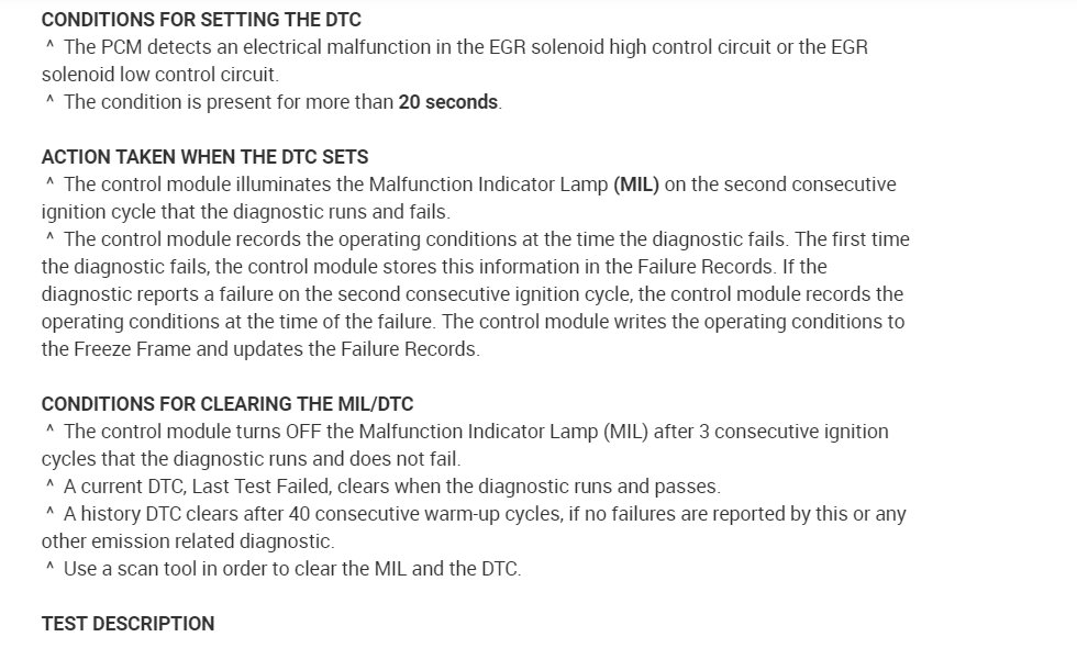

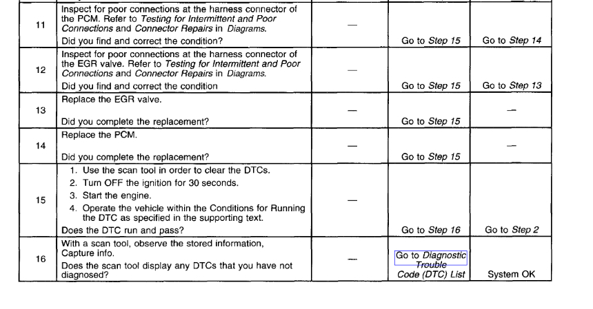

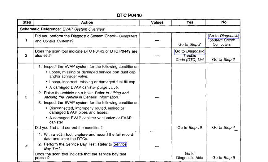

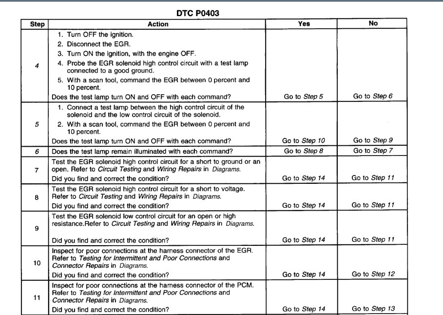

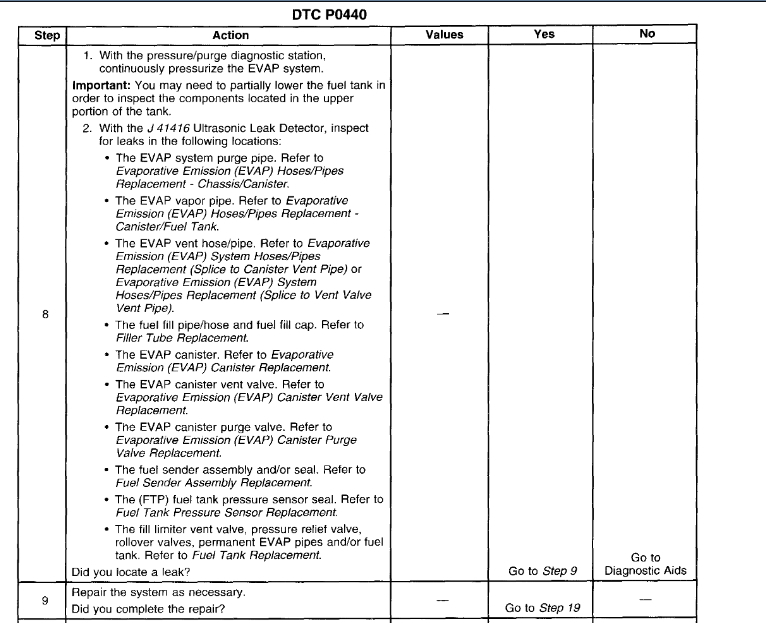

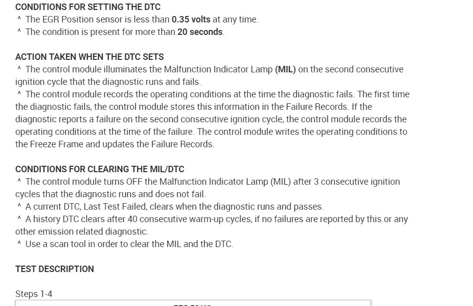

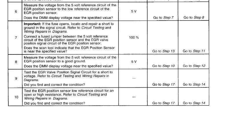

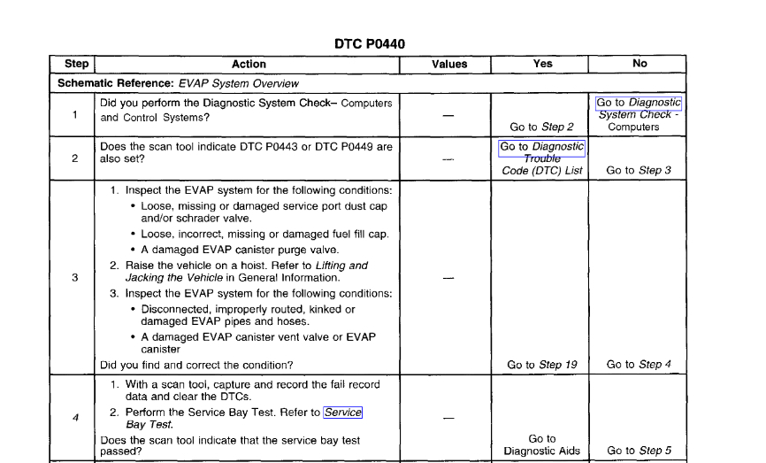

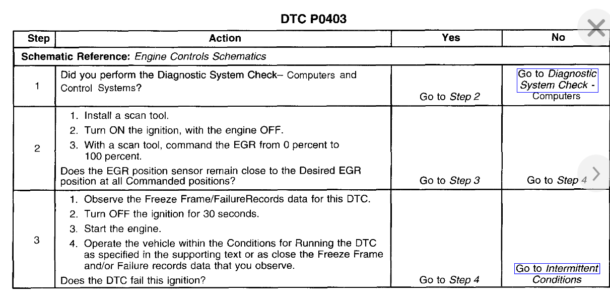

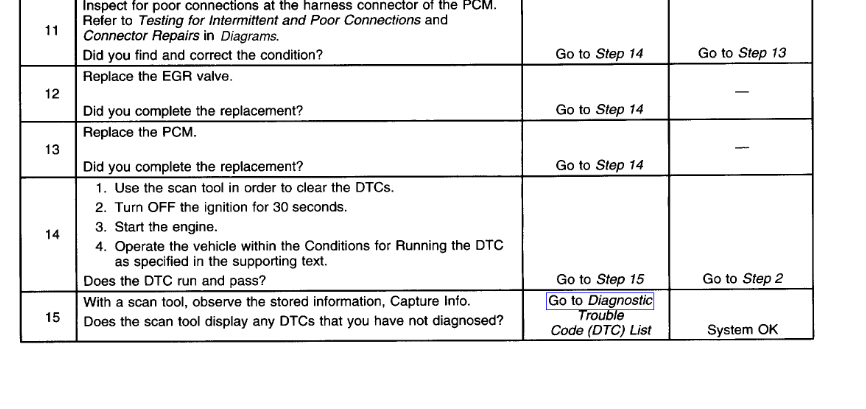

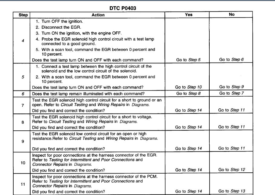

Sorry for the delay. In the diagrams down below I have included the factory diagnostic troubleshooting guides for DTC's P0403, P0405, P0440, and P1404. Please go through them and get back to us with what you are able to find out.
Thanks,
Alex
