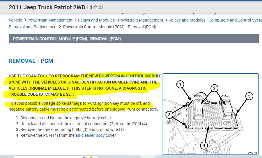

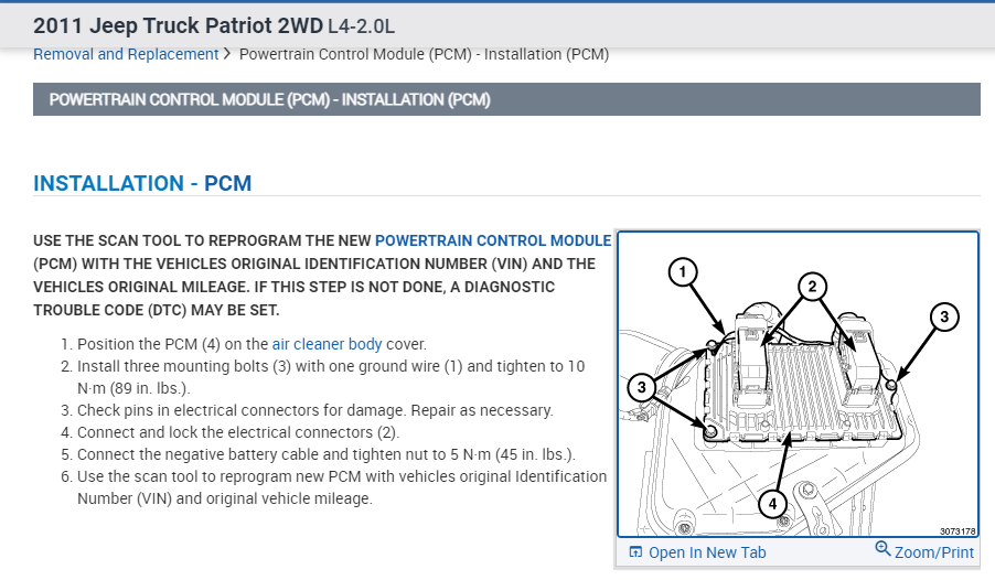

I am attempting to replace my PCM/ECM/ECU myself and I am having difficulty with the location of the module. Any idea where I can find it? I can supply the VIN if that helps.
