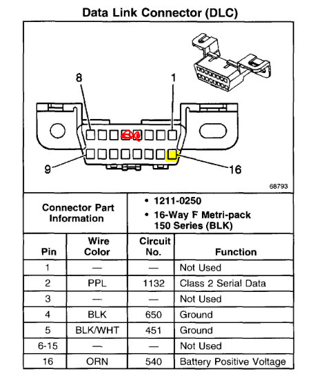

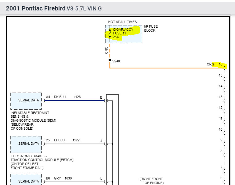

So, here is where we need to start. First, why doesn't the scan tool connect? If you look at the pic below, check pin 16 (highlighted with yellow) for B+ voltage. If that is good, confirm pins 4 and 5 have continuity to ground. Note: If there is no continuity, try it with the key in the on position/engine off.

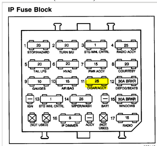

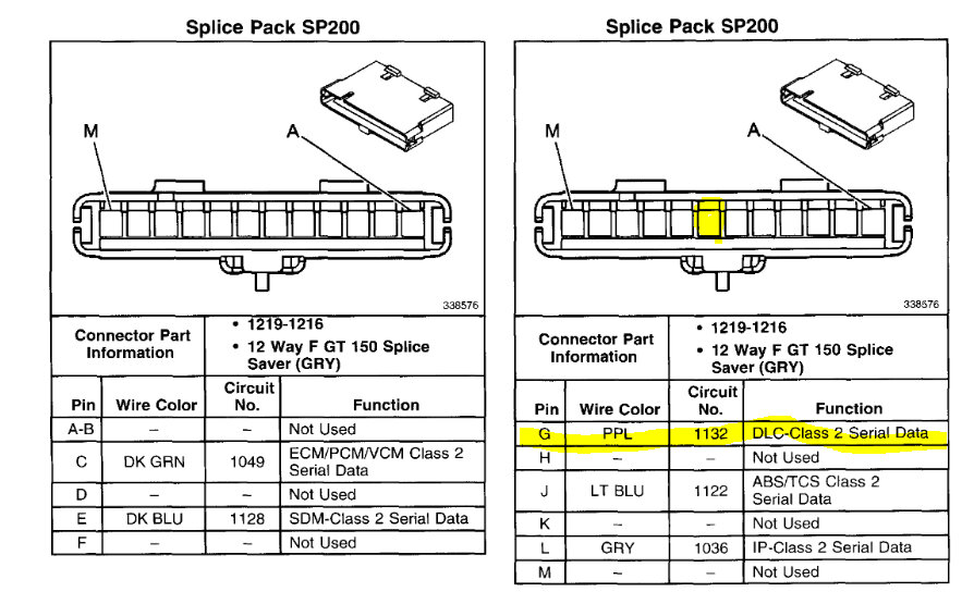

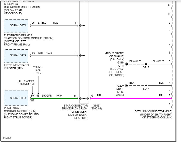

The last two pics are of the computer data lines. Note Fuse 11 in the interior fuse box which is for the cigarette lighter as well as powering pin 16 on the DLC, needs to be checked (see last pic for location). In addition to checking the fuse, make sure there is power to and from it.

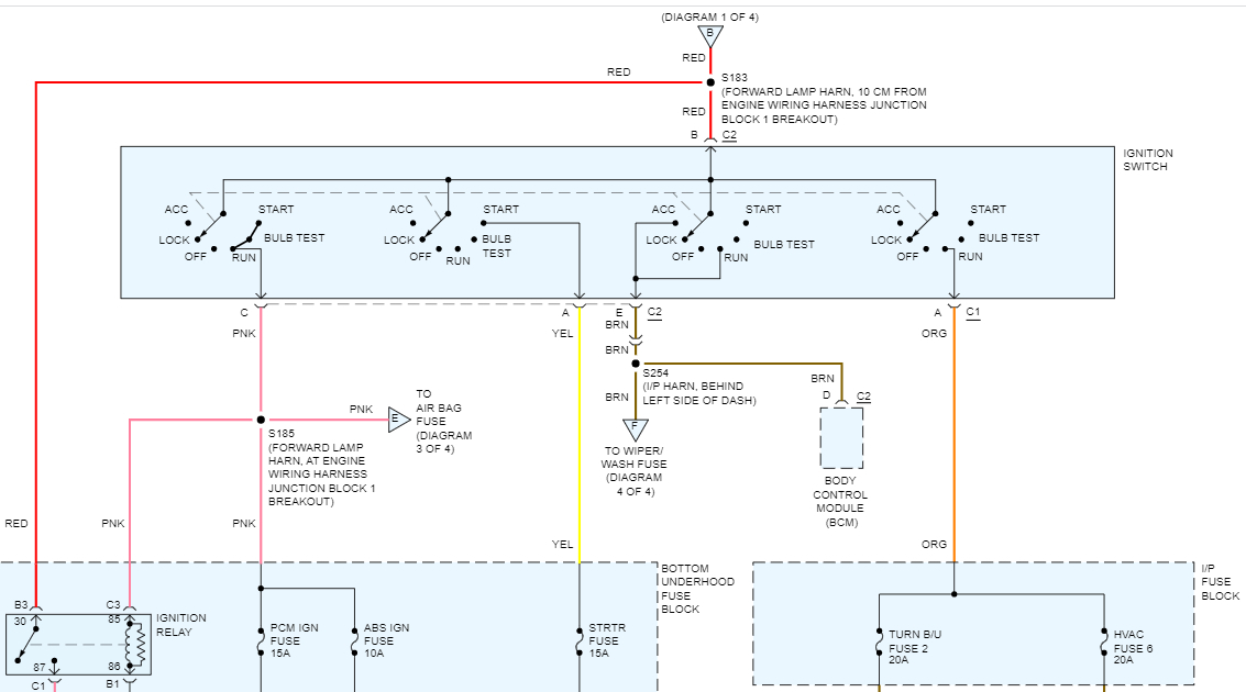

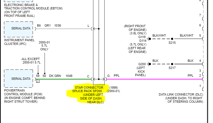

One of the wires from the ignition switch is orange. When you have the key in the run position, it sends power to fuses in the IP fuse box. I attached a pic below so you can reference what I am saying.

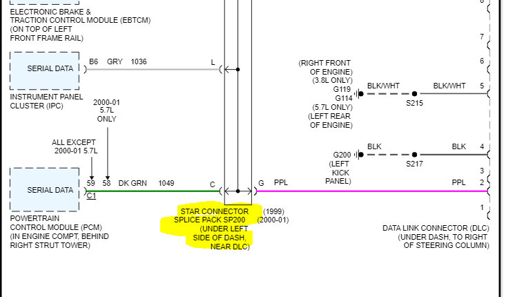

The purple wire goes to a splice pack under the dash on the left side which ties with the PCM. See pic 2 below.
See pics below.
