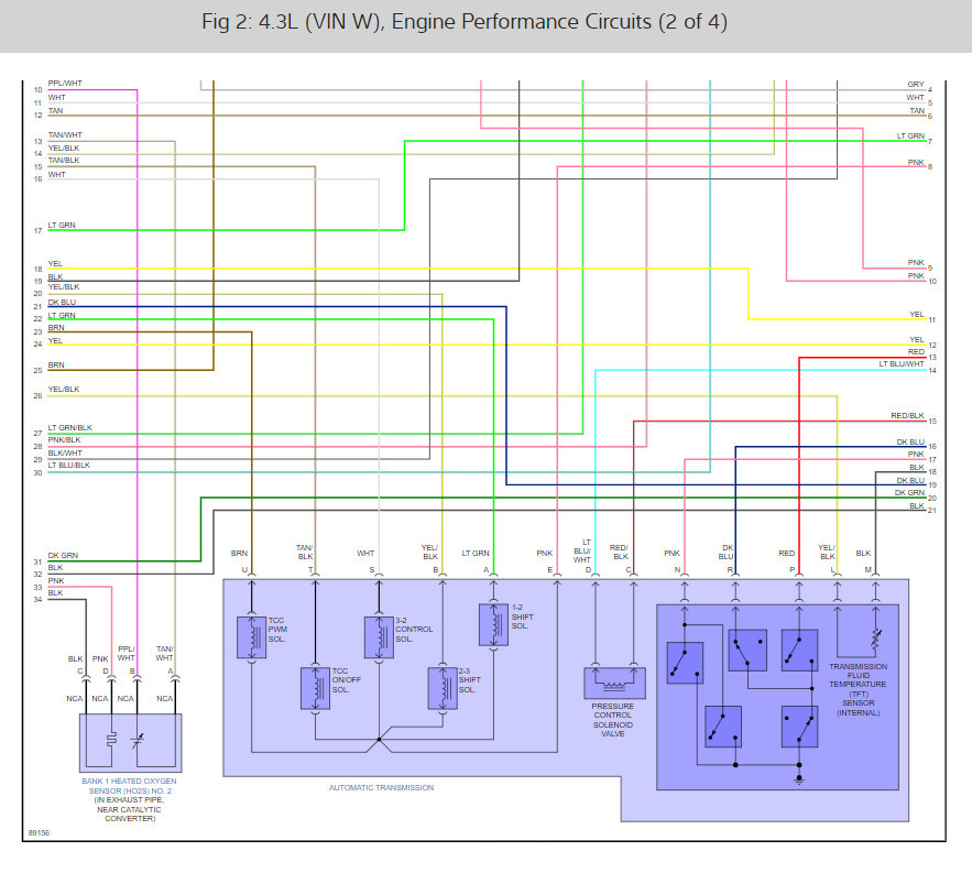

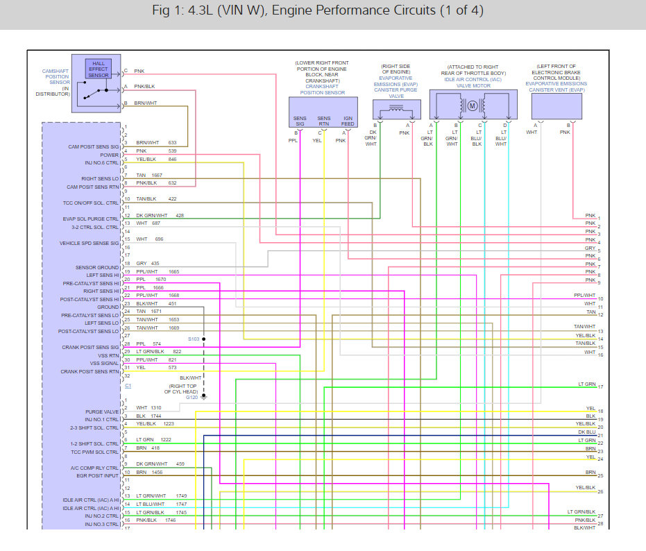

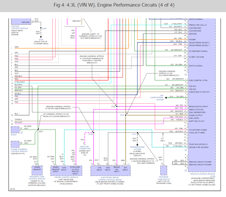

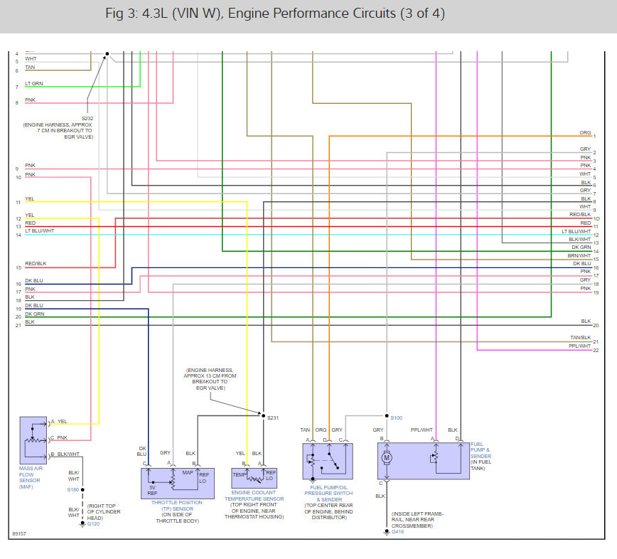

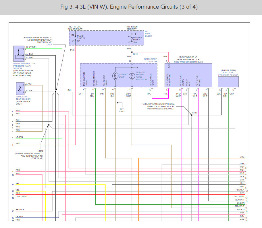

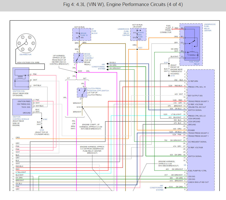

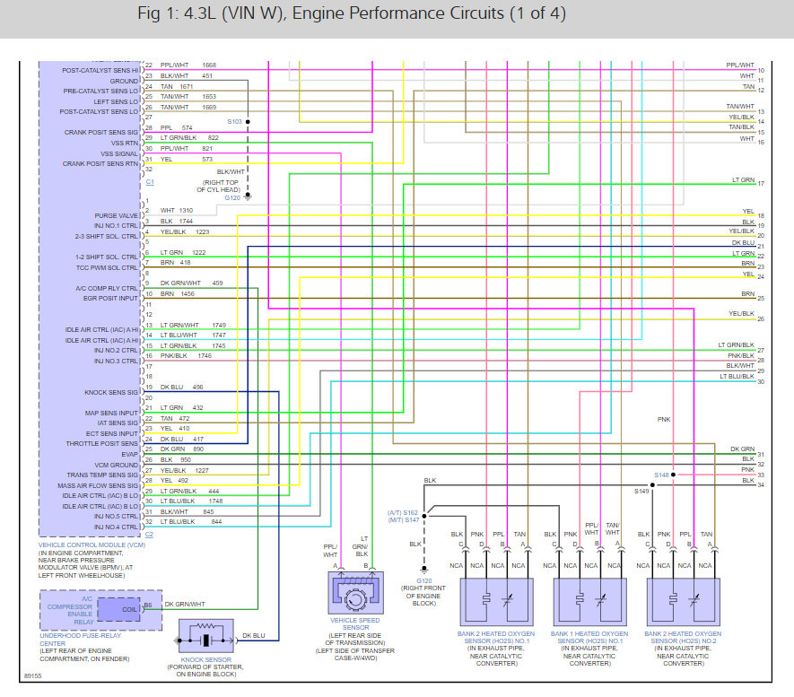

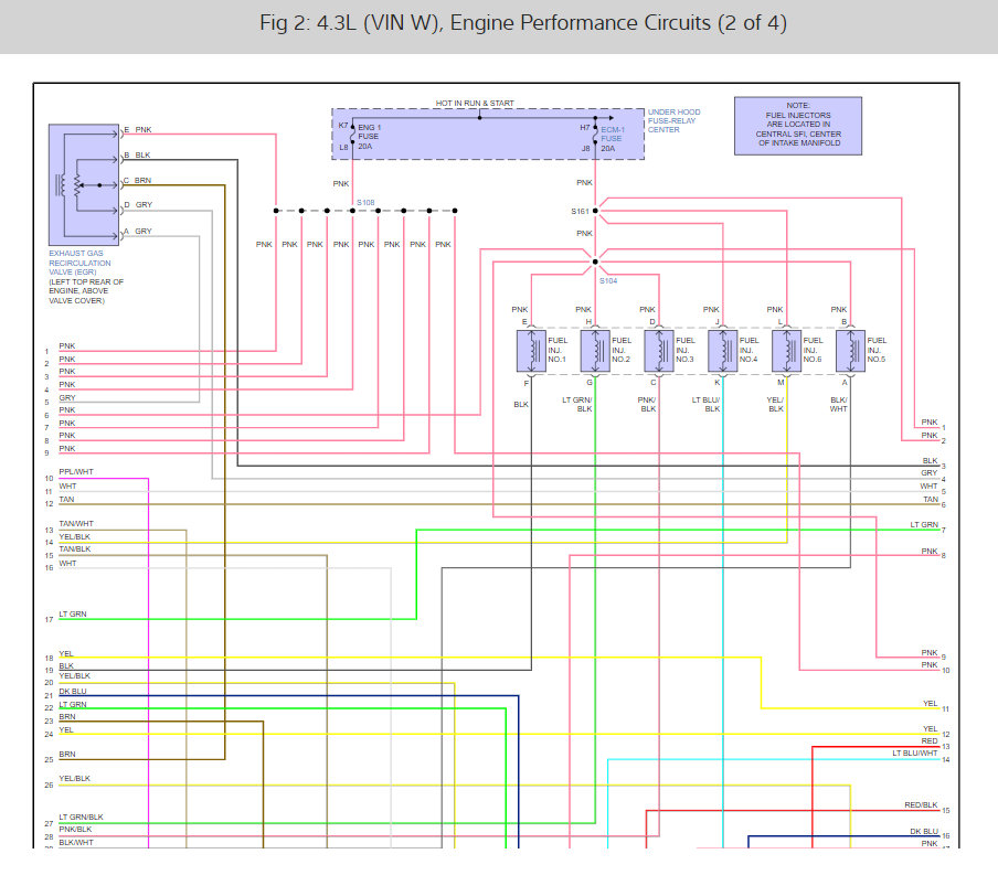

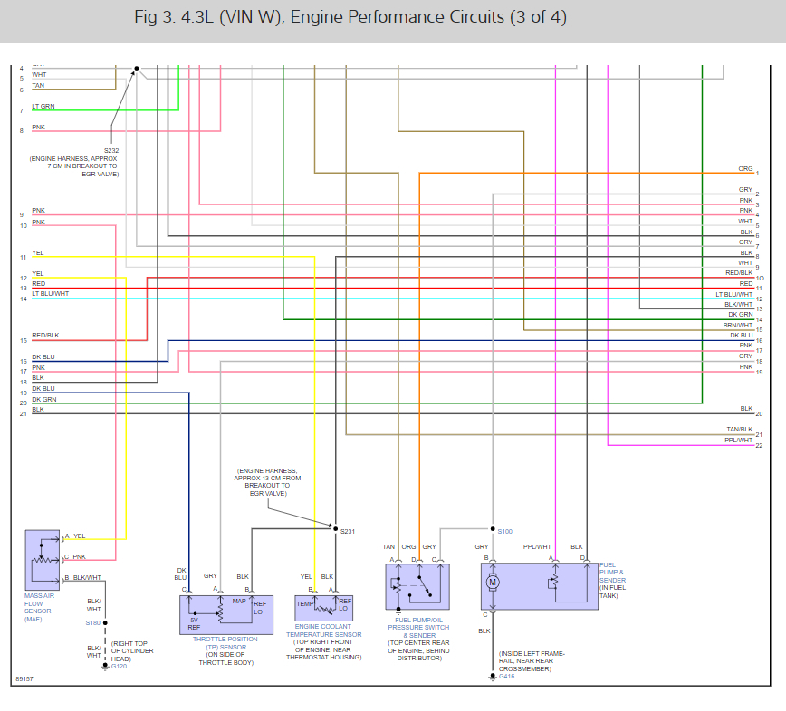

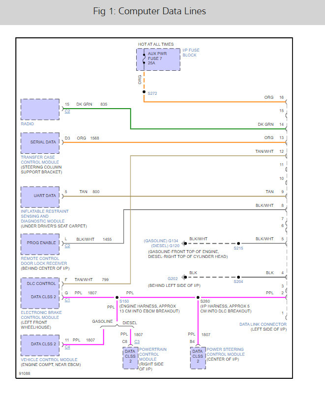

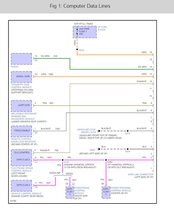

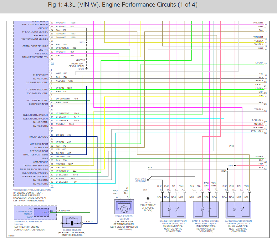

Does the scanner work in another car? If so, let's check the AUX fuse #7 in the interior fuse panel, here are the wiring diagrams for the ALDL connector and the PCM so you can check the grounds and power leads, they will show you how the system works as well.
