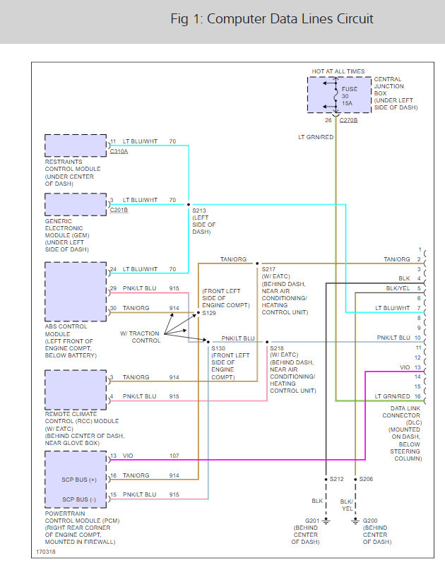

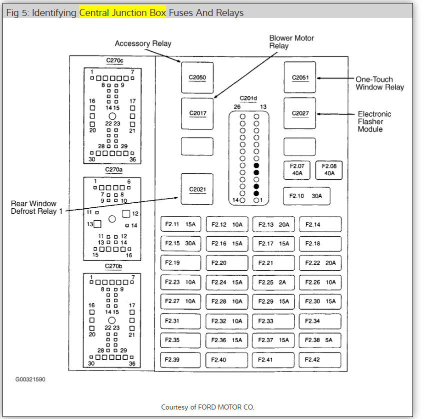

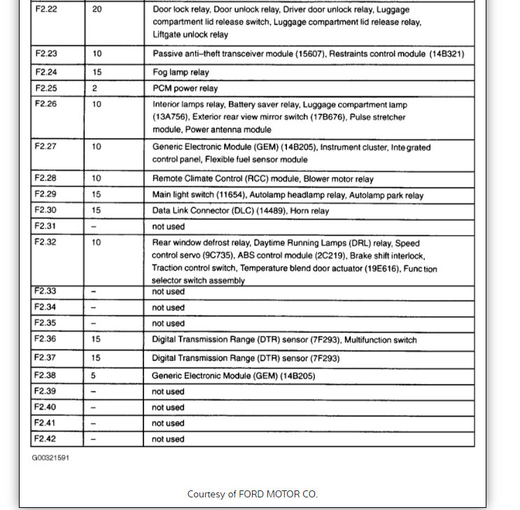

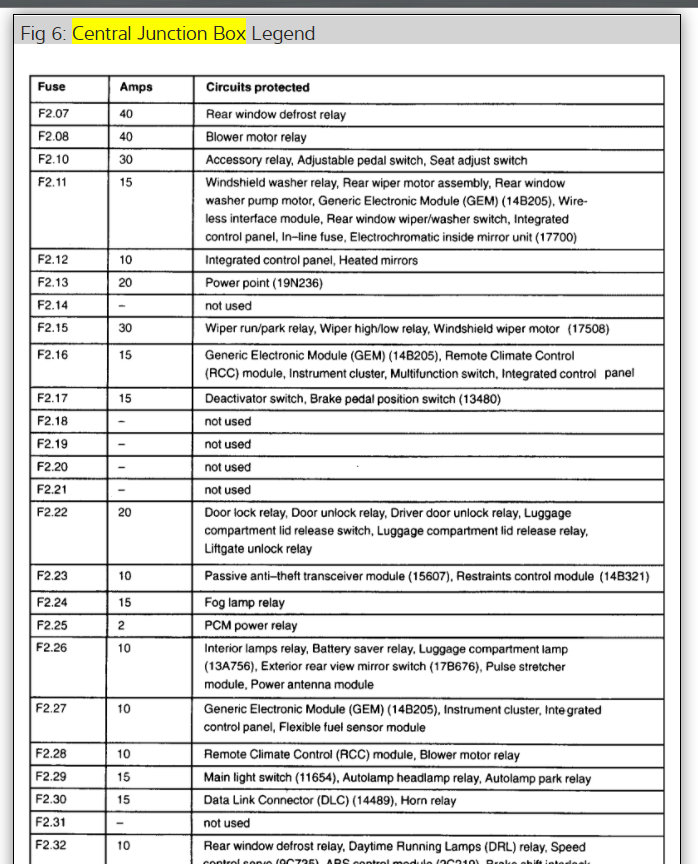

It could be a fuse #f30 15 amp that is out is why the computer will not communicate. Here is the wiring diagrams so you can see how it works and the fuse location along with a guide to help you test it:
If the fuse is okay try a used PCM first you can get them cheap.
Check out the diagrams (below). Please let us know what you find.
