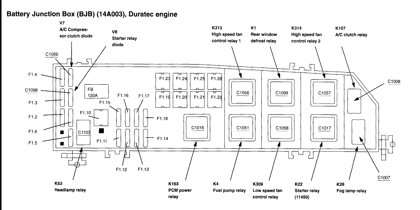

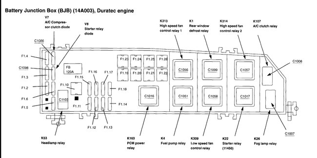

Also, check the starter relay, you should feel and hear it actuate when the key is turned to start. Check that in both park and neutral as it is possible the TANS position sensor (neutral switch) is stopping it from starting as well.
