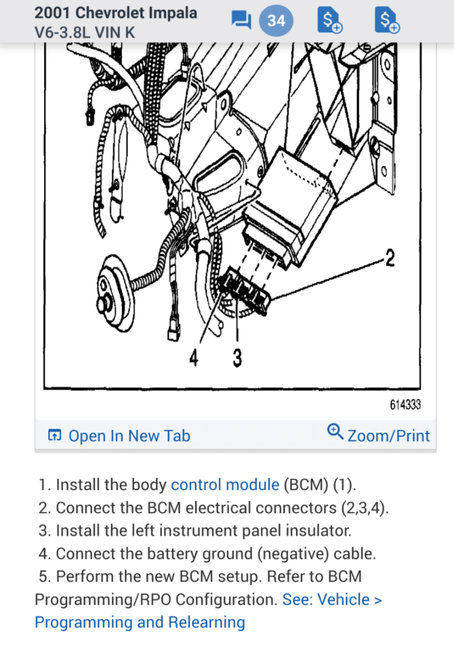

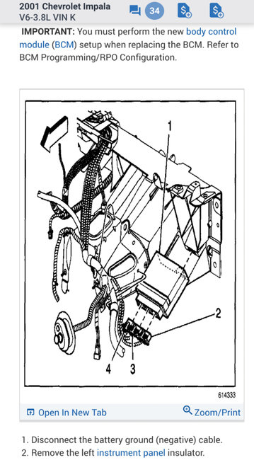

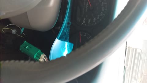

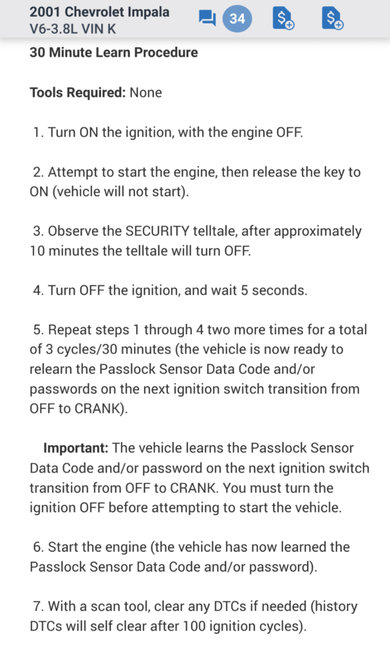

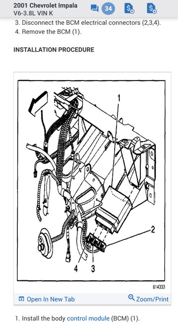

Bought this car from a used lot about a year ago and it worked fine for around 3/4ths of a year and has been sitting not working in my driveway since. I did some looking and it seemed that the biggest culprit was the "pass lock" system. I decided to replace the ignition switch and after that did not work I installed The bypass resistor thing with no luck. After this didn't work I looked more on YouTube and tried multiple different ideas like, resetting the alarm on the radio, messing with fuses, and such. I have tried to make it relearn the key multiple times throughout all of the fixes with no luck.
